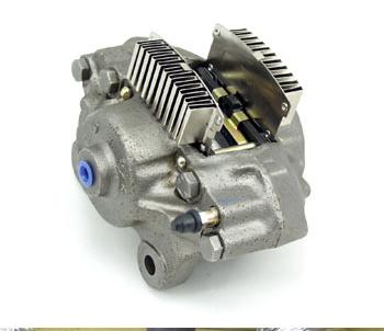

We using a titanium backing plate on our cars because pads and backing plates are free. Now our backing plate isn't just any old backing plate......it has cooling fins on it. Below is a picture of the exact setup. The Ti insulator protects the piston. And sandwiched between the piston and Ti plate is an extremely conductive piece of copper / ? metal that forms the heat sink.
Sort of stretches the letter of the law but thus far most other IT competitors have been receptive. While it is true that you can't use an allowed piece to perform a disallowed function, nowhere is it said that cooling your brakes is a disallowed function.

Don't know if you use a vented rotor in that application.
I bet if you rotated those backing plates 180 deg. the cooling air from the rotor would pass through those fins, providing even more heat transfer.
Also using the paste that was used under a GM style HEI module would promote further heat transfer.
S
I like the backer plate idea, but the fins on yours should be at an angle or 90 degees off from where they are right now. As it is, you're not promoting airflow through those fins because they are blocked off by the caliper itself..
