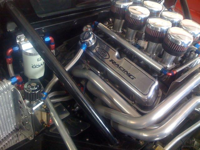

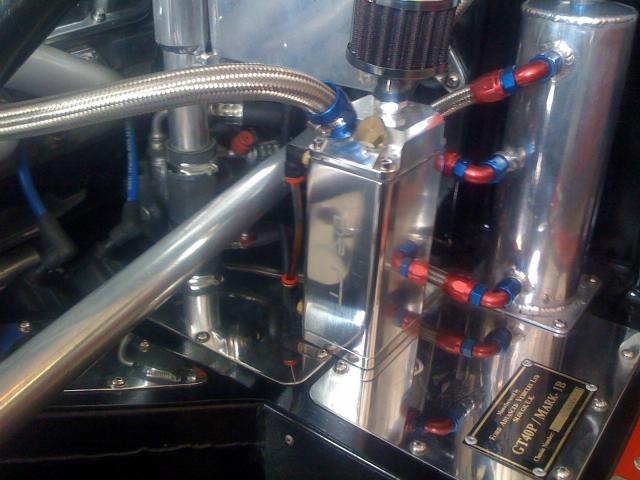

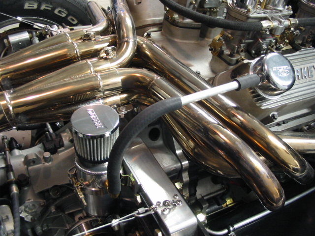

Here's another breather\puke tank.

Very nice. Seperate breather tank for each valve cover.
Who do you use to polish you headers? I assume they are polished stainless?
Please forgive me but this subject is new to me and i need to understand it so i plumb mine in the best/most suitable way.
There apears to be 2 camps, PCV and non-PCV
  • non-pcv, from the pictures it looks like you pipe from both valve covers to a catch/puke tank. This then vent to atmosphere via a filter above the inlets and has a drain tap for emptying as and when needed. Catch tank is a UK track requirement and maybe elsewhere as well. This setup suits multi-carb configs and single carb setups.
  • PCV solution, filter installed in one valve cover and PCV valve installed into other valve cover with pipe connecting to intake manifold, thus under load and high vac, atmospheric air drawn in to engine via filter and engine vapours drawn through PCV and onto intake manifold for them to be 'burnt off'. More suited to single carb setups as better vacum source.
Both must work or people wouldn't be split between them. Is it a case of 'horses for courses'? Th catch tank/non-pcv setup sounds like it provides cleaner internal engines as all nasty vapours are drawn off and collected rather than burnt off and as someone said a good excuse for more shiney metal under the hood.
Sorry if i have hijacked the original thread.:embarassed:

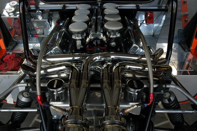

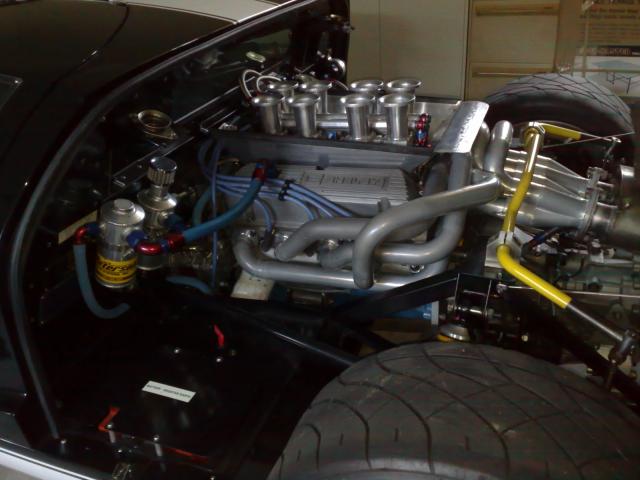

I run a breather each side, both go to puke tanks. See pics.

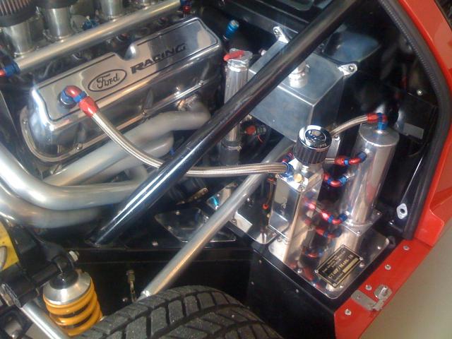

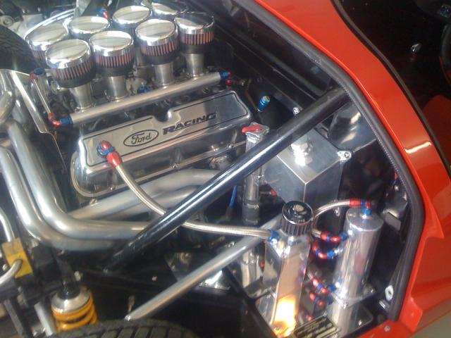

Need an opinion.
Installing a puke tank as per the attached picture. Plan to run a line from the valve cover on the opposite side as well. The tank has a separate fitting on the opposite side. It would be easier to tap the driver side valve cover at the back end, as on the passenger side.
So the question is whether there is any issue about running the vent line from the aft end on both valve covers. Can't see that it would really matter.
The set up in the pic is TEMPORARY, just to get an idea about spacing, etc. The location of the tank, however, is final. We will clean it up the connections . . . .
