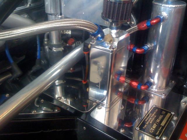

Howard Jones

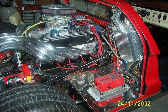

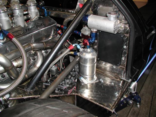

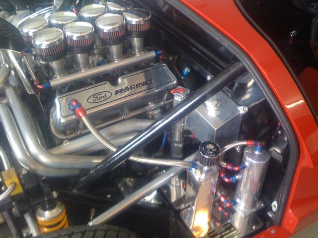

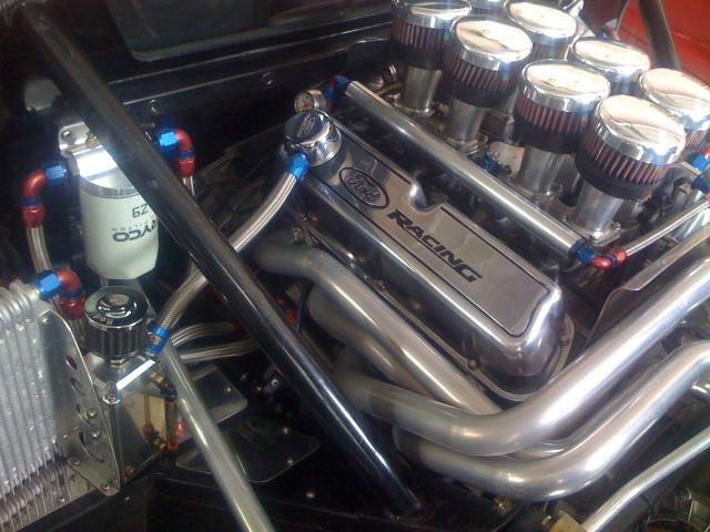

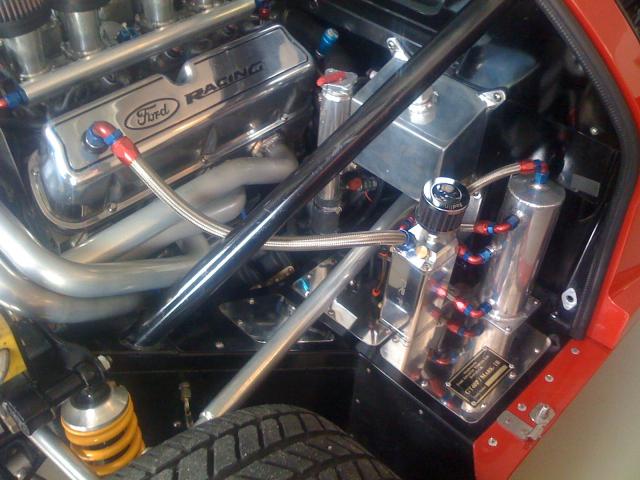

Here's how I did mine. The fitings are AN8. I did this because I knew I would need to vent to a tank if I ran it on track.
It does seam to work. I find it interesting that Jac thinks two AN10's are the way to go. I have noted the AN10 point and as it is said by Jac it shall be done on the SC-C 350 chevy now in progress.

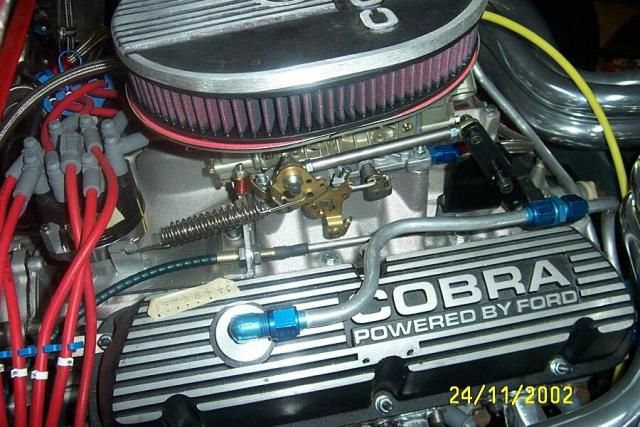

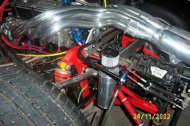

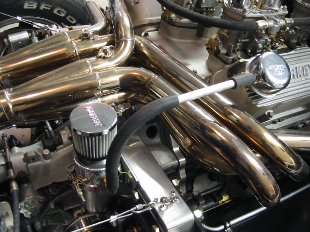

The 351 Windsors have a big vent opening. Mine took a 12 hose. Only running one line to the catch can. I originally wanted to mount the can up front of the engine on the left side, but there was no room for it with the main fuse box and the roll cage. Also the line was so short that I was afraid the rocking of the engine would put a strain on the line, so I went to the right side and ran it to the back. The engines will rock toward the right side so there won't be a strain. Still thinking about adding a stabilizer bar off the right head to the frame. Will decide after the fire up of the engine.
