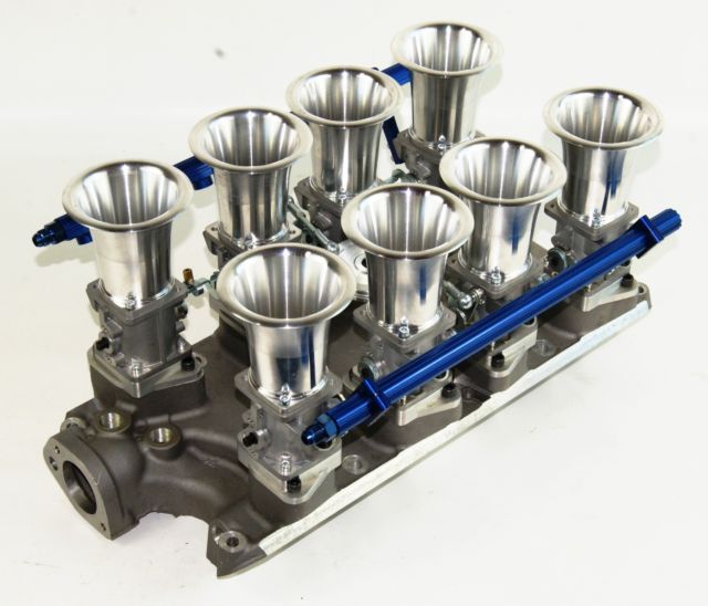

Has anyone used one of these stack systems from Procomp overstock? I have a set in the workshop that are going on a friends 302 and they seem to be very good value for money at $1300.http://www.ebay.co.uk/itm/SBF-DOWND...r_Truck_Parts_Accessories&hash=item27bdfadca8

I am pretty sure its the same sort of thing . The first picture`s are of the one we have here .Here is a birds eye view of the cross shaft for the throttle linkage.
Edit, I have just had a quick look at the ports, other than an hours or so`s work to clean up the casting flash and port match they are in pretty good shape.

I think that was / is the same intake Tom was about to try with IDA's on his car, hard to 'see' how large the drillings are into the plenum & the position of those drillings to determine whether they might help overcome the restriction imposed by the IDA's on a non-plenum individual runner setup. Toms car still had 4bbl fitted at time of accident so dont think he had tried that setup yet.

I can see it has brass shafts and they look the same.

The last pic has 8 separate bodies not 4 lots of 2.
If I where you I would just fit them and see if the problem occurs but at least you are aware and you wont waist hours like I did trying to sort it.
If this is a paying job be very clear that the fit up maybe the easy part and charge for every hour if it becomes a pain.

He was sold these as a pro comp set up Jim so god know where they originate from, They could be an older model , I will take your info on board and check out the shutting of the butterflies before I fit them. There is no makers name or any numbers cast into them which is odd.
Bob
I got the ebay set at home.....thereare a few problems with it. The supplied fuel hoses and rail fittings are dodgey. The mainfold is a bit suss as the drilled holes dont seem in line. I cant see any problems with the throttle bodies, think they are motor bike items.
