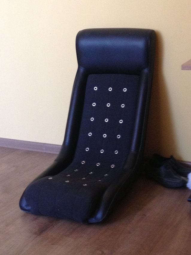

Added seat! Since the dimensions of the original seats and failed to get a standard sports seats.

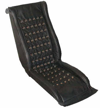

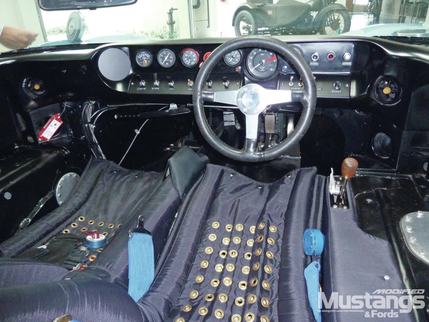

Hi Boris, the original GT40 seats were much different. More like a cover over a metal frame (see pic). I can get some custom built seats lijke you can see at the pic- all I know right now is they are about 45cm wide, but I decided to go with Porsche 914 seats.

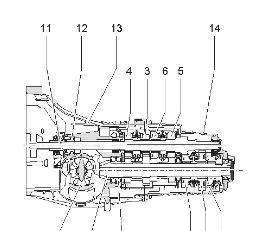

Here is also some information about the audi gearbox. When I have one I will send you more concrete details.

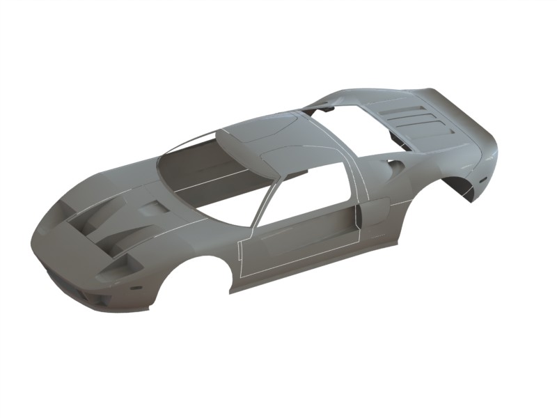

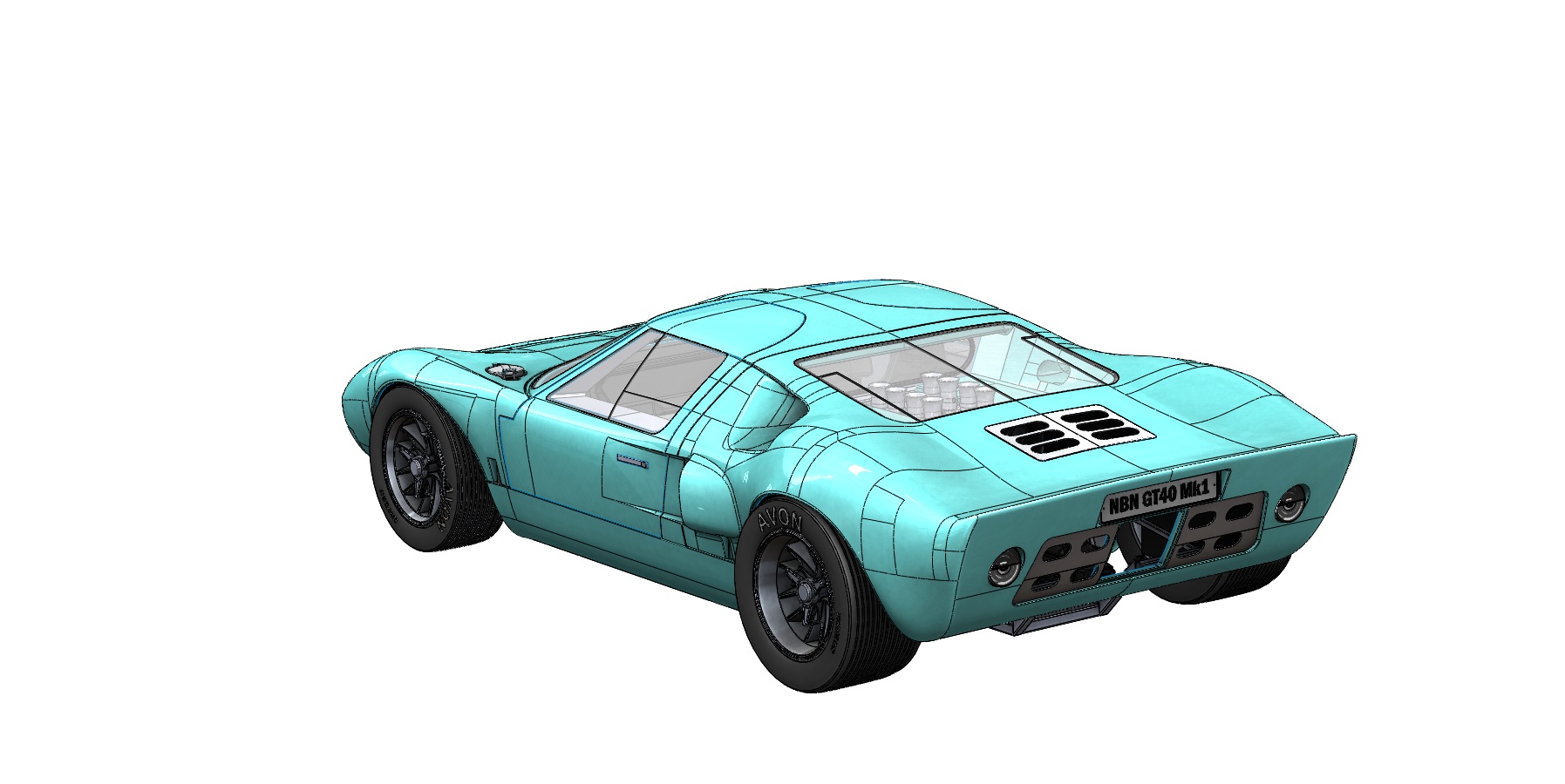

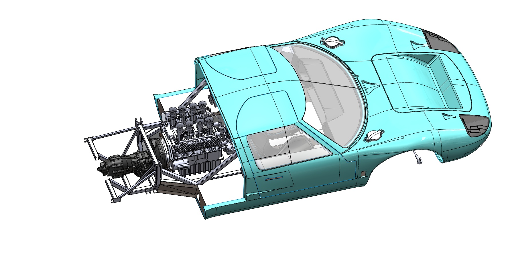

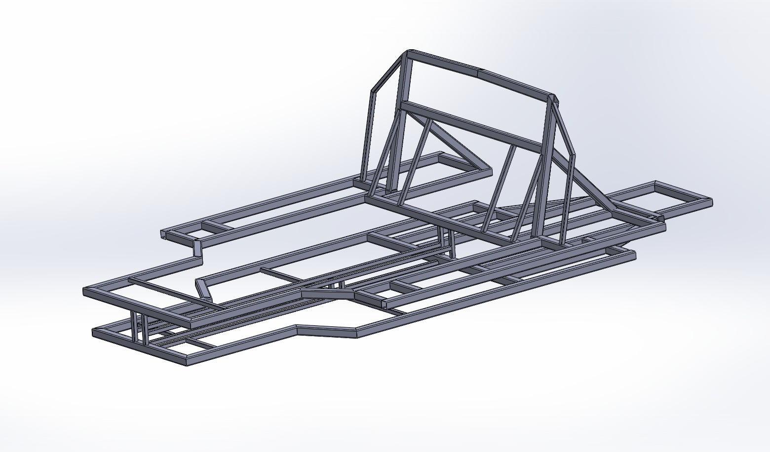

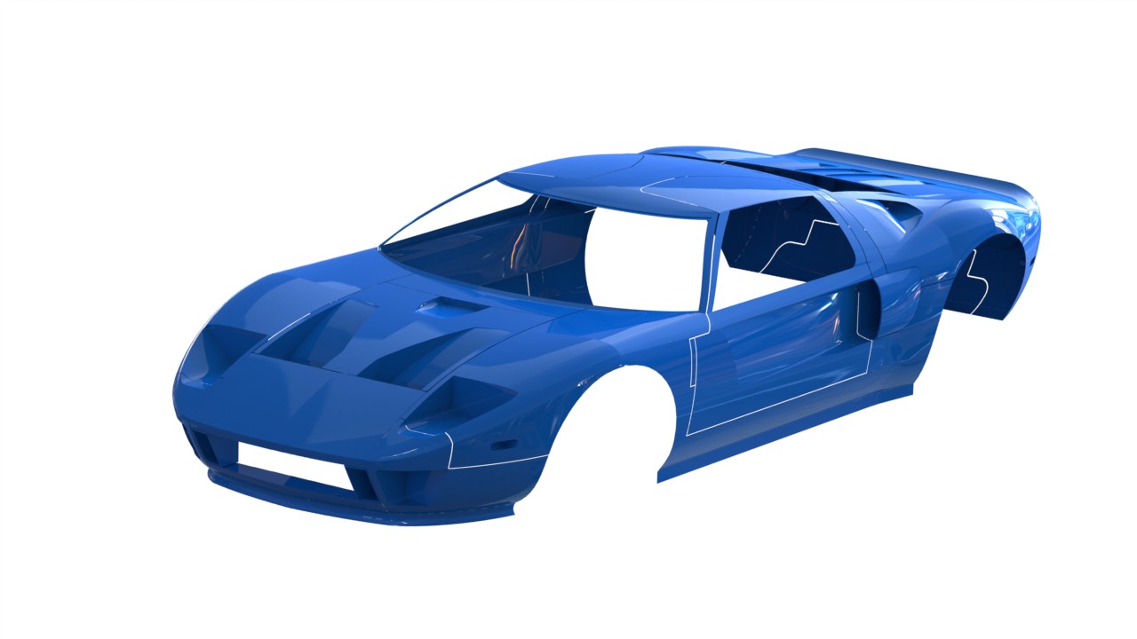

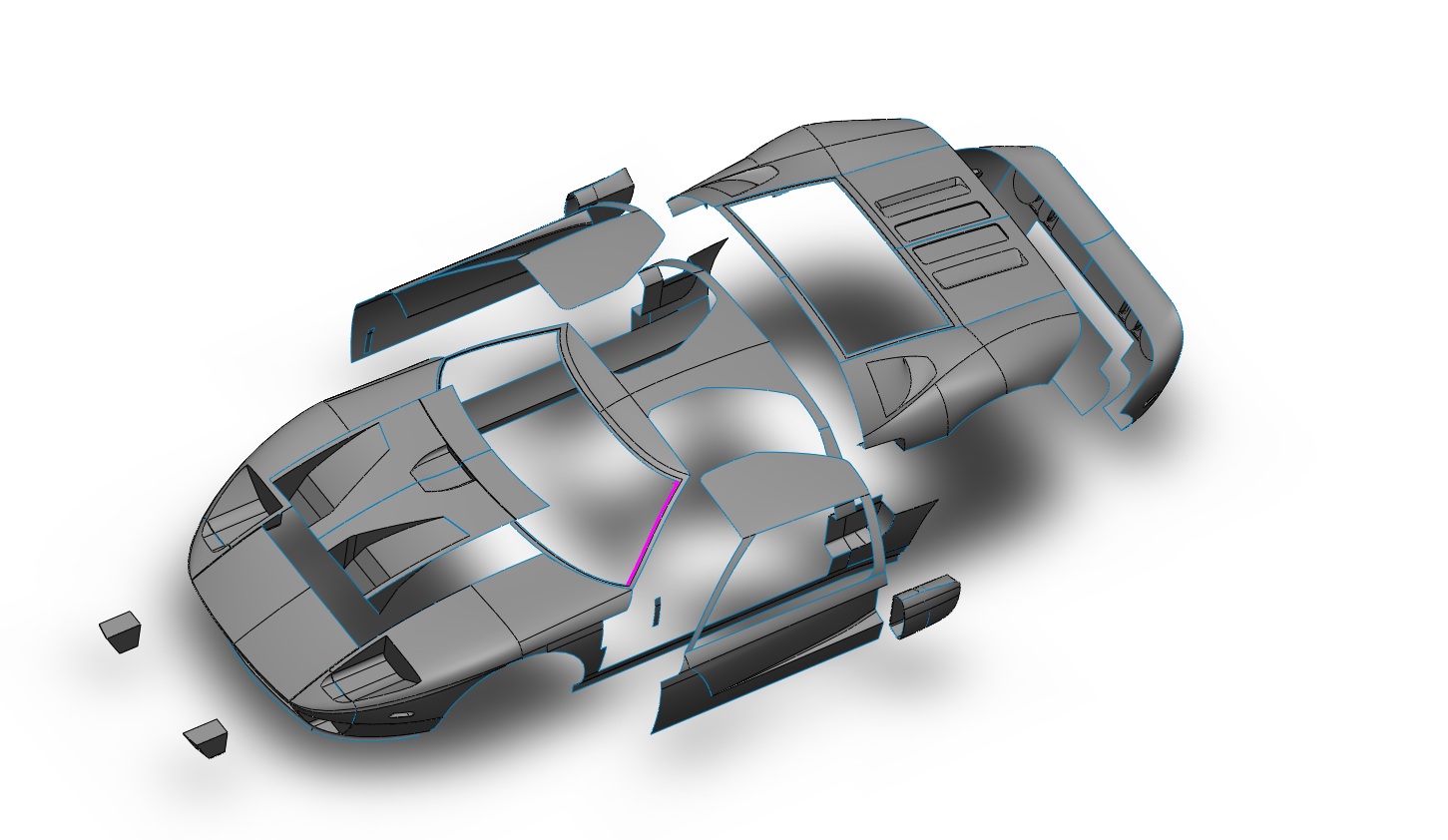

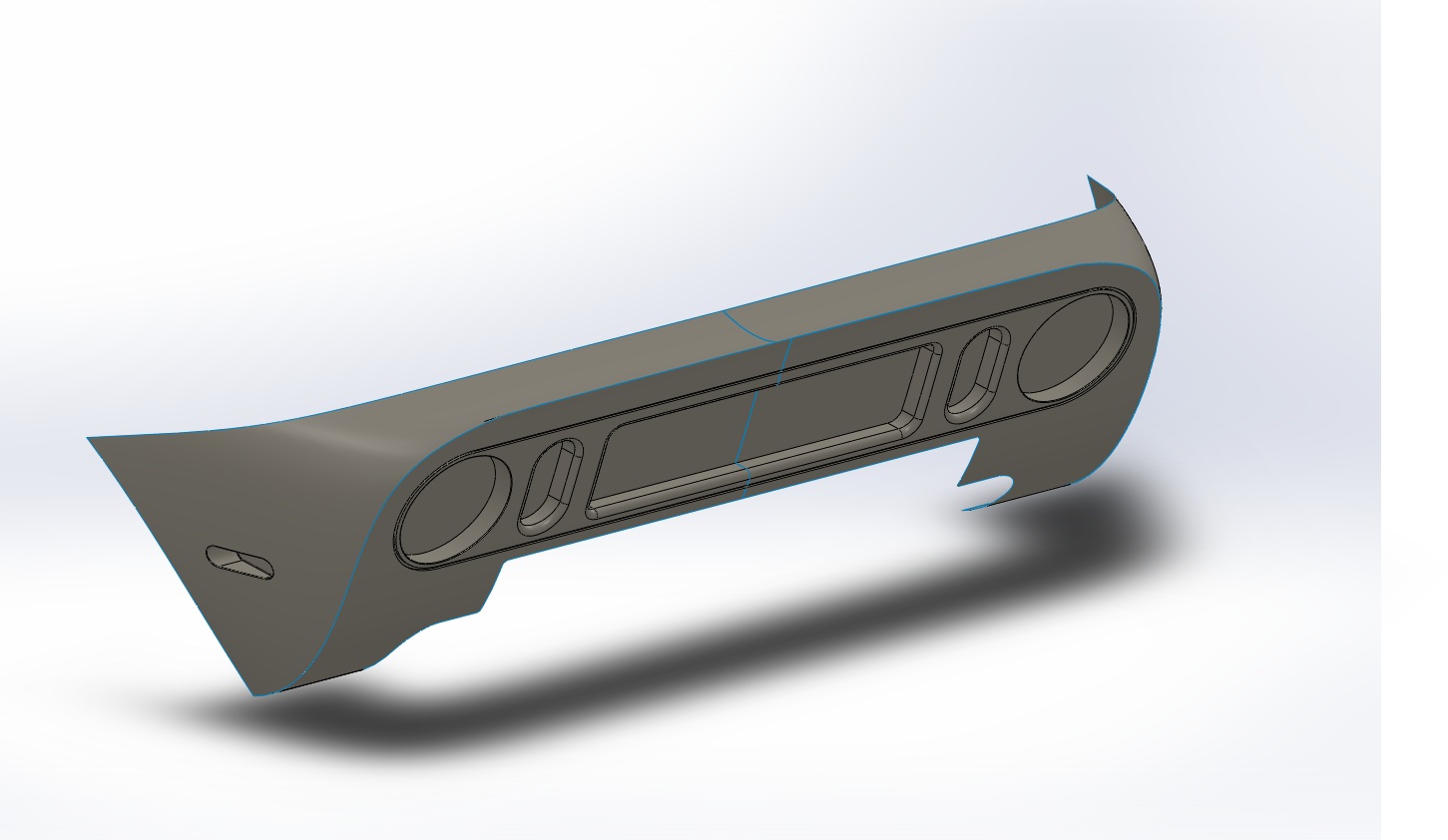

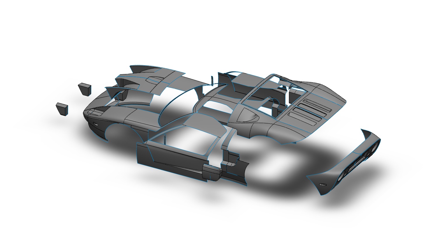

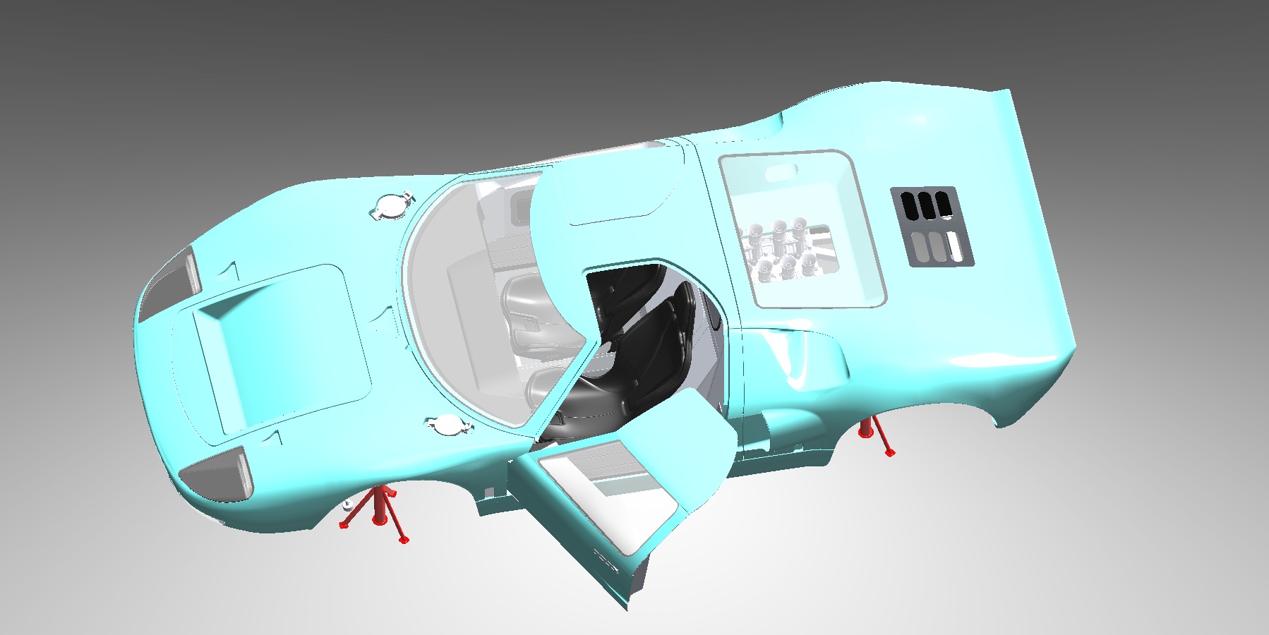

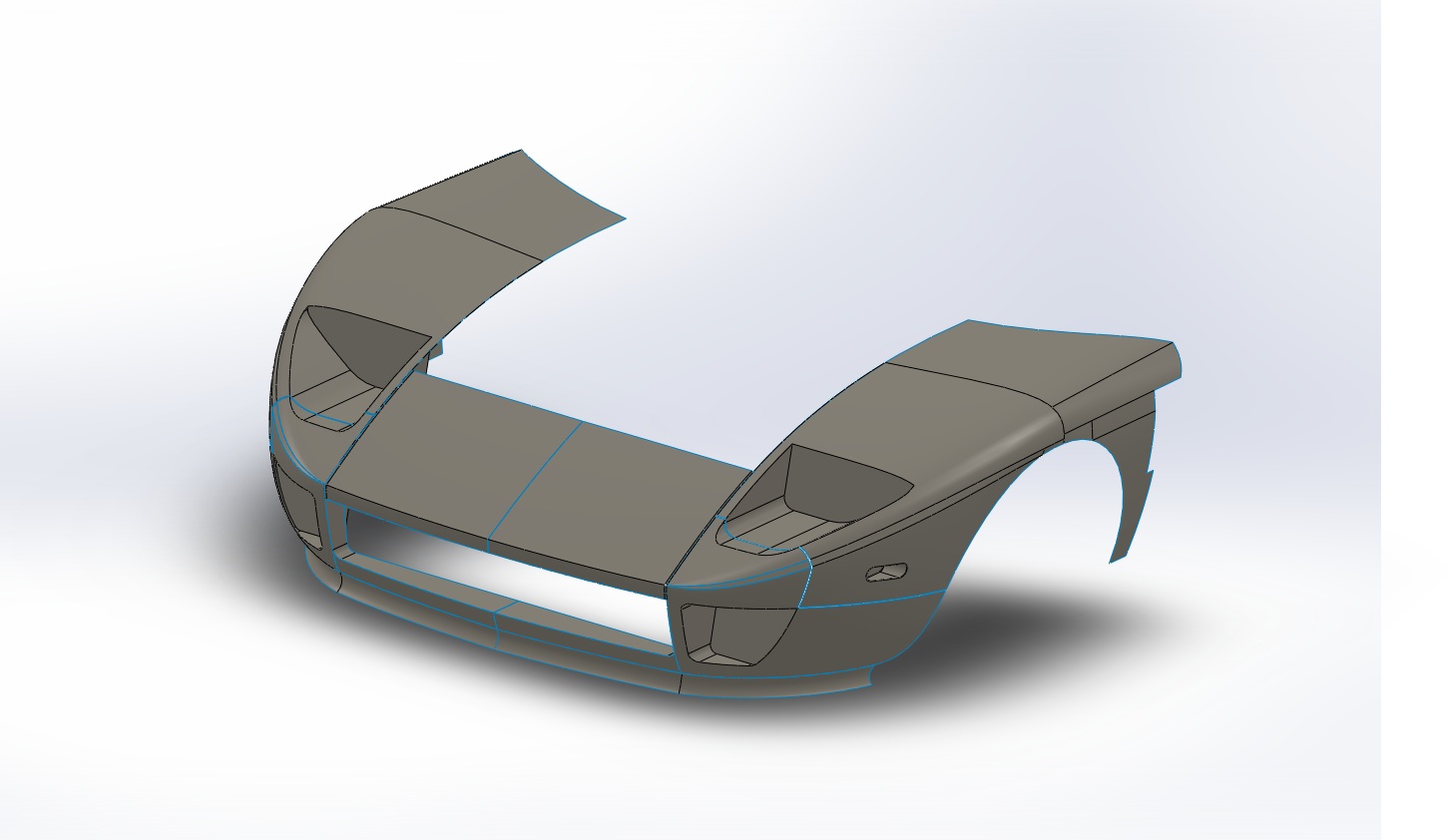

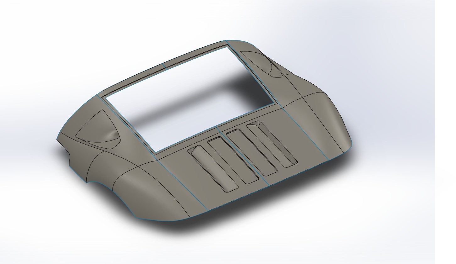

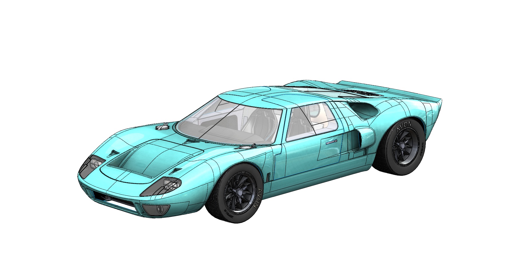

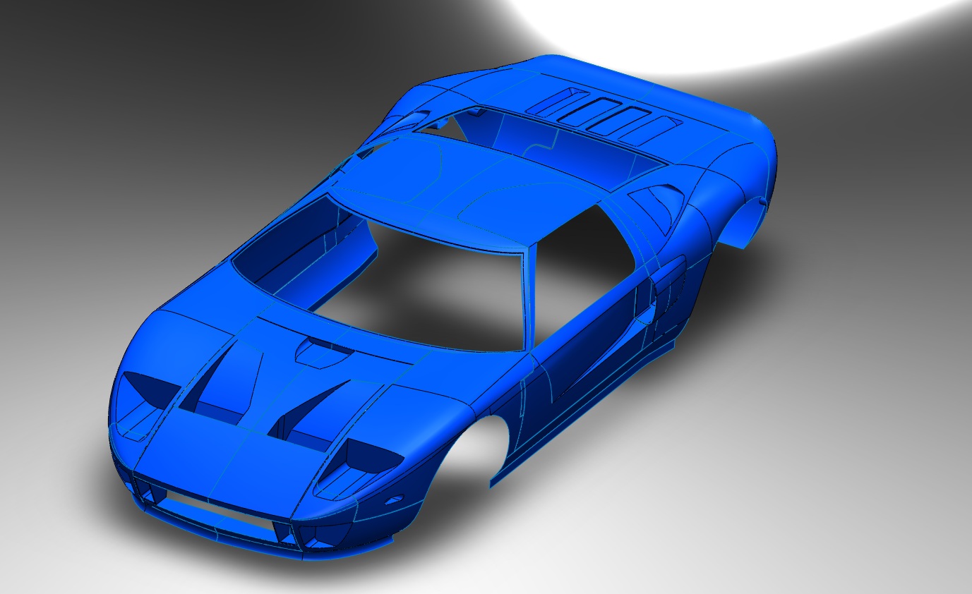

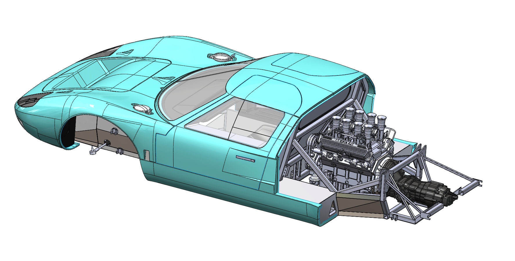

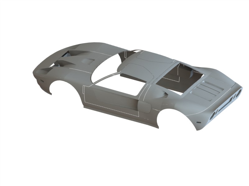

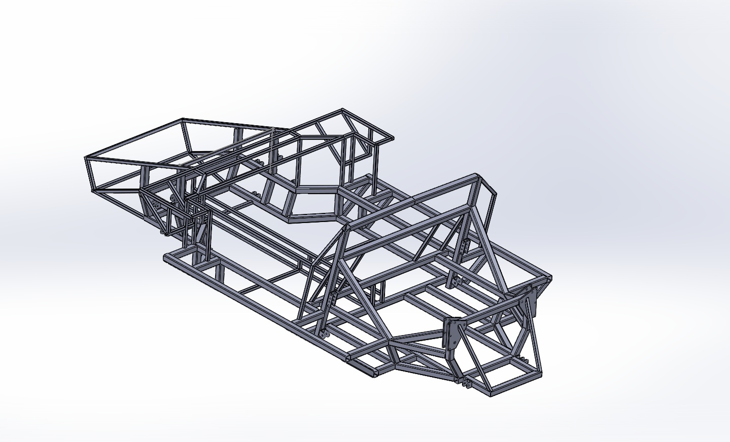

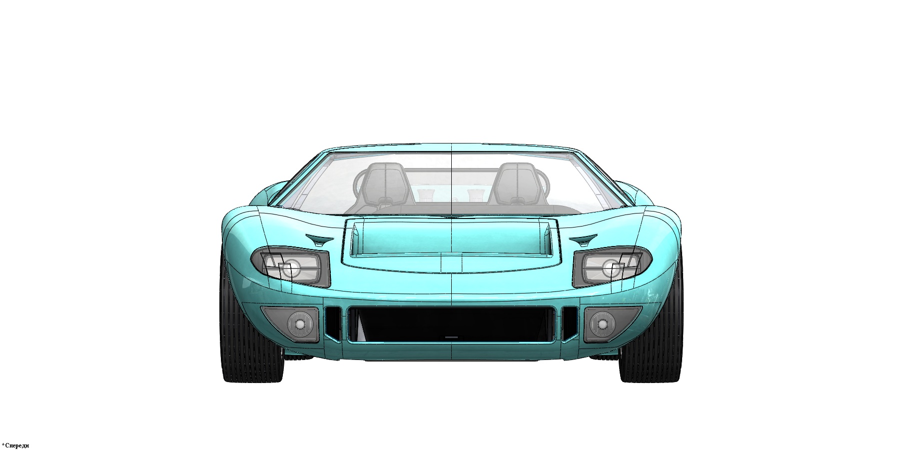

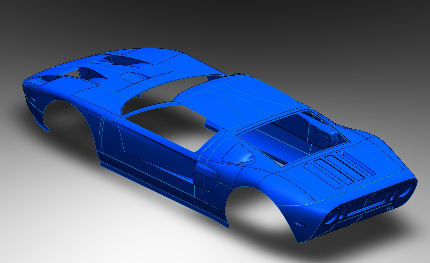

A couple of years ago, I modeled the body Ford GT. Here's what came out of it ...

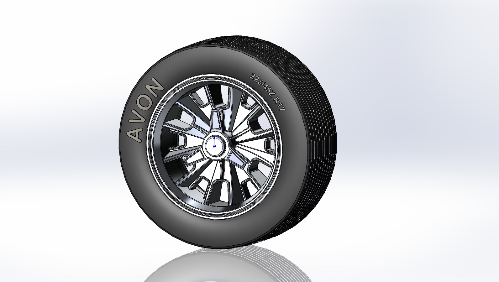

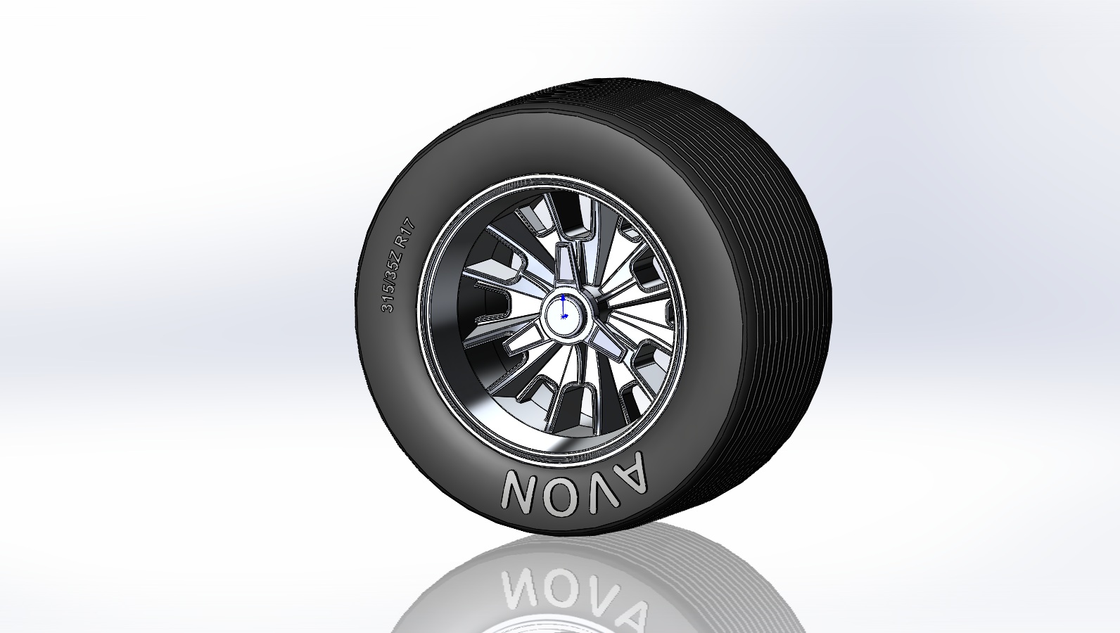

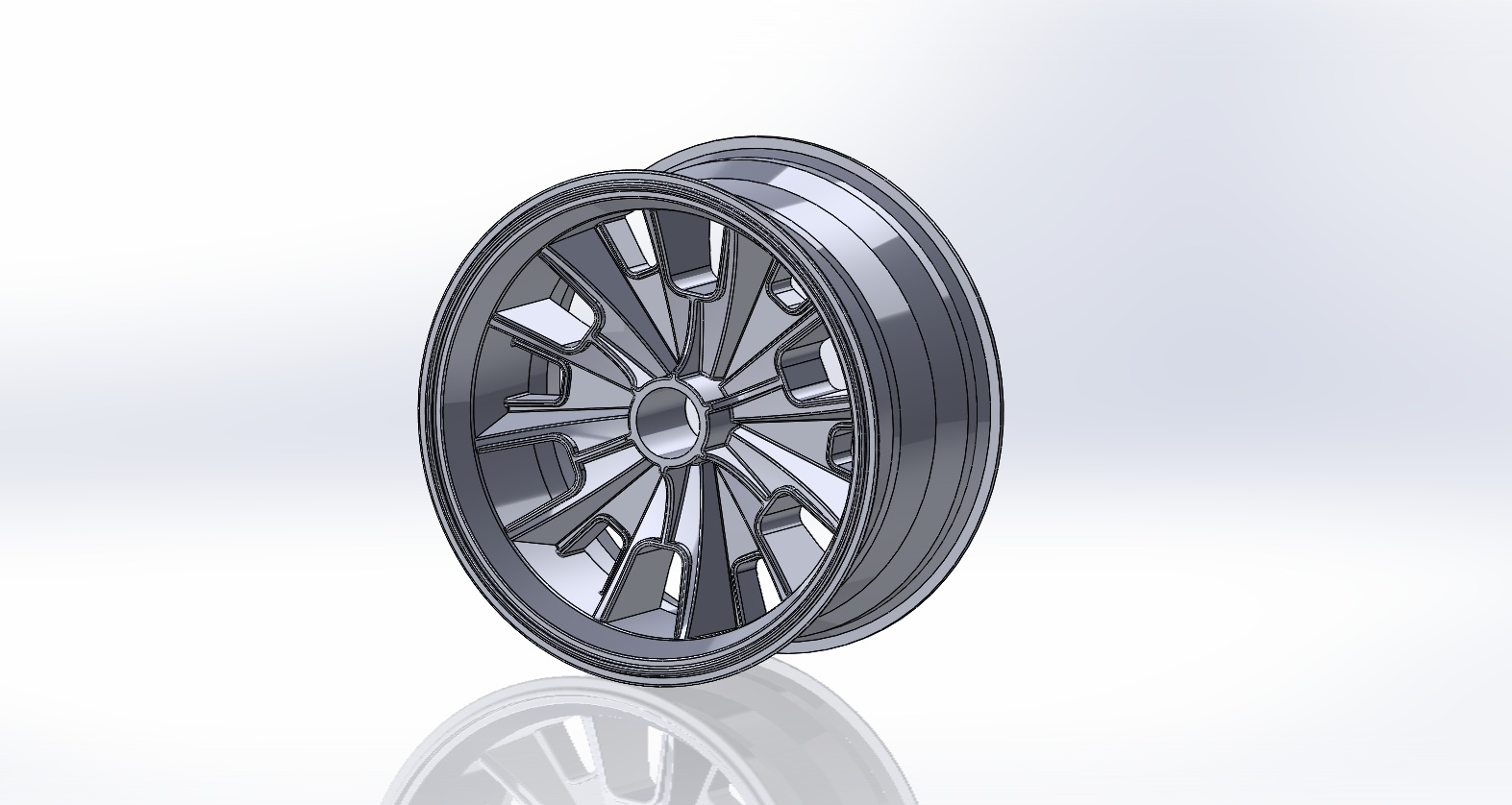

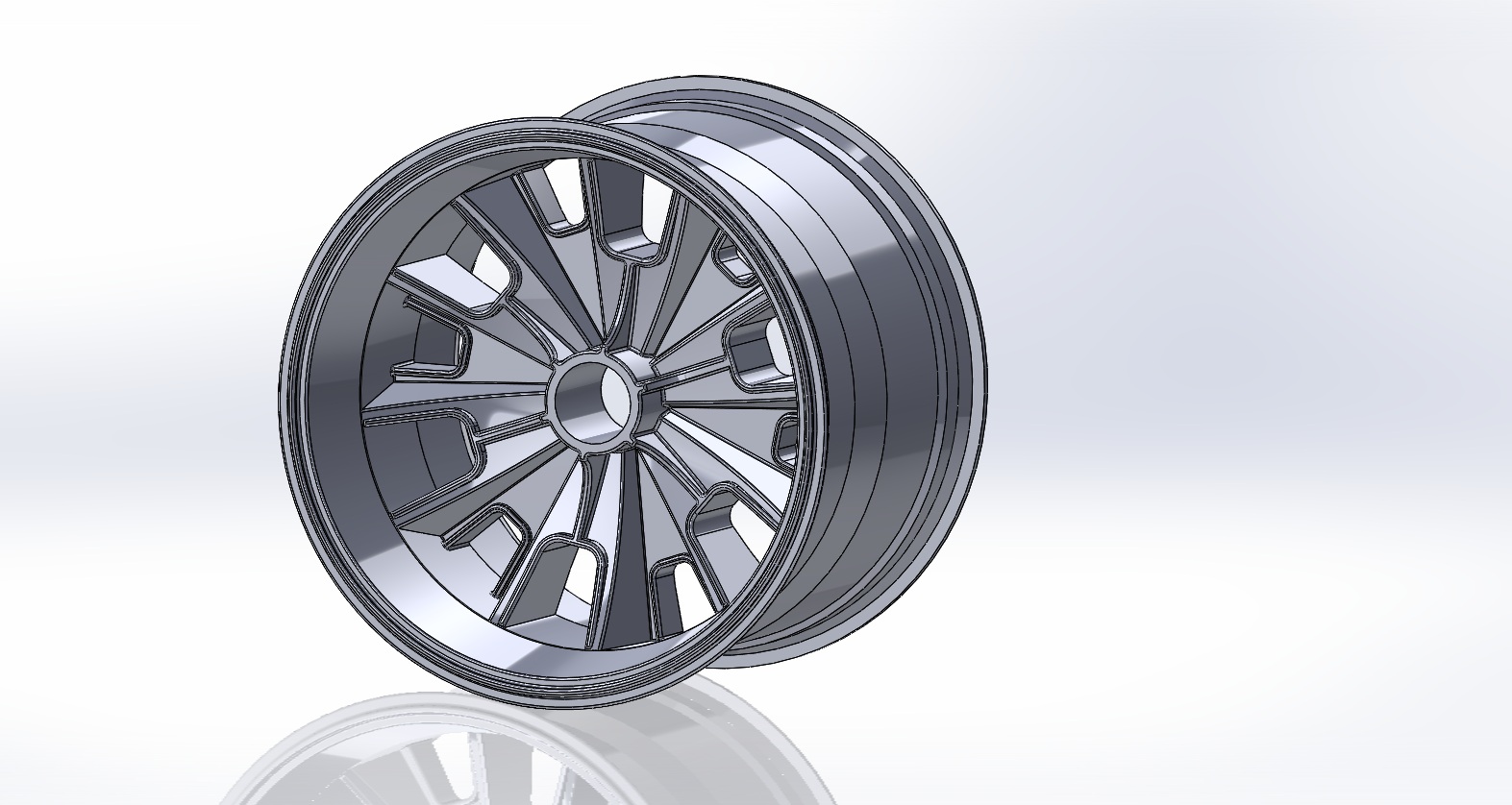

Rims 17 "
Under the front tire size 225/45 R17
Under the rear tire size 315/35 R17

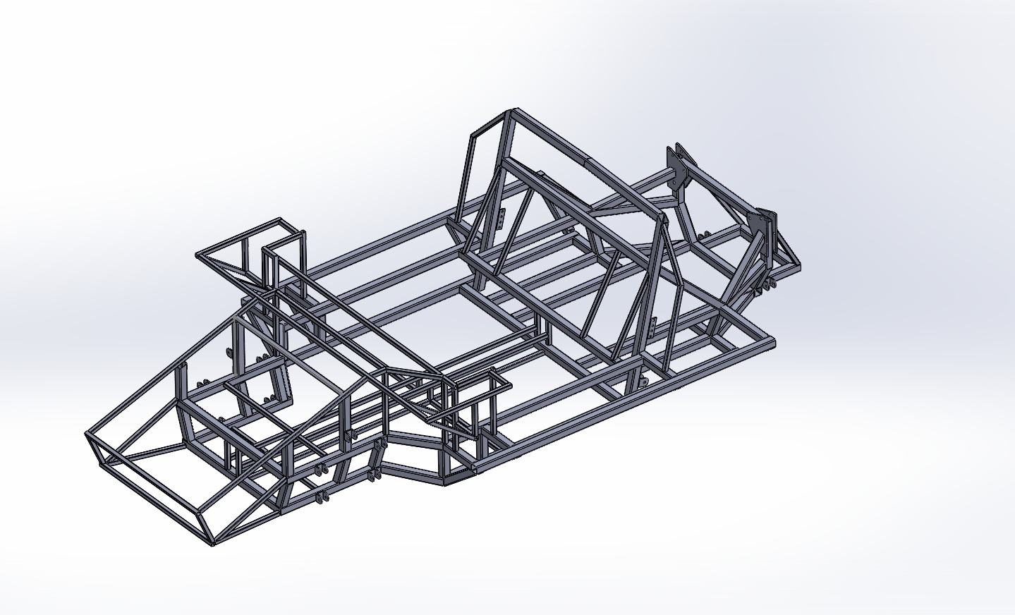

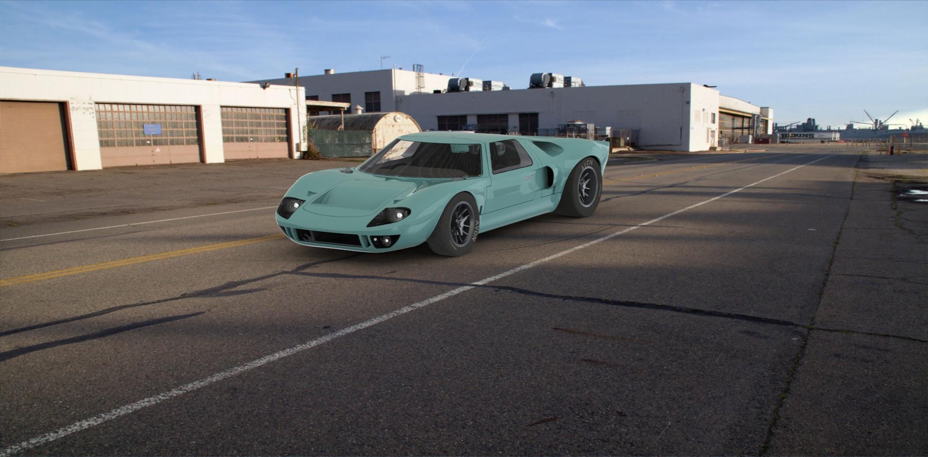

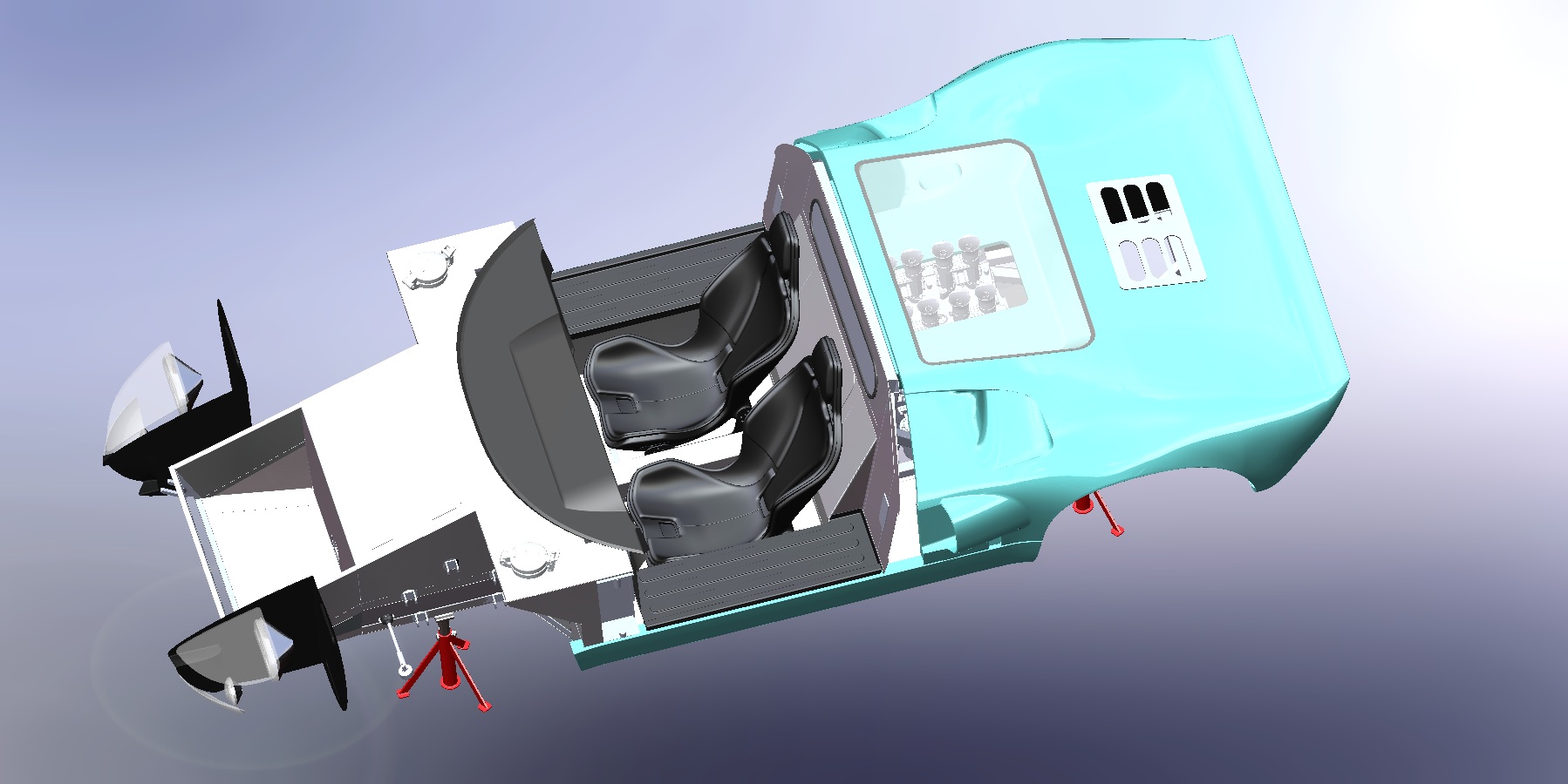

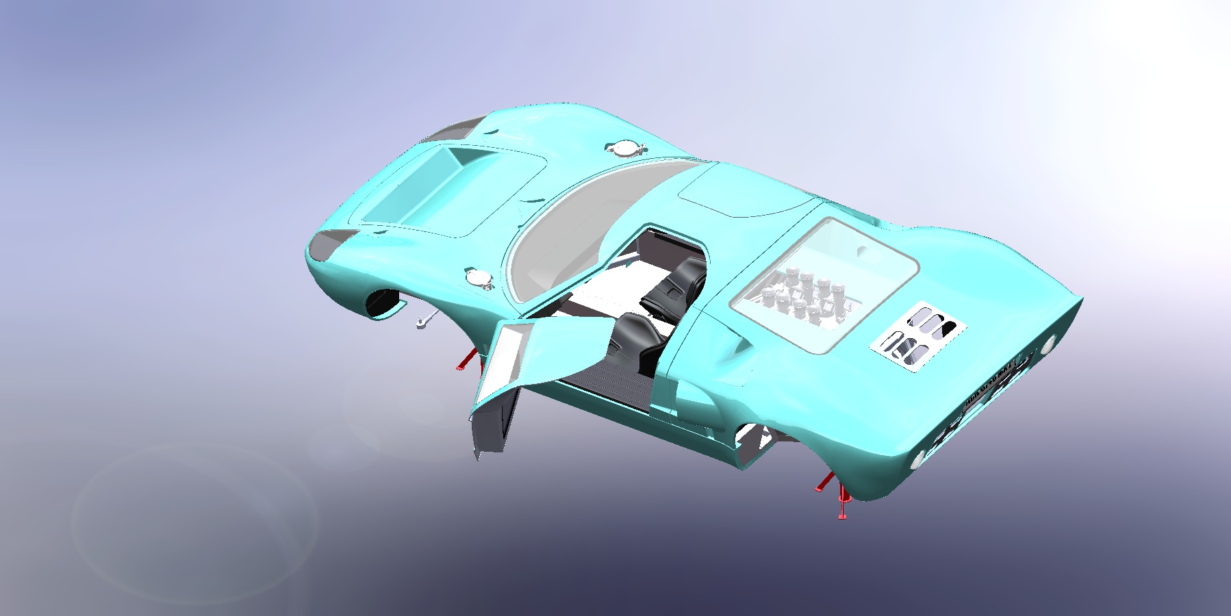

Here is the result.

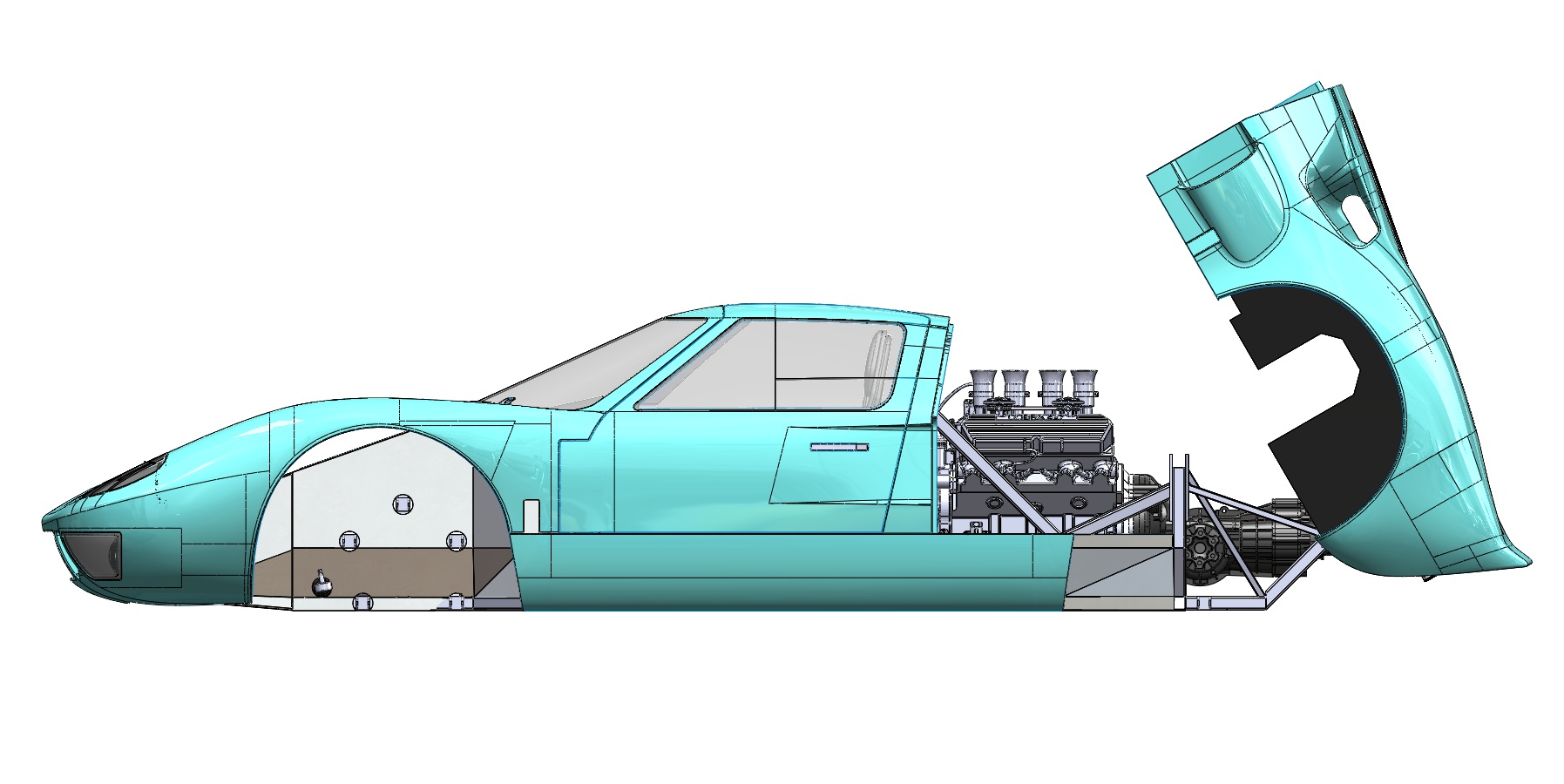

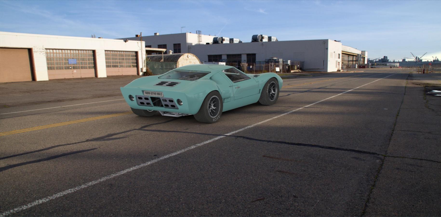

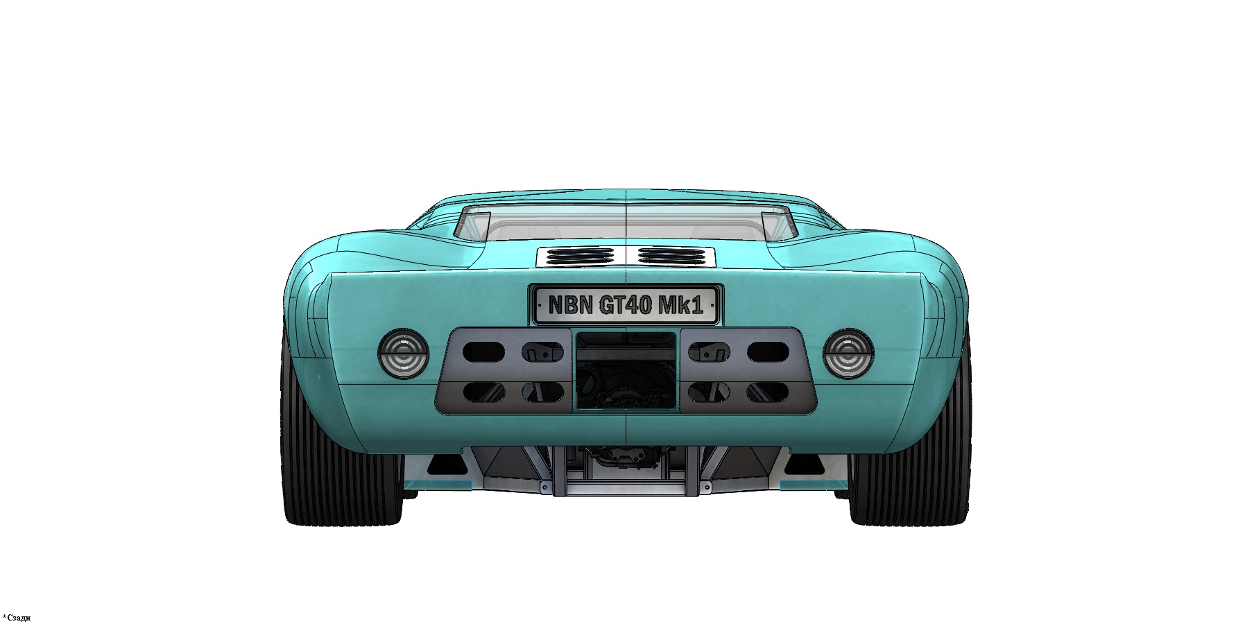

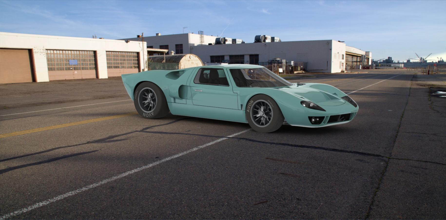

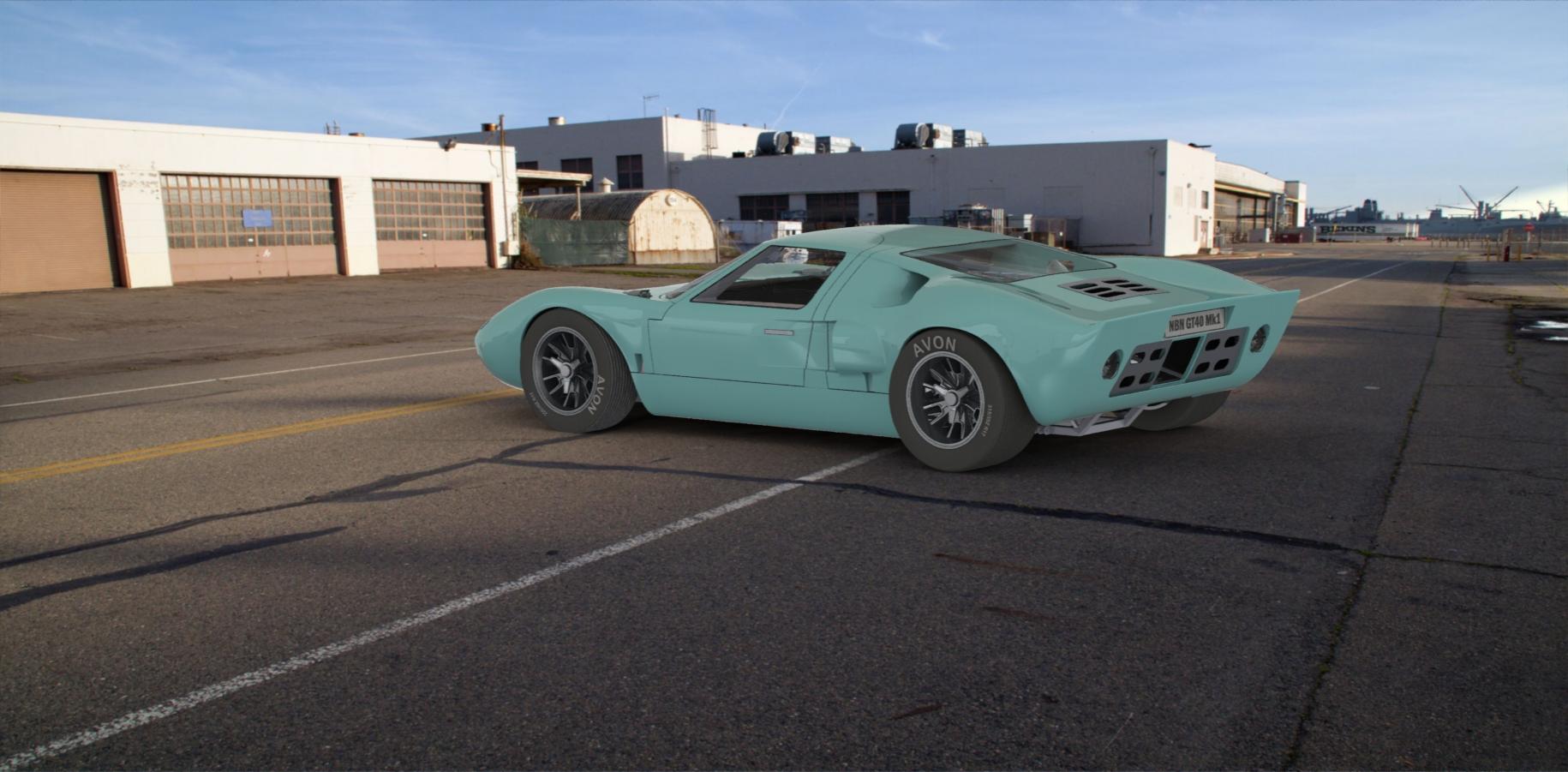

A little renderings...

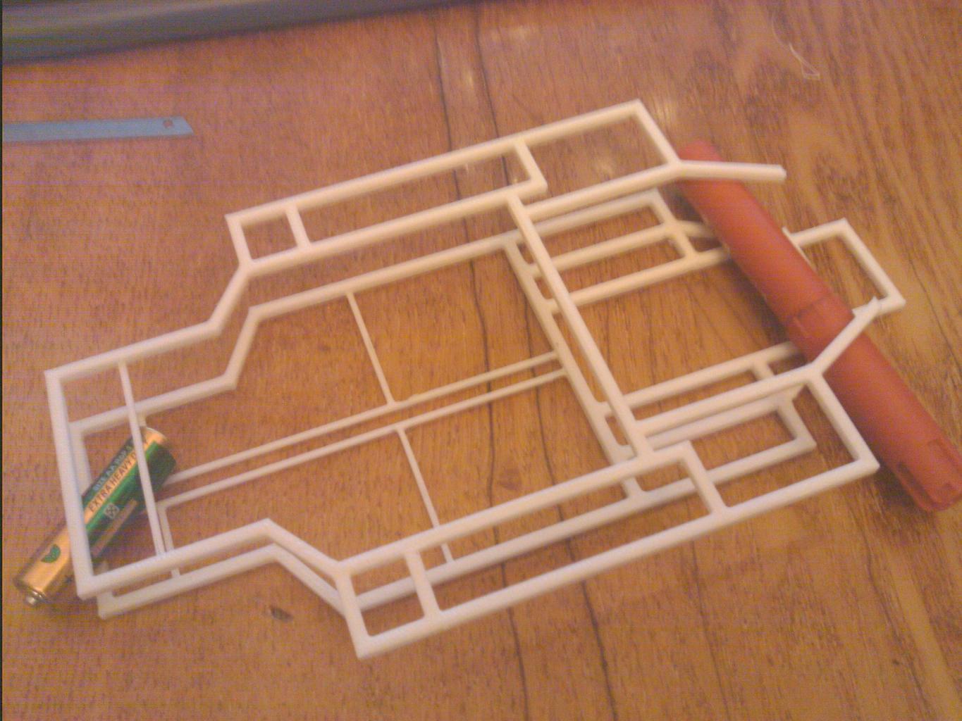

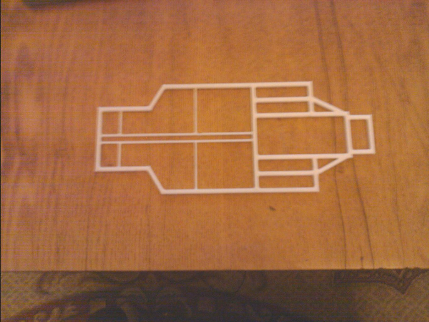

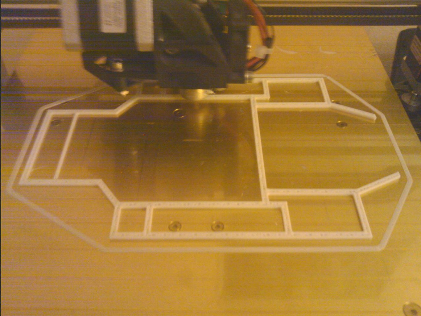

Good evening all! I try to print a frame for 3D printer ...
This is really cool Boris!
I wanted to do the same thing (I model in solidworks and NX) but it seems like its impossible to get measurements.
How did you do it? Just from looking at photographs??
