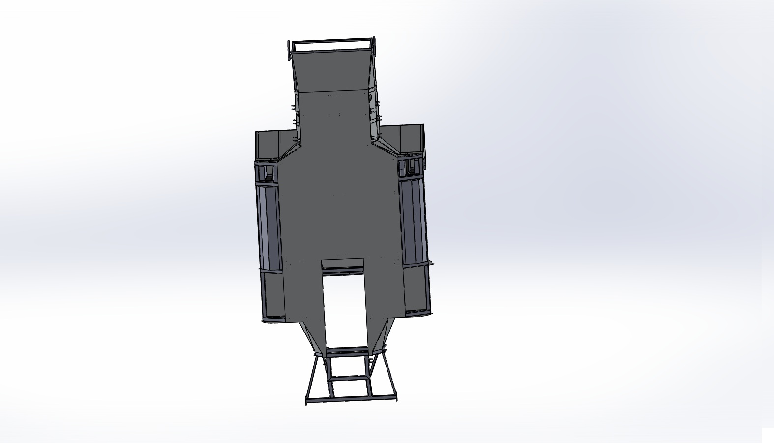

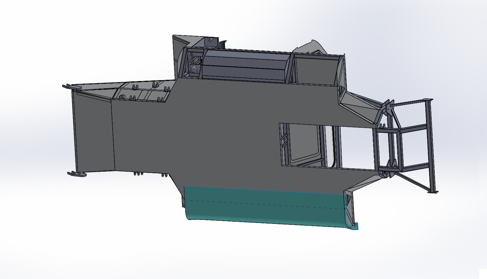

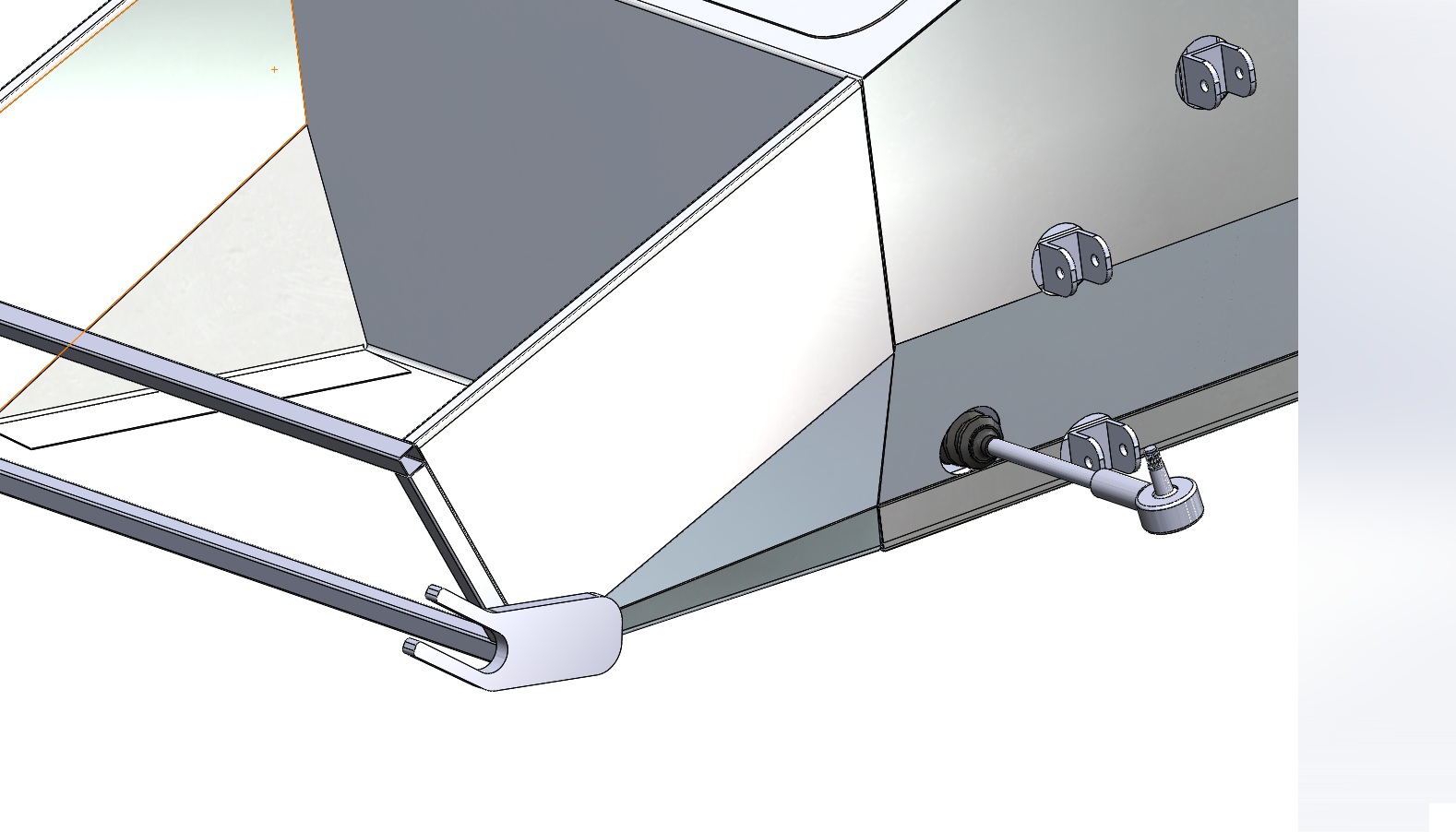

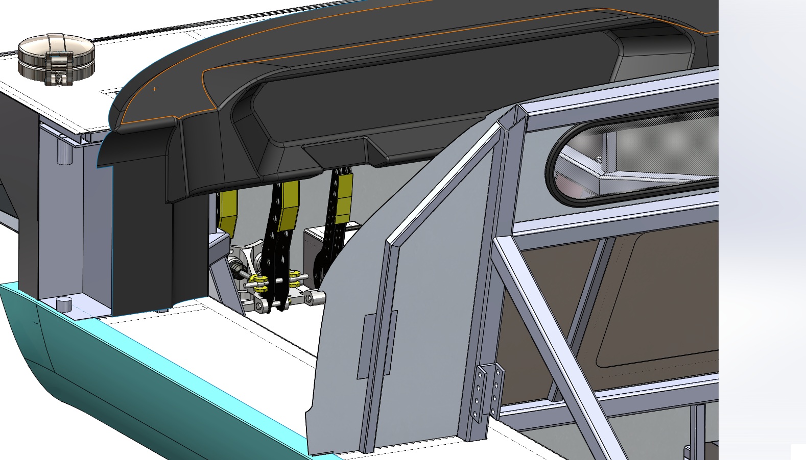

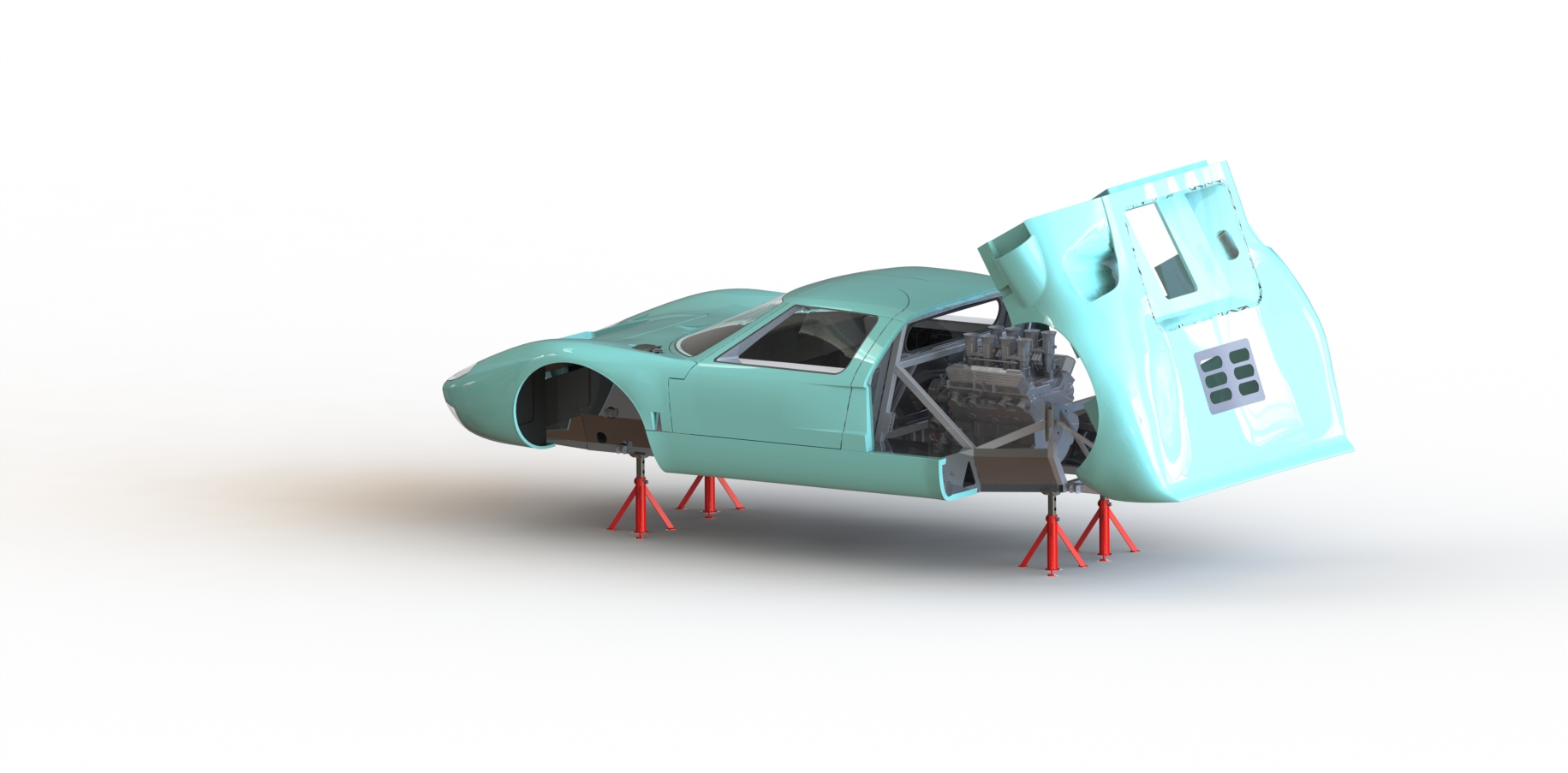

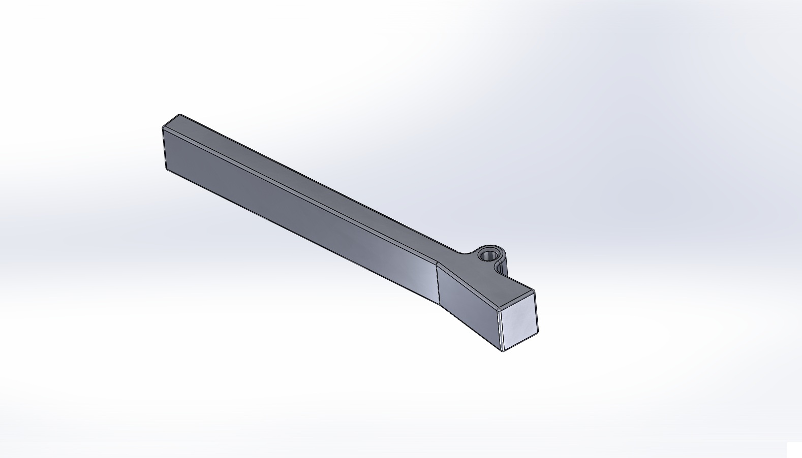

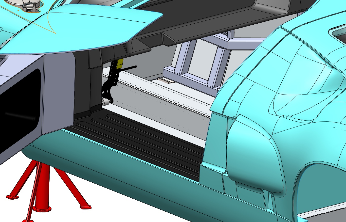

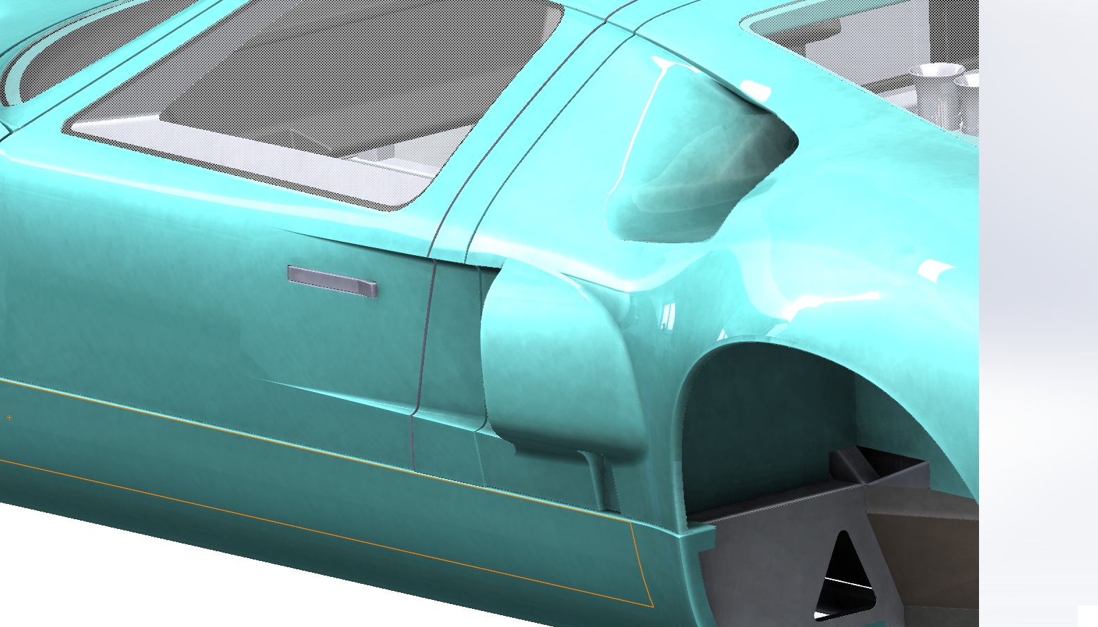

The model and the frame was built in the programe SolidWorks it allows you to perform complex design with precise dimensions.
The data obtained can be easily put to the machine CNC.
This is not easy task but Boris excellent specialist.
Andrew.

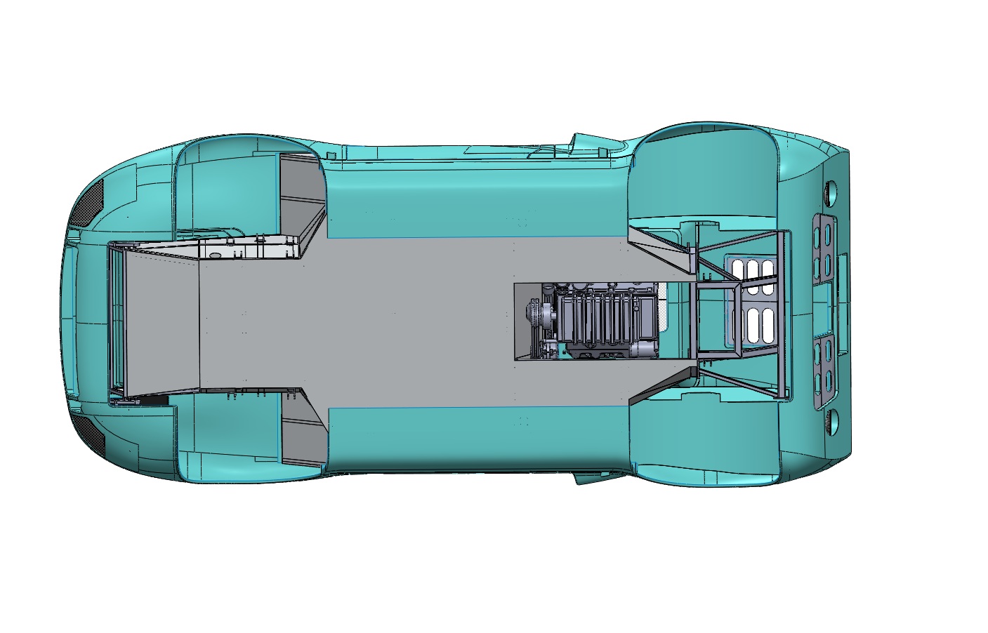

The layout position of the engine.

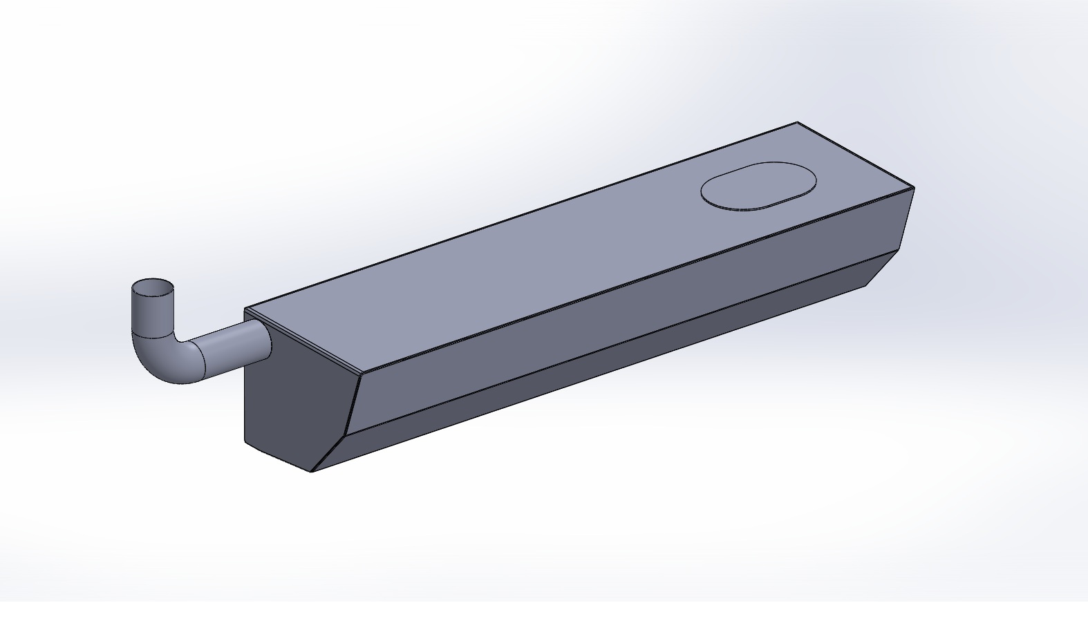

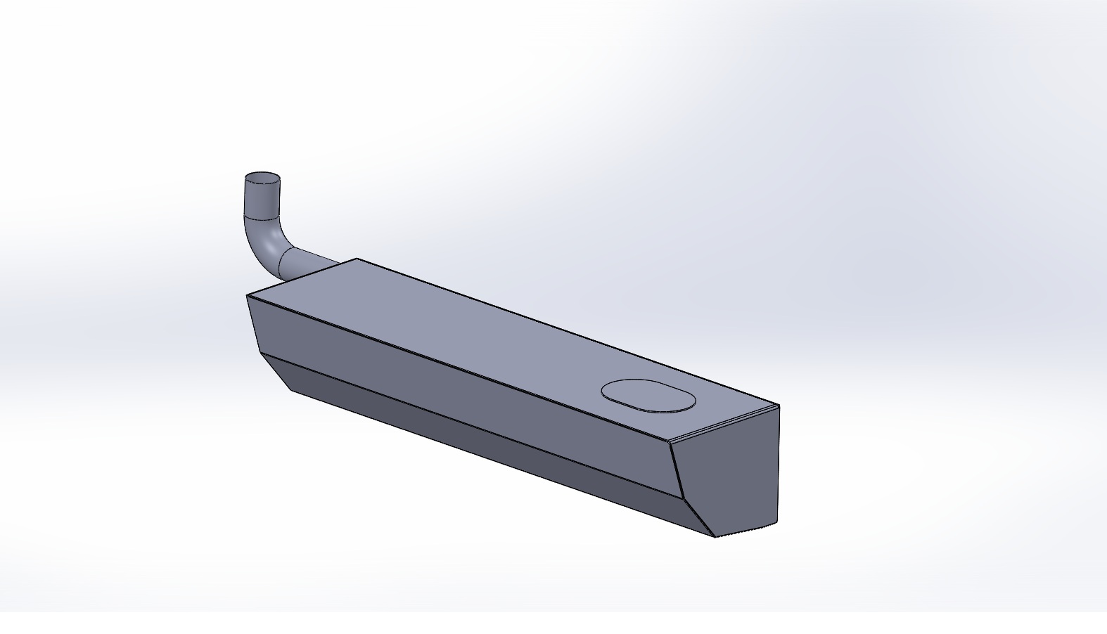

Designed fuel tanks. Tank capacity 58 liters ...

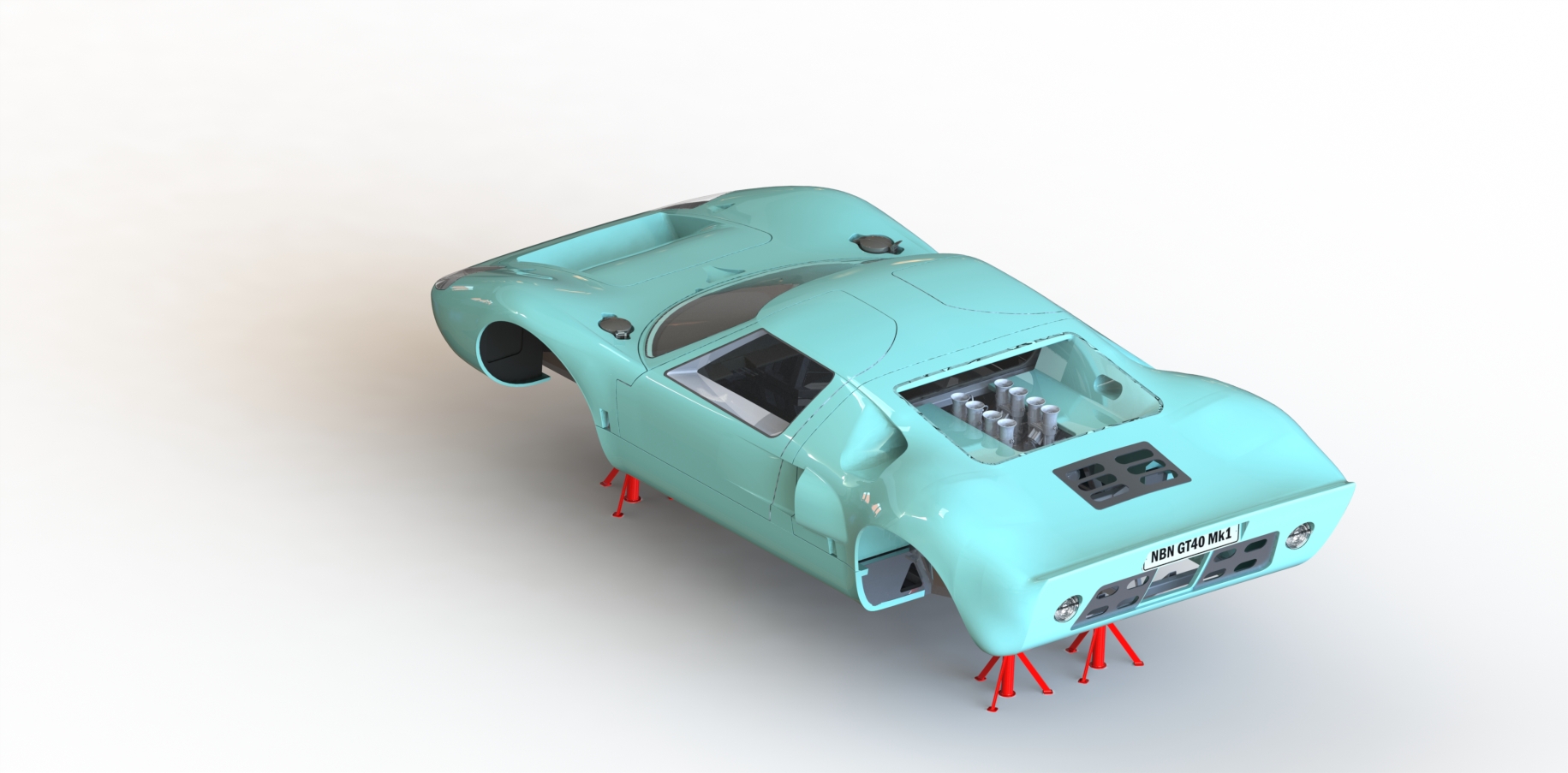

Good morning friends! My name is Boris.
My dream is to build a GT40.
I live in Russia, in our country is almost impossible to buy a kit to build the GT40, state bans on the import of components for assembly, because it requires costly certification. To bring yourself to a dream I started designing his GT40. I hope that I realize my dream and build a dream car!. At design time, I and my friend Viskov Andrey faced with questions. I hope you will help us with the answers to them.
A blog about building a post here. This is also a building, even if virtual.
