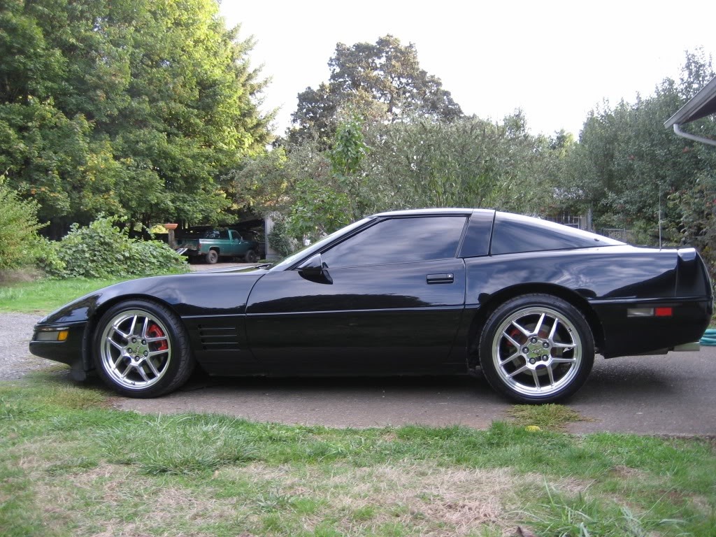

As far as donors are concerned - I don't have a clue how plentiful they are on the other side of the pond, but here they almost seem to be like rabbits (everywhere) and can be had for very low buy in price.
I would look to the C4 (84-96) Corvette.
Great suspension bits and geometry
Very nice brakes if you chose the 92 (I believe) or later with the dual piston calipers
And most of all for you would be the main tub with doors, and a good rake to the A-Pillar and windshield. Yes, there would need to be some relocation of parts and much scrap left-over, but since you had established no real boundaries for the donor... :)
