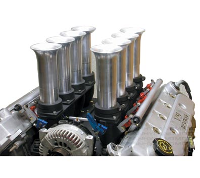

There is a complete car in sweden with the 32 valve ford engine. I saw the car in the wheels magazine. The car was in a alfa shop in upsala.The car was complete.
Web adress to the owner is : www.autokinito.se
Then look at : "verksta'n" Regards ingvar
