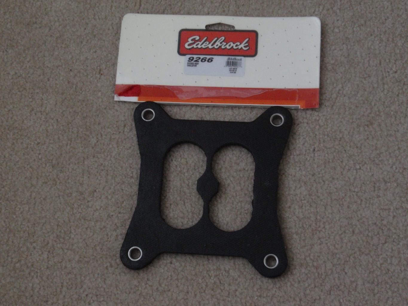

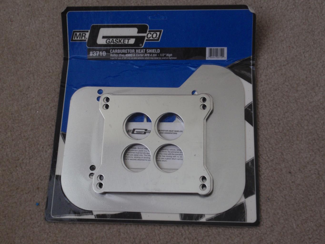

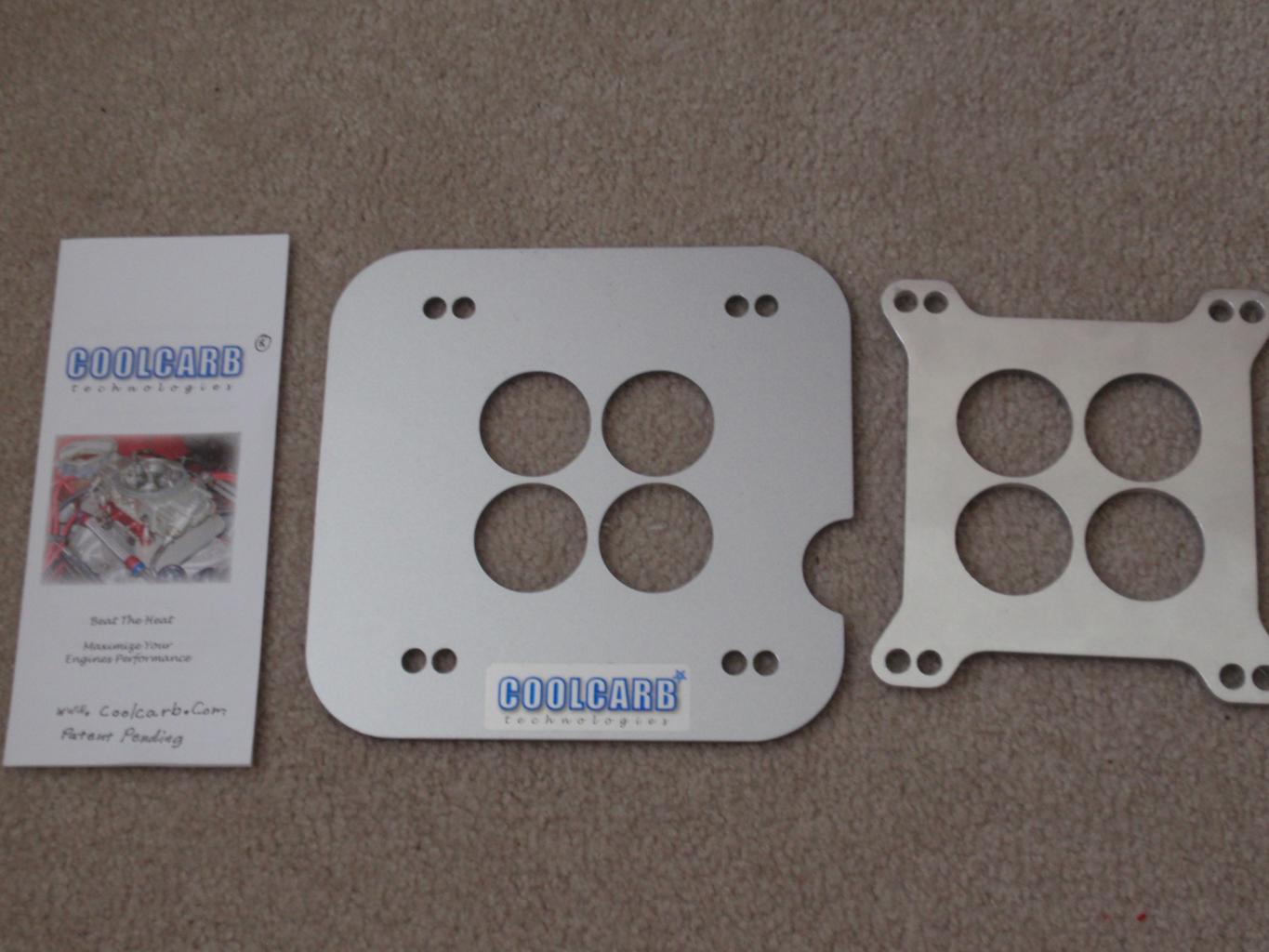

So I've shopped around and looked at a few products, the Mr. Gasket heat shield, Cool Carb, and the Edelbrock phenolic spacer. For various reasons, including the limited clearance space, I went with a mix of the Mr. Gasket shield and the Edelbrock spacer. When I finish the rear deck conversion to Lava-Mat, I'll take it for a run and see what the temps look like. Here are some before and after pics.

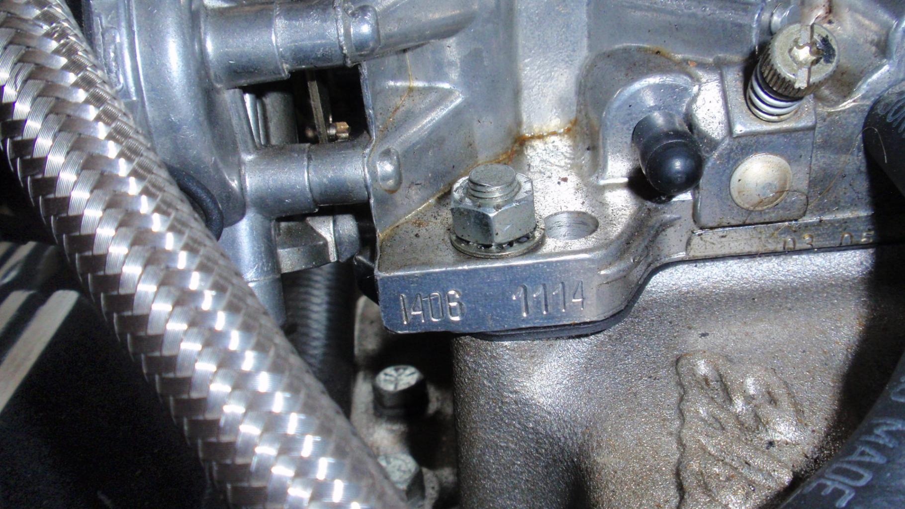

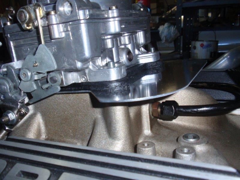

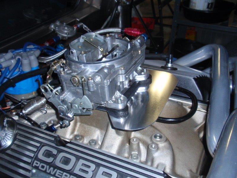

I think it is more soak from the block than the radiant heat from the headers given the temps of the block were identical to the carb only after shutdown and the coolant flow stopped. Additionally, I never have problems until after shutdown and I restart. I put a shield to reflect the header heat to be cautious. I'm sure the header heat doesn't help though.
Here is the before and after the installation.
