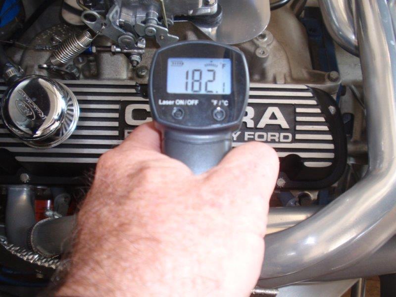

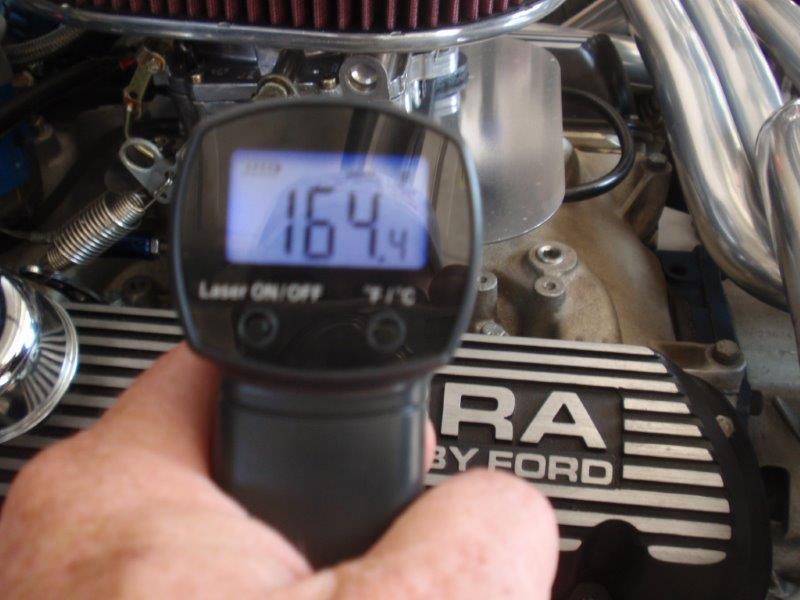

Well, I've got it all together and some interesting results. Pic 001 is the manifold immediately after shutdown and 002 is the carb. While pre-shield they were at the same temps, you'll see with the shield manifold is 182 while the carb is 164, a modest 18F cooler.

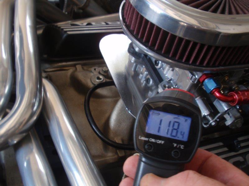

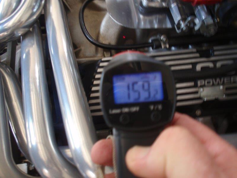

The surprise was after 20 minutes of heat soak. Manifold in pic 031 was pretty hot at 159 but pic 033 shows the carb cooled to 118 for a 41F improvement. So it appears the barriers allow the carb to cool faster when should help hot engine restarts.
