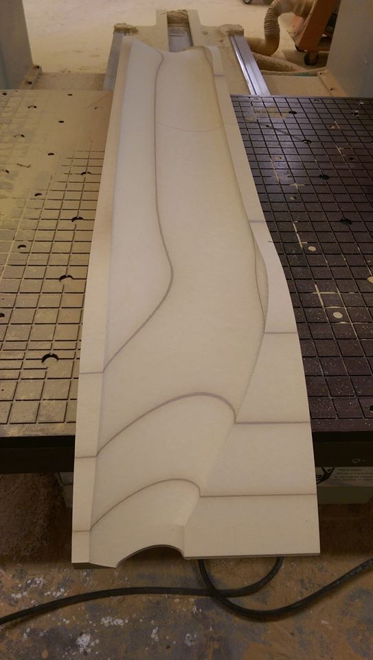

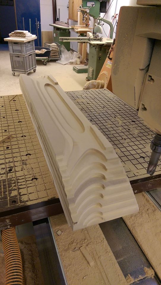

Here some pictures from milling the spoiler negative.

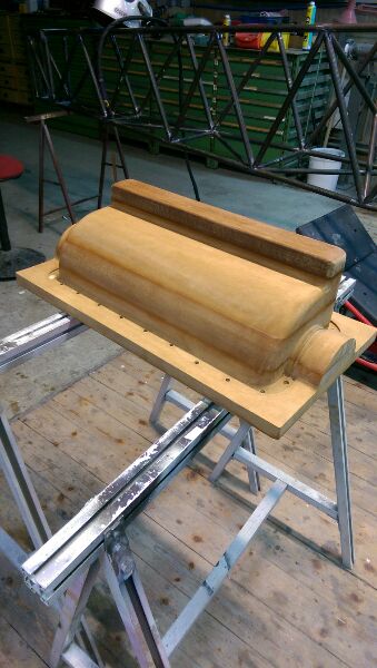

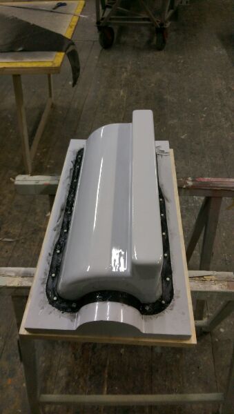

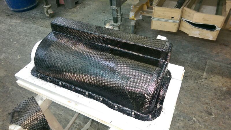

Now we do the next modification, we build the oilpan for the drysump in carbonfibre .
We were on the search for the oil leak, and we found an uneven part at the sealing. And we thought the oilpan could also be lighter. thats the next try and i hope no error.
Then we can also fix the problem that we dont have to remove the starter for removing the oilpan. When the engine is in the car.
Urs

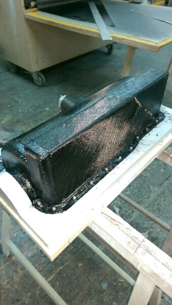

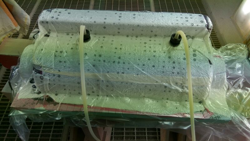

Tonight we laminated the oilpan . Its now on the vacum . We see tomorrow how it comes out.

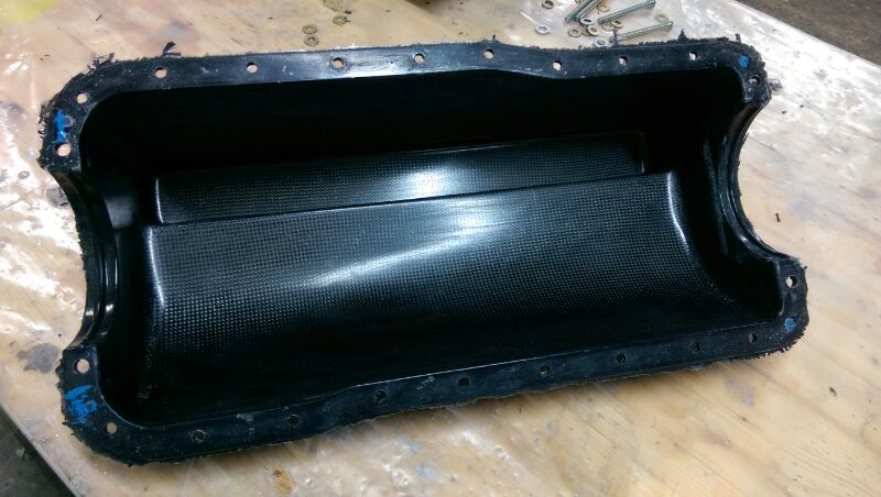

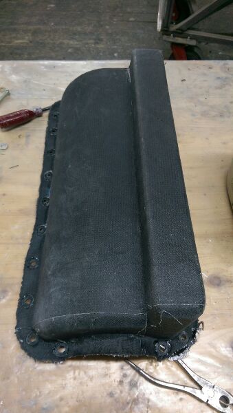

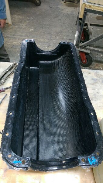

Now fresh out of the molds . The weight is 500 gramms without fittings . The original is 6 kg.
Greetings from switzerland

Urs,
Nice work as usual. Just wondering what resin system/matrix material you selected for the oil pan given the operating temperature and hot oil. Will the interior be coated?
Best,
Kelly
Urs
Thanks :)
@ Kelly
we took Epoxyd Resin L and Hardener L that should take higher temperatures.
the original aviaid pan is 6kg and the carbon pan with all inserts like in the aviaid pan is 1.2 kg
