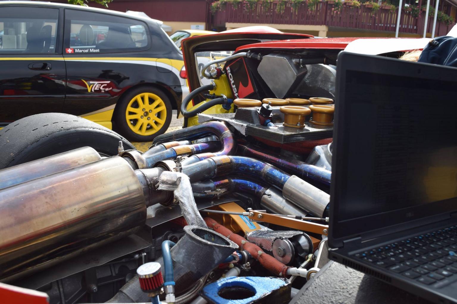

Last Monday we were on track again. First Time with slicks and the light wheels of RCR.
Was really nice , now we have to solve a little problem with the ZFQ which is spraying out the oil and then is getting very hot.It could have something to do with the pump which not really work fine.
Here some pictures.
Greetings from switzerland.

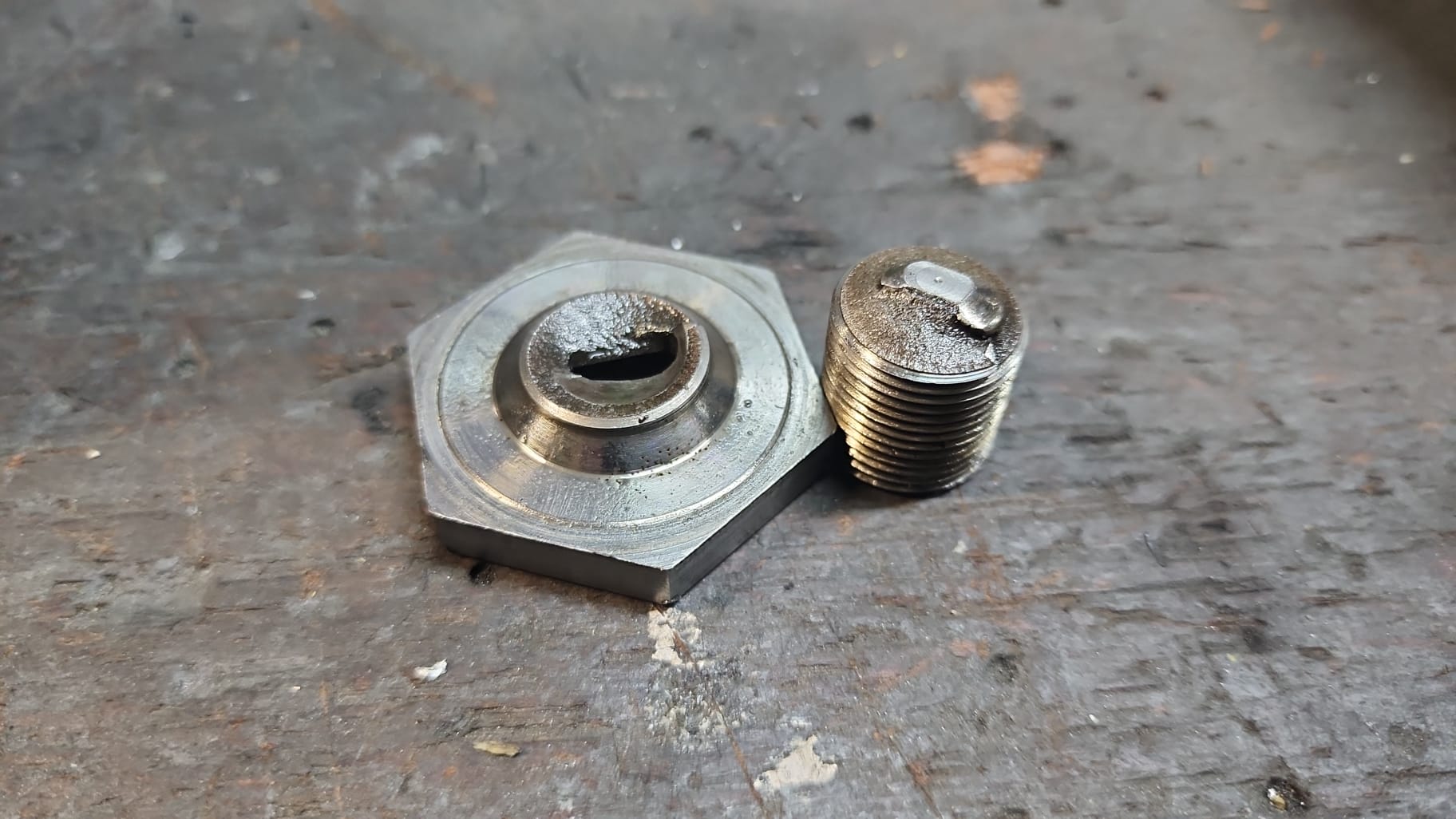

We have a problem with our ZFQ Transaxle. Does someone have an email from Chris Melia ?
Sended an email to Quaife and they dont answer.
Very odd to see the smooth fatigue failure section at the center of the break, with the rough fracture finish around the outside, however even that does not look that rough. Is there pitting in the base metal, particularly at the root of the thread?
Urs
Hello
No the base metal is good, only teh bearing and seal is not good anymore.
