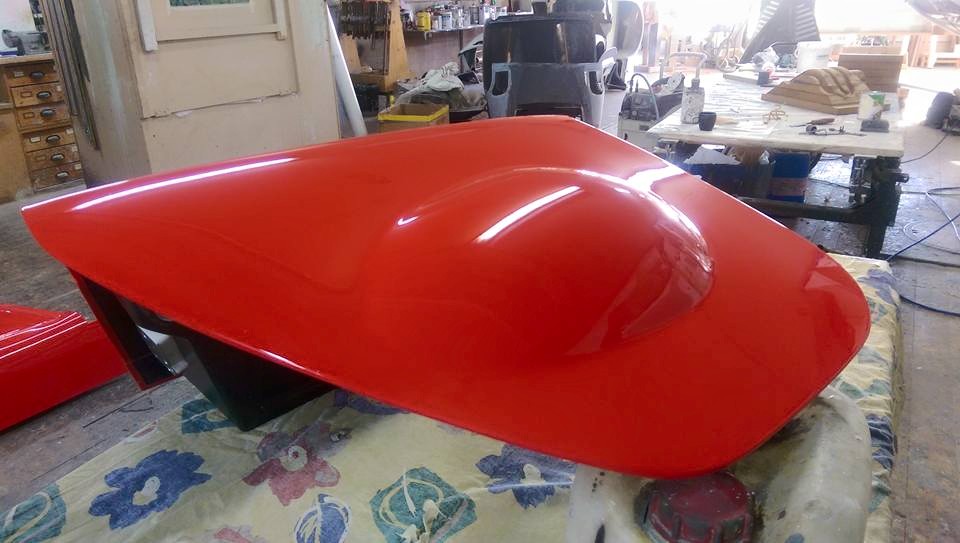

The first painted Part :)

Urs

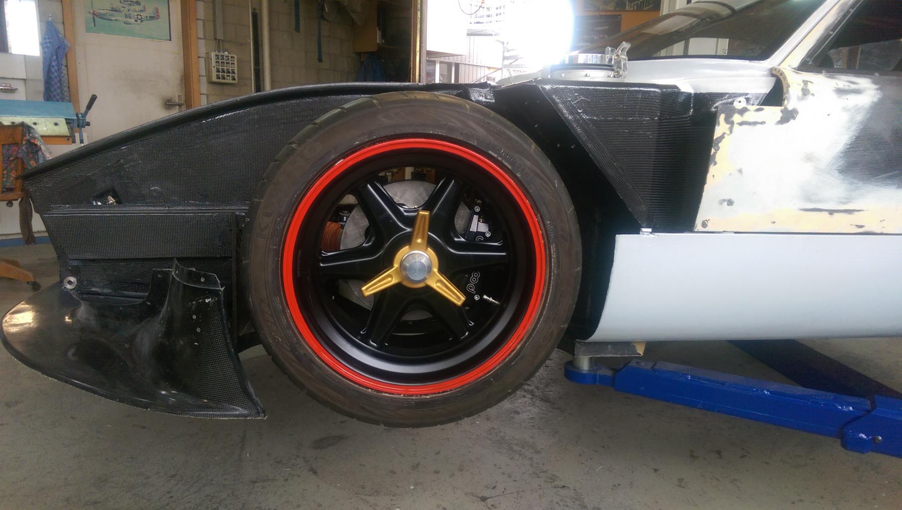

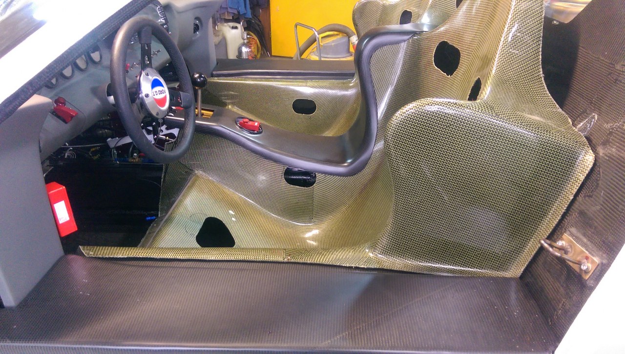

Now the wheels are painted and also the interior Panels are done.
Now im at work at the front and rear Clip, a lot of sanding and fillering.
Greetings from switzerland.

Good progress !!
Will you protect kevlar carbon edges with sort of rubber U small profile
your project is really coming nicely !
Super !!
Thisis why when we where using Kevlar carbon( years ago!!) in our LMP cars I used to laminate a 30mm pure carbon stripe everywhere on edges to be trimmed due to the impossibility to cut properly aramide plies ( only water cut can do a perfect cut!!!)
Doing that after unmolding trimming was done only on carbon stuff so all edges where neat !!
the fact is your seats looks absolutly great with this 50/50 kevlar carbon mix !!

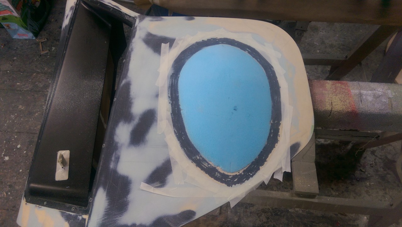

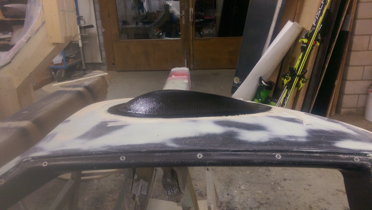

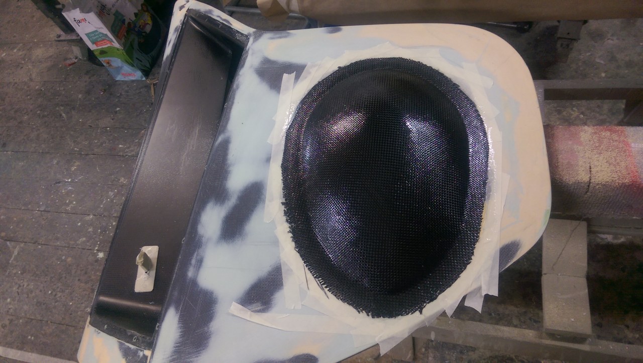

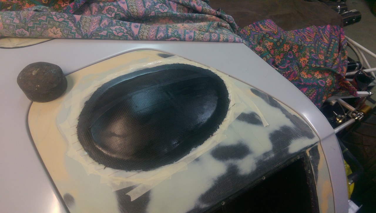

Yesterday i builded up a gurney bubble, i have not enough headroom in the car. We machined a foam Piece , then i glued on the door and covered it with 2 layers of carbon . next Thing i have to cut out inside the door and put also on 2 layers.

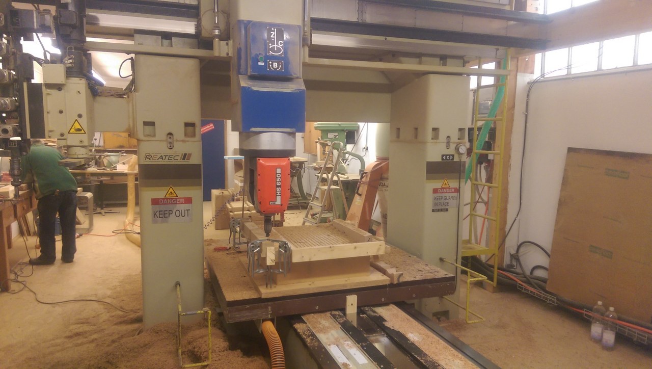

We also have a new machine in the Workshop and a new Project :)

New machine ; 3 or 5 axis ?
what maximum capacity ?
Milling only Foam or also "LAB" and alu

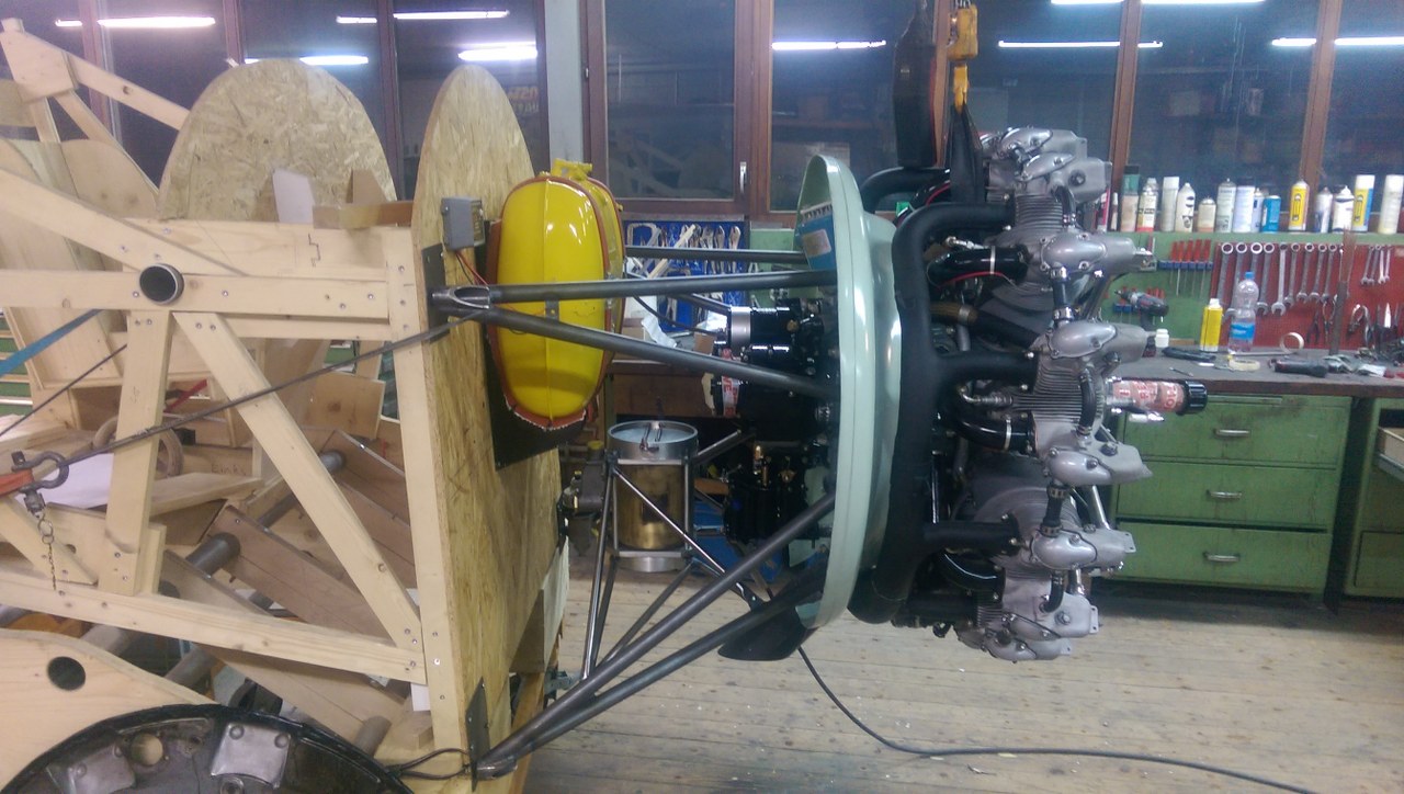

Urs
Its an engine Fitting to a template of a Junkers F 13 fuselage which is in production in Germany. The plane should go to Oshkosh this year... maybe...
the new machine is 5 axis
1600mm wide 600mm height and in length you can machine around 2000mm.
until now we machined Wood, foam and carbon plates.
for the next Chassis we can machine the carbon Sandwich Panels out ;)

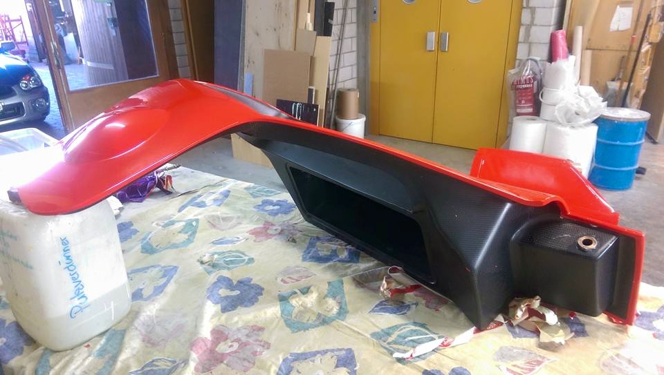

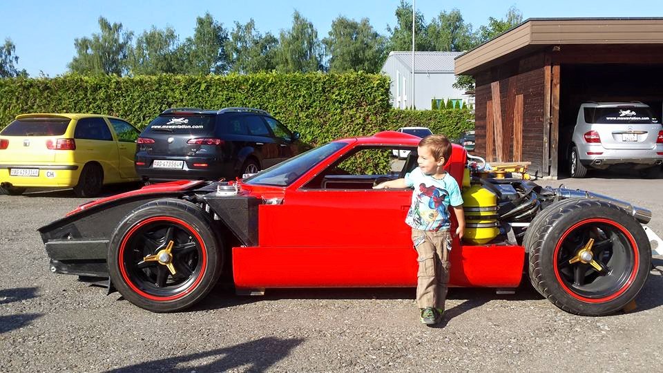

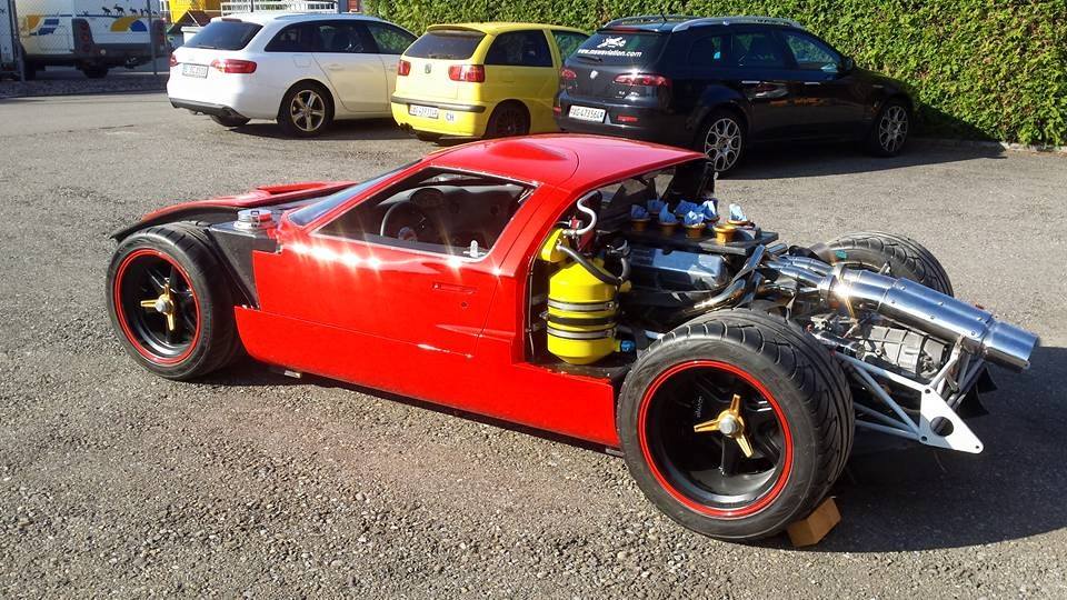

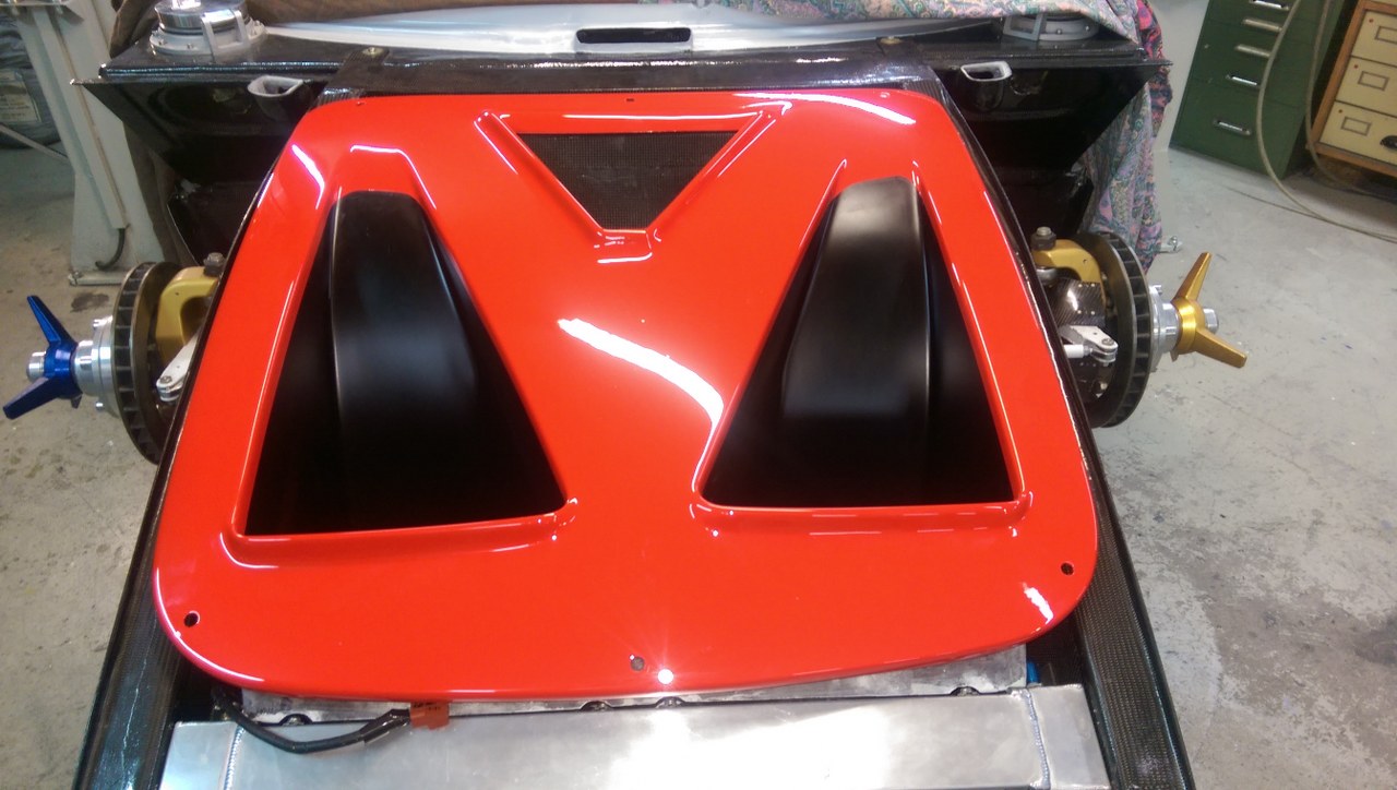

Now we painted the Chassis and the Doors. The trailer for the car is also in build :)

I'm only guessing, but I reckon that boy in picture 4 is only 43 inches high! :laugh:
Looks stunning Urs....:thumbsup:
Urs, that is a very nice looking ride. More pics please. The wee man looks thrilled. Maybe he knows the car will be his one day?
