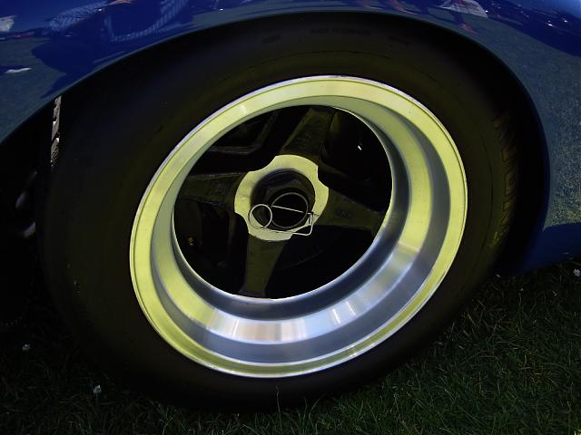

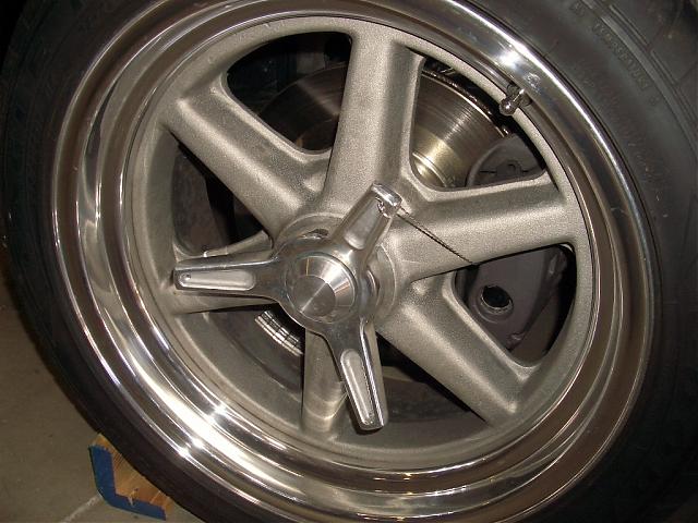

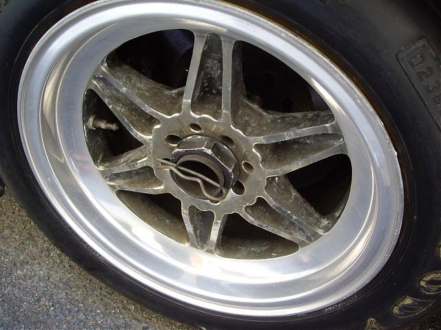

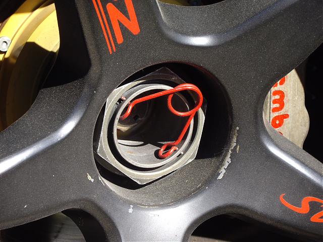

Also, I hope I am not sidetracking this thread, but besides safety wire here are a few pictures of spinner lock methods I have seen. If someone knows a source for this sort of hardware, I would appreciate the reference.

...Also, I hope I am not sidetracking this thread, but besides safety wire here are a few pictures of spinner lock methods I have seen. If someone knows a source for this sort of hardware, I would appreciate the reference.
Bob - No hijacking detectable from this perspective. My suggestion is, if any of the North American forum members is an SCCA member (there has to be one besides Ron), open up a recent copy of the national mag (been a few years but thought it was called 'SportsCar') and see what can be found in the classifieds. There used to be a gold mine of suppliers for all things sports-car-racing related there.
John - Appreciate the post. Other than the 'socket' that Jim G (I think) noted as finding some months back, this is the only other option I've seen.

The first one looks like what I would call a "PIP PIN" (Aviation slang)
The second and third ones I can buy at the hardware store.
The 4th one looks application specific.
The first four don't safety the nut, they just prevent it from coming totally off.
Of course the 5th looks like stainless wire. I would twist it inside a sheath though, to prevent marring my BRM's
