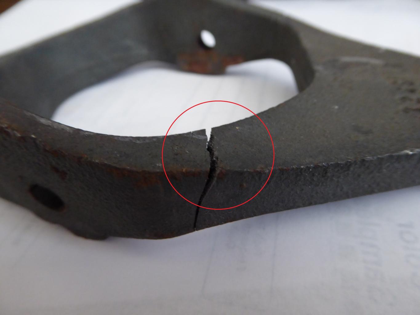

Which box do you have? If it's an 016 you can remove the slave cylinder by knocking out the retaining pin and see if it's leaking. If the slave is getting full throw, you may have a cracked release lever. If it isn't, you may benefit from a master and slave rebuild.
