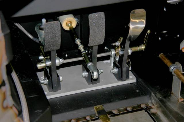

Any help with proper method to move the pedals closer to the driver would be appreciated. I took a quick look and it appears that I can slide all 3 pedals forward towards driver and then adjust length of brake master pushrod.
Looks like clutch and throttle will move without adjustments?
Car is after number 100.
Thank You
Eric
Loosen the 4 baseplate bolts and brake master cylinder push rod nuts. Pull the pedal assembly to wards the seat while adjusting/lengthening the brake rod.
Fasten the 4 bolts and rod locking nuts and you should be OK.
Please look at the attached picture to see the push rod adjustment.
No clutch adjustment necessary.
Throttle cable will have to be adjusted at carb/motor to take up the play in the cable.
Good luck.

tdm - interesting, I had a similar problem in my cav but with my right foot hitting the throttle and the brake at the same time. I ended up taking a very technical path to solve this issue - I got out the hack saw and sawed off the bottom right corner of the brake pedal. My right foot now rests easily on the throttle without hitting the brake pedal. Hope you find a similarly elegant solution.

Gary,
The problem is just an exercise in how to hook the pedal box up and get it to move in a frame arrangement. The originals had several mounting holes in a bracket and the pedal box. That allowed the owner to move the box fore and aft as they needed it, albeit a rather arduous task. The master cylinders were attached to the hard tubing with rubber tubing that would allow the move.

Eric you could use seat track to mount the pedal box on.
Forget the longer push rod the master cylinders should be mounted to the box.
