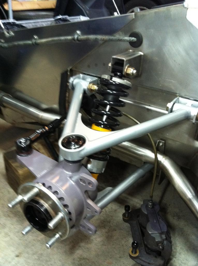

Thanks for your help one last question, its mention in the build manual that there is a black aluminium spacers below the coil spring for the front shock, does anyone know the size of this spacer or have a picture of it.
Mike, here's what mine (early mono) looked like....with new/updated front uprights installed.
