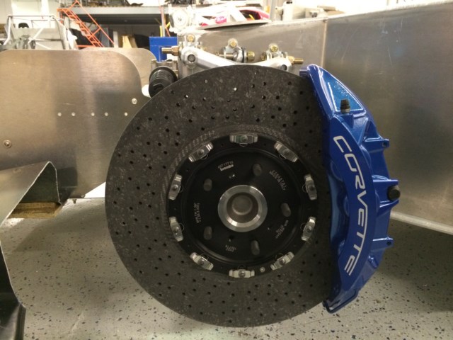

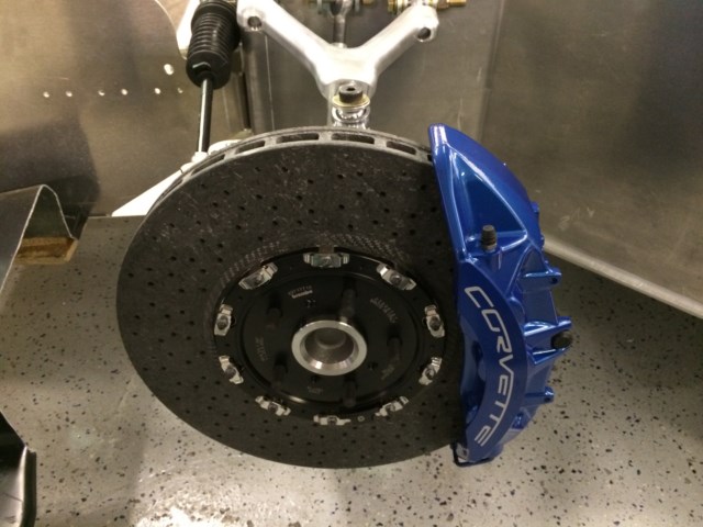

Here are a couple of pcs of an SLC with them fitted
BTW...20 inch front wheels MUST be used to fit these monsters and we have specific uprights designed for their use.
We do have them instock though...
