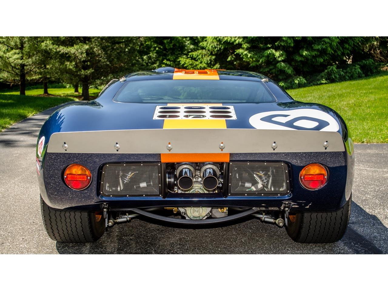

I haven't done it, but the few Superformance cars with Quaife transaxles I have seen, the visible issue seems to be with the rear crossbar. I have seen various iterations of modification,...ranging from bending, sectioning, and stepping the crossbar. As I say, I have nothing to do with these,.....just my observations.
How do you tell that the ones pictured are not the six speed 72G box? I presume this is longer again.
(62G being the 5 speed?)

Elliot is correct. We had to remove the upper, center section for clearance to the Quaife. Just cut it out, grind down the leftovers, and paint it.
