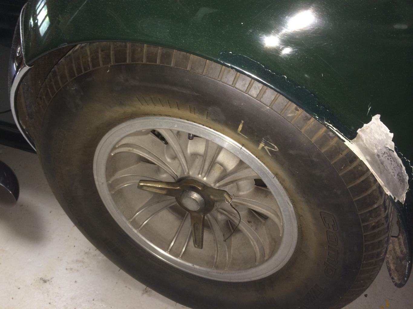

This shows my left rear wheel. I wire them this way so that if the wire has no slack I know they have loosened. Better that wiring them the other way and expecting the wire to somehow keep the spinner tight.
Many of the race cars I drive have safety pins but some do not. I prefer nuts to spinners.
The Thor hammer is designed to install the spinner with the soft side of the hammer and remove the spinner with the hard side. I use the hard side to install the spinners and then get a bigger hammer to remove them.

Leaving slack in safety wire is against the entire reason for using wire.
If you just want to see if the nut /spinner has loosened simply paint witness marks on the nut and wheel.
Again, properly installed, sized, aircraft stainless wire, WILL keep the nut/spinner from becoming un torqued.
In 31 years of corporate jet/helicopter MX, I have never seen a correct safety break from fatigue, and there is a whole hell of a lot more stress on helicopter main rotor head and tail rotor blade parts than on a wheel spinner, LOL!
Well if I used paint maybe I would not see it. I prefer to rely on tightening the spinner rather than the wire "holding the spinner tight". There are many applications for wire where torque is not a factor. Oil sump drain plugs, for instance, would not benefit by having a tight wire.

I use safety wire to indicate movement of the spinner NOT TO HOLD IT ON. If you apply the safety wire in the tighten direction then it must break for the spinner to loosen. If it is present then the spinner is tight. At the track I step up on the spinner at each wheel befor I get into the car before each session. Sort of a touch my nose and spit thing. I try to do it one at least every time I drive it on the street.
