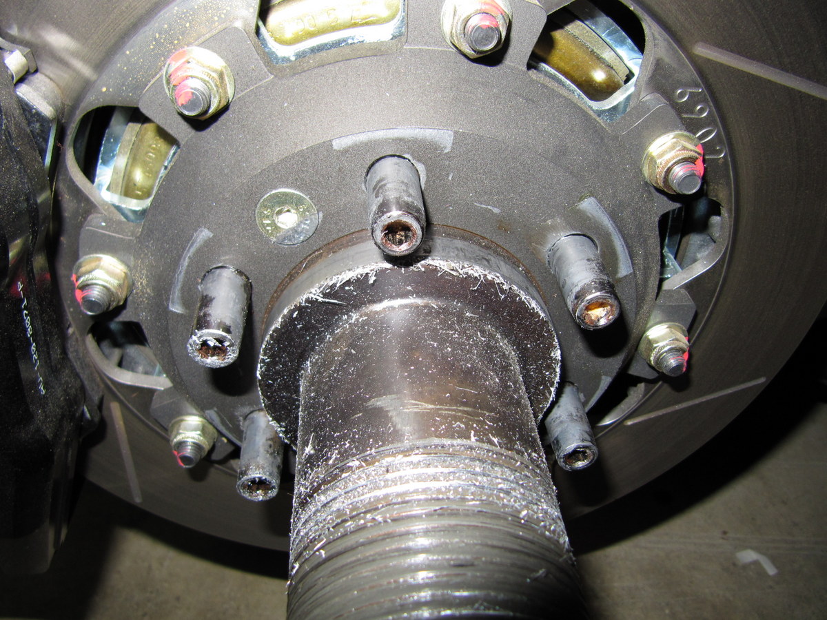

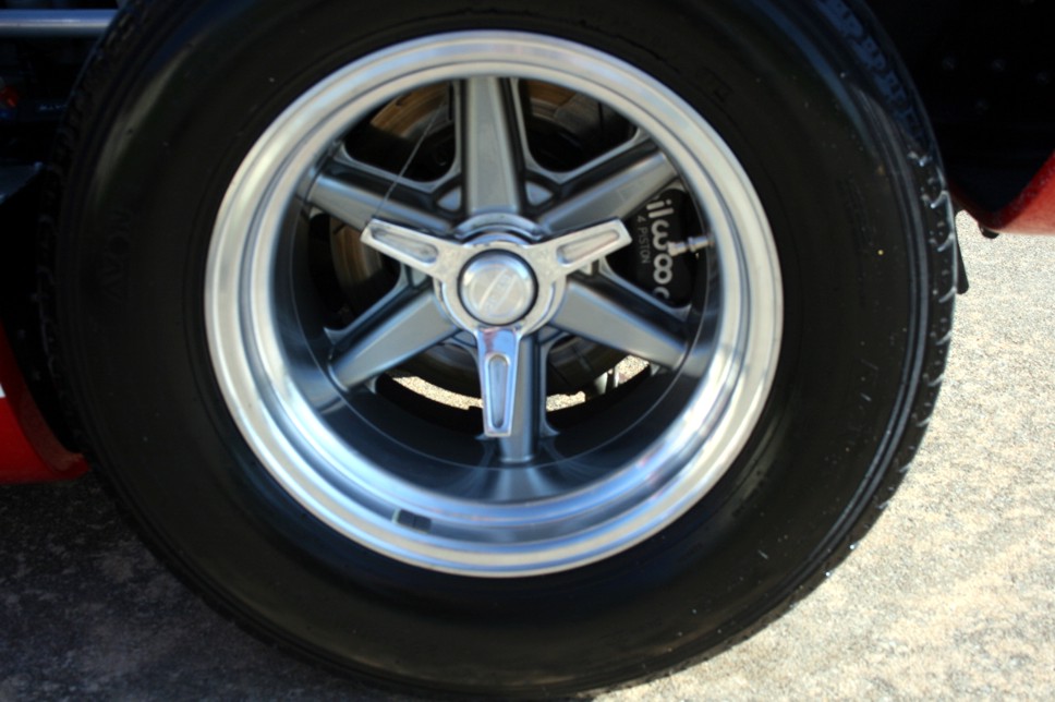

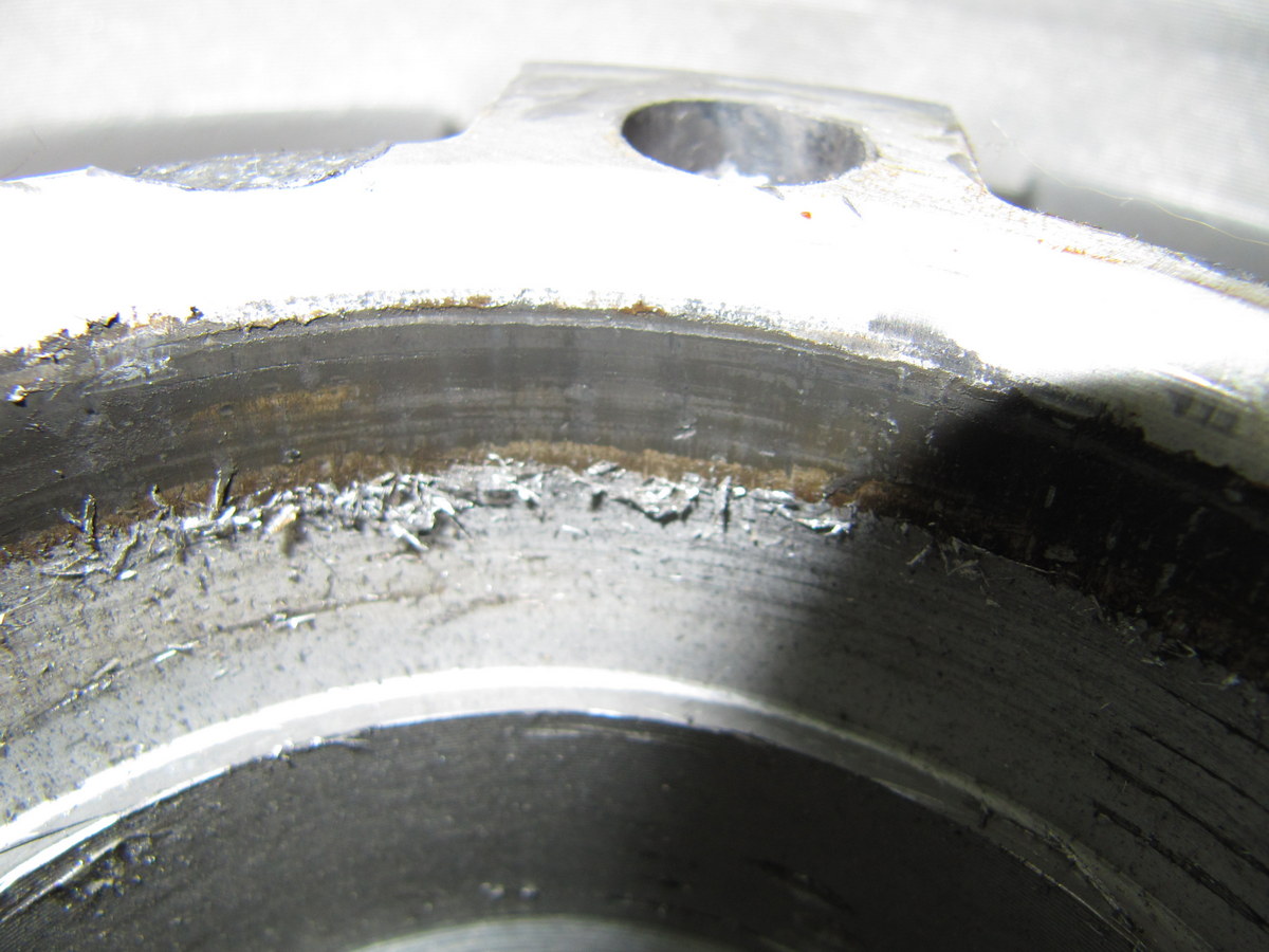

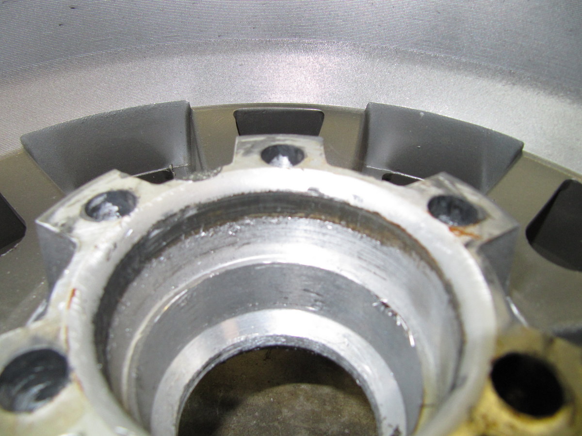

Sears dead blow hammer in the right door pocket, never leaves the car. I guess it could move to the luggage box now that I have one. I've never had a problem with the stock 15" wheels even without safety wire.
On the other hand my 17's have been nothing but problems. The 17's were on the first time I ever drove the car and almost lost two wheels. And that was within two or three miles. It turned out they machined the inside of the wheels incorrectly. Even after "fixing" the problem I still check the wires.
