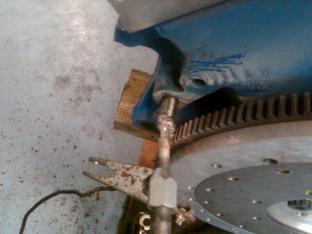

Thanks for all the suggestions on the dowel pin removal. Unfortunately none of them worked! Don't know why. I heated to they were red hot, pried, twisted, pulled, etc. Heated the block, and so on, to no avail.
I thought to make the bushings as Jac Mac described can got some material when I thought, ok, one last try. I got the cutoff wheel and cut a slot in the face of them. Then I got a bolt that would fit in my slide hammer and ground down the head side so that it'd fit into the slot on the dowel. After that I welded the bolt to the dowel pin, applied the slide hammer, and bang, out it comes!
If the damn holes wouldn't have been blind this would have been a non-issue, but the 385 series BBs are blind.

HI Ron Quick word of Caution on grounding for welding, I see the Ground cable is connected to the Flywheel which means you have the chance to arc the bearings. It is best to Ground to what you are welding on ( the BLOCK in this case ) Just FYI . Wally
You know, that occurred to me AFTER I was done. I think she's probably ok though.
Those damn pins were difficult to remove. Very tight, with a lot of engagement. After getting them out and seeing how much force was involved there was no way vice grips were going to touch them.
