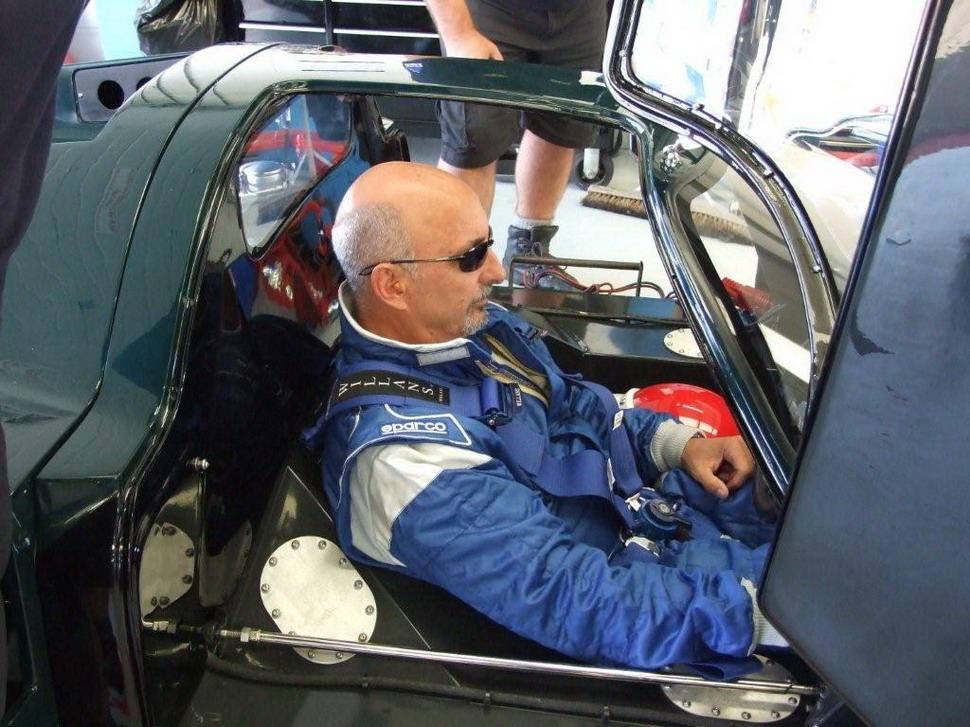

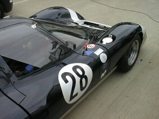

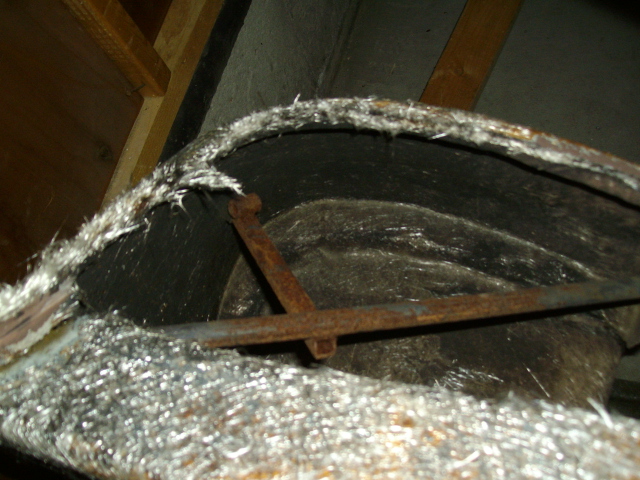

Here is a picture of the outer hindge .025" threaded spherical joint with locknut mounted in a plate. An eye mounted in the roof attached to the window support hoop glassed into the upper window opening. There are two braces welded on to this hoop and glassed into the cockpit section for the lower hindge. I have other pictures of the whole thing I can add later when I find them. I dont think this setup would work on the Europa.

The first pic. I understand & is prety straigt forward. The second one I'm not exactly sure what or where I'm looking at. But as for the Europa. I plan to cut the door straight down (or at a curve back) where it makes the squarish forward area. so in contour the forward edge of the door would be very much like yours. I never liked the way the doors were hinged (this is my second Europa). The other way I've been playing with. Is to do a set up more like the "Lamborgini" doors. It would have to open conventionally a few inches, then pivot forwards over the fenders. Either way I'll certainly need to put some type of steel frame work in to hold the weight of the doors. Especially if I leave the electric windows in place.

On the brace in the second picture a threaded piece or bolt goes through to which a second spherical joint attaches. It mounted on a curved tube piece attached to middle of the door. A small tube at the end of the bend holds the spherical joint. The tube is 90 Deg to the bend. I hope this helps a bit I still have more but I have to find them.

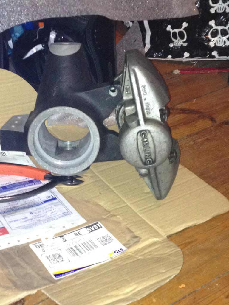

But I got this one of my intended front brake caliper Girling
will add some more pictures later on
