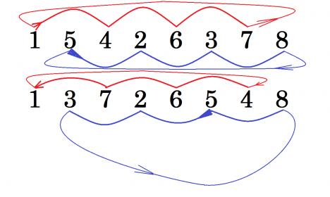

I wondered about the choice between the 5.0 and 302 firing order, and his reply was he prefered the sound of the 302 order with the crossover exhaust. Are there other reasons to select one or the other?

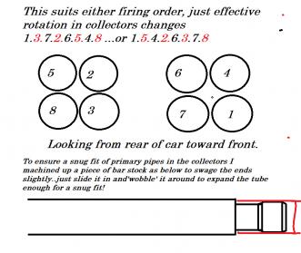

As long as tubes are arranged in collector as in attached dwg it makes no difference to sound.
