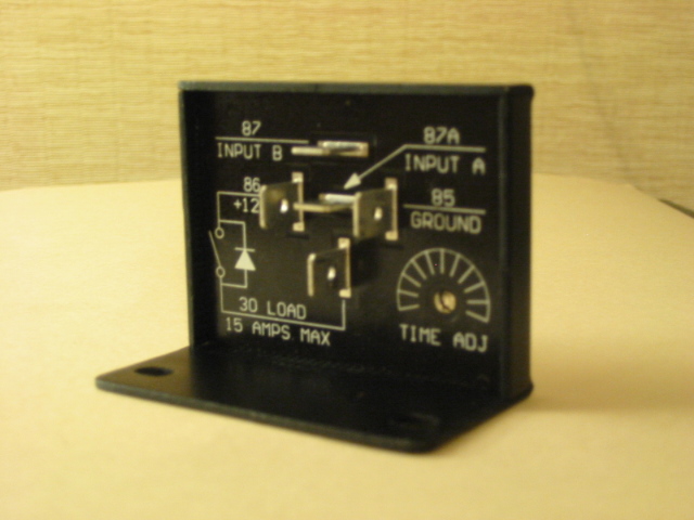

I have an exhaust fan for the engine room on my boat, which is run by a timer; I used a clockwork wall switch from Home Despot, which runs the engine room ventilator for an hour. With two diesels and a generator in a closed space, the heat hangs around a long time, especially in the summer. Running the fan for a few one-hour spells makes a difference (this is 110vac since the boat is connected to shore current when it isn't out running) I don't know if a similar timer is available for 12v; you wouldn't want a home wall-switch timer in a car, but the idea would be similar.

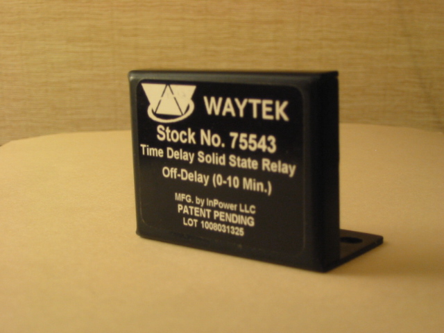

I don't know if a similar timer is available for 12v;.
Some are, see http://www.gt40s.com/forum/gt40-tech-fueling-electrics-engine-cooling/32323-dely-shut-off-relay.html which is a thread Chuck started.The units from Waytek Wire suggested by Jack Houpe looked like the best choice to me.

Jim:
Sorry for the late response. Been preocuppied with the 65 Mustang GT 350 build.
Attached are pics of the Waytek delay timer. Really slick little device. Only a couple of inches square. Can be ordered with a ten minute delay or one hour delay, variable of course. Probably won't get around to installing it until the Mustang is done.

Clever little item. I'm going to have to look at those for some other ideas besides the fans.

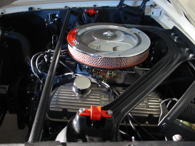

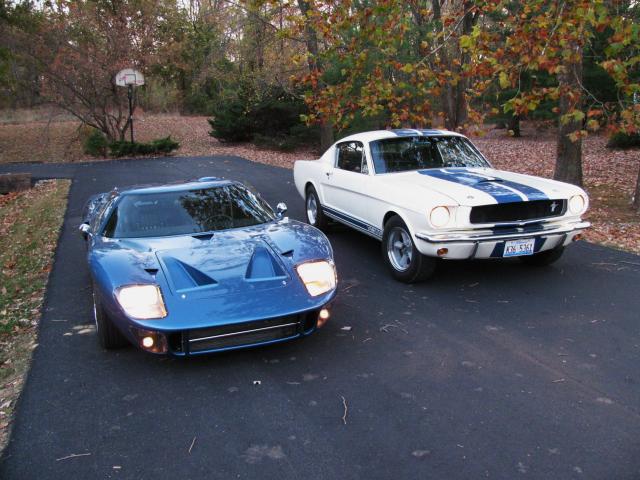

Have not posted for a bit. Been busy building the 'stang. It is now running and lacks only a few minor details. Got a few projects for the GT40 which hope to get to in the coming weeks.

What an outstanding looking Mustang. How about some more details?

Mustang GT 350 Clone
Jim: per your request, a few details.
This was primarily Ryan’s project. It started as a bare chassis in March 2010. The goal was to build a replica of a 1965 GT 350. Ryan thoroughly researched the project and we went to great lengths to make it as original as possible with just a few non original upgrades to make it a bit more driver friendly.
Front upper control arms are dropped half inch per Shelby’s original. Traction bars added to the rear axle (a major project ). Center dash pod with tach and oil pressure gauge per Shelby. Wood steering wheel. Rear seat deleted package tray added, spare added. Battery moved to trunk – all per the original. Paint scheme, markings, all per original. (Wimbeldon white and guardsman blue).
We learned more about body work than we really wanted to know. We did the body work including primer, learning as we went along, then had it professionally painted by Ray Maserang, who also painted our GT. He did a super job.
We found a complete 1965 coupe which was a total rust bucket, but it was complete. Bought it really cheap and used it for parts – like the seat frames, heater box, and wipers. It was also a good reference when we did not know how something was to go together. Sold the carcass just this past weekend – sure glad to see that thing leave the driveway!
It is amazing how many parts are available for these Mustangs. We have a 45 year old car that is essentially new.
We estimate about 1500 hours in ten months for Ryan and me, not counting research and gathering parts. It will be nice to get our lives back . . . . until the next project!

I'm not a big fan of American cars but that mustang is beautiful.
Jealousy is a terrible feeling, but I envy your skills.
