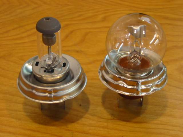

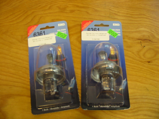

The RCR GT40 uses Neolite brand headlights. We were never very impressed with their illumination, but we don’t drive after dark that often and the separate halogen driving lights work well, so it was not really an issue of concern. But a burned out headlight would provide an opportunity to look a bit deeper into options.
The stock light is an incandescent Jagan R2 bulb rated at a whopping 45 watts. It looks like a ping pong ball. A bit of online research revealed that an exact replacement is hard to find. They are out there, but you won’t find one at your local Autozone, Jegs, or Summit.
Fortunately there are halogen bulbs that are exact replacements. We ordered four from Interlight.biz. https://www.interlight.biz/light-bulb/O-64198. Specify model O-64198. It has a P45T base. It cost only $7.00. (We ordered four so we would have spares, one of which proved defective.) There are similar bulbs available in different wattage ratings. We opted for 55 watt rather than the higher wattage because halogen lights run hot and we did not know if the light housing was really designed for a lot more heat than the stock incandescent lights generated.
Replacement is straightforward. Note that there is a tiny detent on the bulb base that lines up with a notch on the housing.
When we wired the car separate relays were added for the high and low beam circuits, so there should be no issues regarding the current draw of any replacement bulbs.
The halogen bulbs are a big improvement. The light is much more white. The beam is more sharply defined and brighter.
