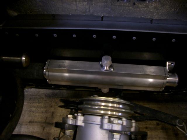

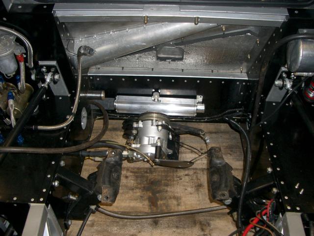

Following my recent engine failure I decided on a laminova cooler. I guess it's very hard to quantify exactly what type of cooler is 'best',... I'm sure oil/air works fine but I decided on oil/water heat exchanger.
Personally I felt the only decent cooling airflow thru the car is thru the nose & therefore this is the best place to get rid of heat. My water radiator works really well & I'm confident It can easily handle the extra 'load' placed on it by the exchanger.
Secondly, packaging..... fitting the exchanger in the engine bay (it's getting pretty busy in there!) the largest laminova C43 series is a nice fit against the bulkhead in the GTD. I'm part way thru fitting it, but will post more picture in my build thread http://www.gt40s.com/forum/gt40-build-logs/23267-gtd-restoration-completed.html when it's finished.
The exchanger is fitted in the water return pipe. I guess the water running thru the exchanger will have been cooled by the radiator. Altho the water will then carry the heat back into the engine I guess at the end of the cooling cycle the rad disperses the heat to air.

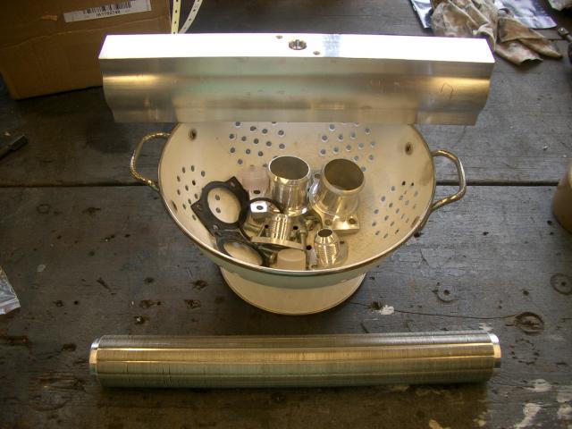

I managed to reduce the high cost of parts by using a s/h exchanger. The laminovas are easy to strip an clean as you can see form the pictures. Also I found it's well worth hunting around for prices on the oil pipe fittings. EG I was quoted 28+VAT for a -10 elbow in the UK (over 60 dollars!), whereas at Summit an Aeroquip -10 elbow is just 17 dollars!! Rip off Britain I guess!
Once it's all complete I'm really not sure how I'm going to guage the efficiency of the cooler/exchanger. I'm not keen on going to the extent of data logging or even where on the dash I would be able to fit an oil temp guage. Will cross that bridge when I come to it!
The pictures progress to date....
