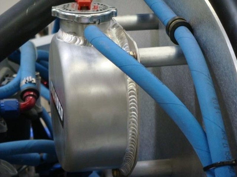

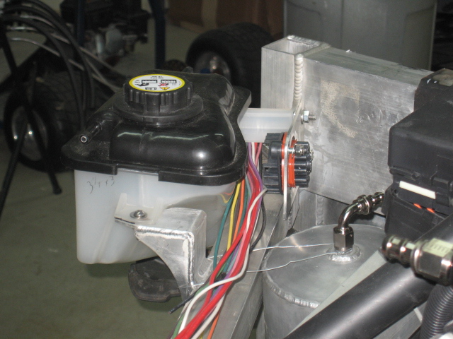

The Dorman Tank

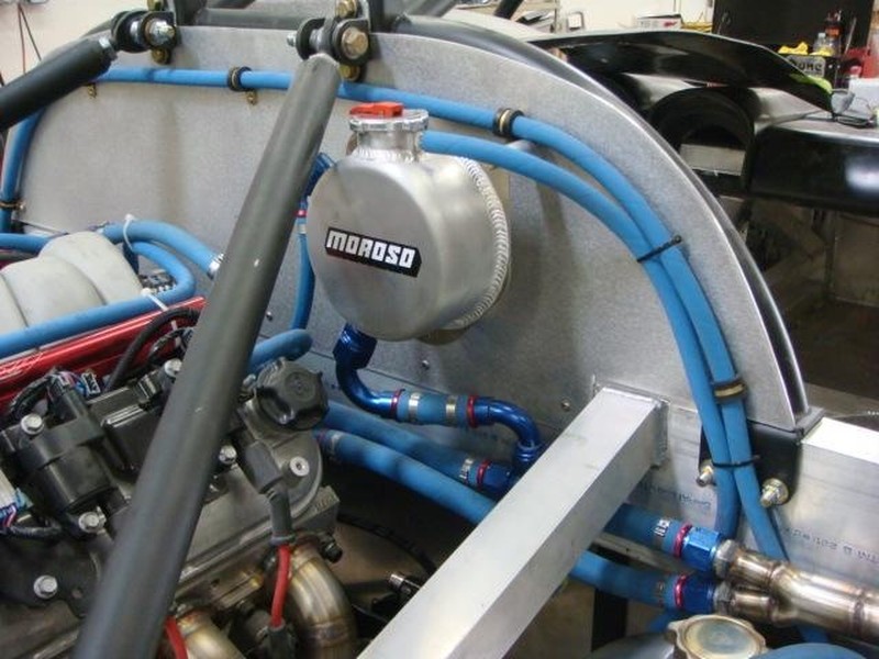

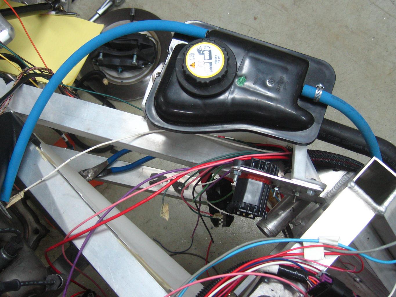

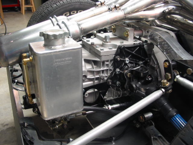

Alex: I was planning on copying the placement like in the photo below. I think this is where everyone else is putting it.

Here are the hook-ups on the chassis, perhaps Wayne can post a pic or two:
Dorman coolant tank
to mount tank, go as high as you can with the spyder in place so you can access the tank cap and close the rear clip. Two brackets needed.
trim off any protrusions on the tank that get in the way.
connections:
the bottom of the main drivers side coolant tube requires a straight one-inch spud (long enough to get a hose on) that goes to the one-inch connection on the bottom of the Dorman tank. they use a straight piece of one-inch ID hose.
there are two 3/8" connections on the tank. the front one goes to the drivers side radiator bleed fitting on drivers side. use a 90 degree fitting on the radiator.
the rear 3/8" fitting on the Dorman tank goes to the steam vent line on the engine.
