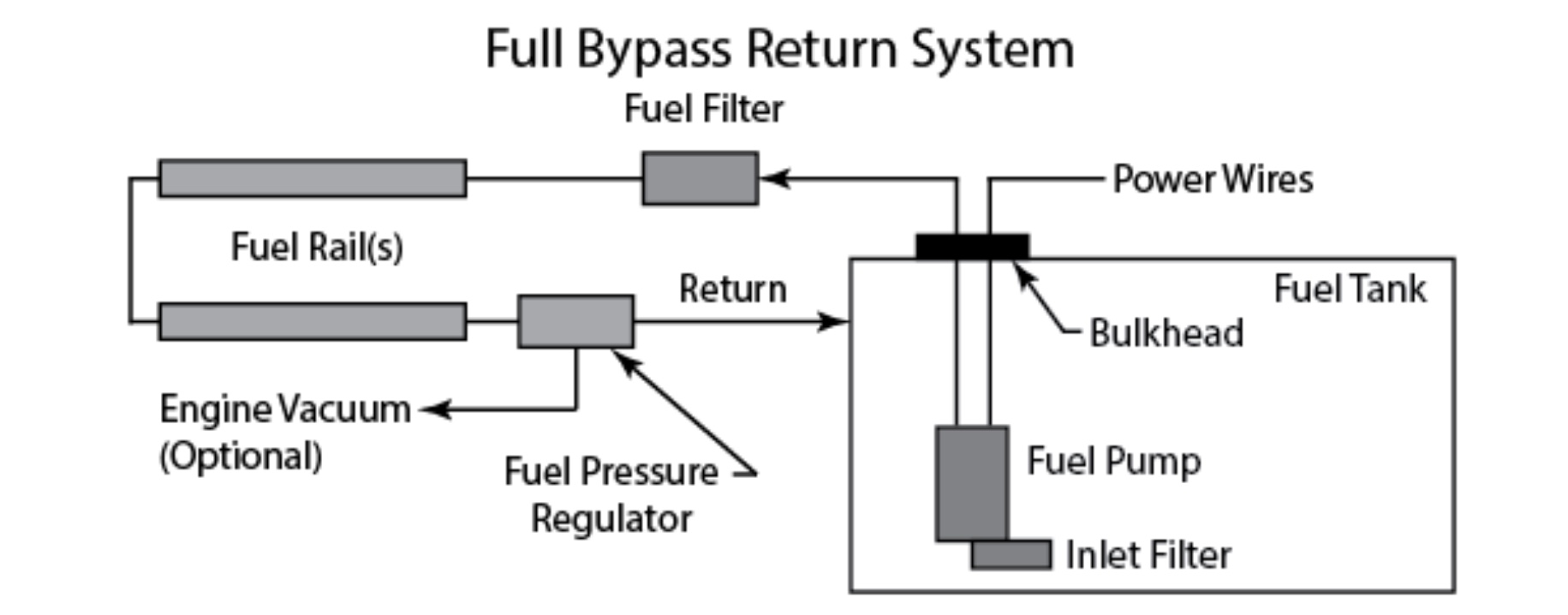

Doing more research I found this. I need to use a return system so this is what is recommended.
Two questions, 1) how would this work with two tanks and 2) what regular would you use?
Any insight would be helpful.

What I did was this,its been going 9 years with no issues.
I made the tank on the drivers side shorter, I have a small tank behind this tank that holds about 15 litres.
Each tank has trap doors to stop the fuel moving towards the front under brakes.
The main tanks have a fuel pump submerged ,small EFI pumps.
They pump to the small 15 lt surge tank, this has a 500hp walbro submerged pump.
The reg is mounted at this tank on the surge tank and the excess is pumped back into the surge tank , I have a spill line at the top of the surge tank and that spills back to the main tank in front of it.
Fuel is hot when it returns to the tank if sent to the engine, if returned early as I did you keep the fuel cool.
I have a 19mm hose linking the 2 main tanks and it evens the level out.
I only have a level sensor on one side.
I did it this way because it it is less complicated and to be honest it works fine , I track the car with no issue.

My tanks are already made and they don’t have doors, but your system may still work.
Any chance you could draw what you did and post a picture of it?

I had one of the original Ford GT40 Mk2's, vin1012. The system on that was 1- Use a cross over line between the tanks to level them out. 2- Internal surge tanks on both tanks to prevent starvation. 3-pumps/filters on each tank to single regulator. 4- Bypass/return lines to either tank, they will self level with the crossover line. This worked fine with the 427 motor using (believe it or not) 4 weber carbs at 8000 RPM. I like your choice of engines. I'm going to use a Coyote my SL-C. Twin turbo and maybe go to the Voodoo version with the flat plane crank. About 750HP in street tune and 1300HP if I get STUPID.

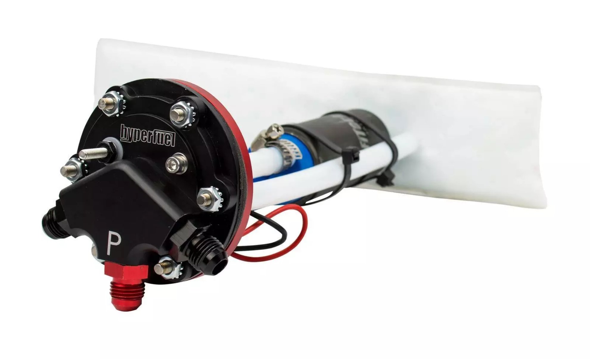

There should be a crossover line between the 2 tanks in the design per chris unless that is something he is doing now. Then use an intank pump assembly like the unit you have picked out. Several companies like Holley, Fitech etc have them that are internally regulated. If you buy this type no return line is required. This is how i plan to do it. Then there is only 1 pump and 1 fuel line.

Everything I read when using a new Engine Control Pack, says that you need a return line.
Maybe I’m just over thinking this.
Normally you would however if you buy the fuel pump system with it built in then you are all set. The coyote requires 55 psi I think. I have seen the pump kits availayin 58 and 60 psi. Either will work. More than likely you will need a custom tune anyway with your intake setup. So fuel can be adjusted then

I was looking at the fitech also.
So an internal pump, in-line filter and no return?
That should do it?
Then all I’ll need is a crossover line.
Does that make sense?
I would get a fuel filter. The unit has a sock on the bottom but would add a filter after the pump Incase something happens to the pump it would send trash into the engine if you didn’t have one there.
Summit sells efi fuel filters that are 6an in and out to match the pump. Then they have the fitting that will attach to the ford fuel rail if needed.
Mark
