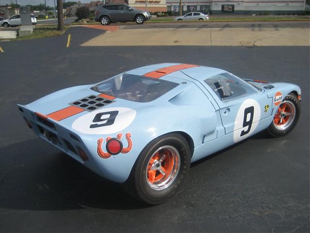

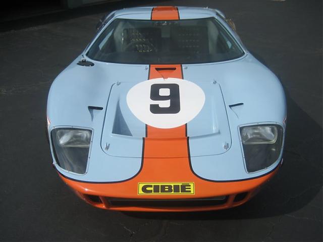

Here is a car that an RCR customer has built to fantastic standard....note the attention to detail on the Le Man single filler and doorhandles....also the FIRESTONE tyres.....
Outstanding job....

To your knowledge, is the Corvette in the 2nd pic a replica as well? It sure does look similar to the one raced at Le Mans in '67...

Hard to stop looking at it..
A couple of things that come to mind;
It does not appear that the hips have been flared - but it may be the camera angle / lighting.

The rear has been flared 2 inches each side...

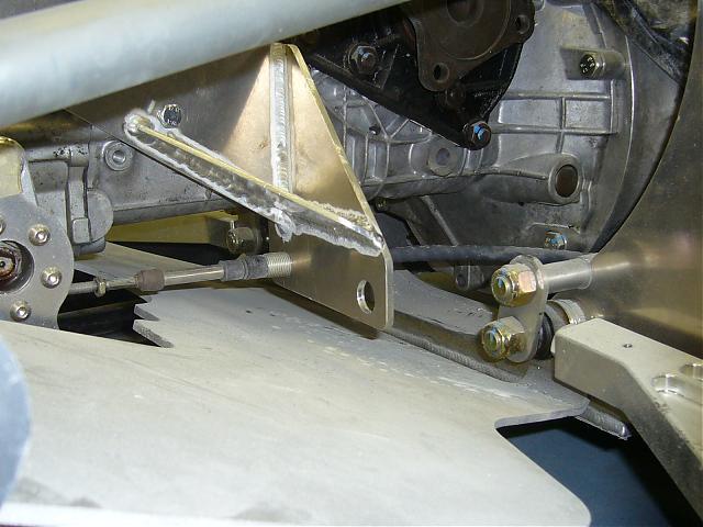

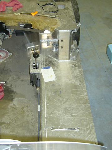

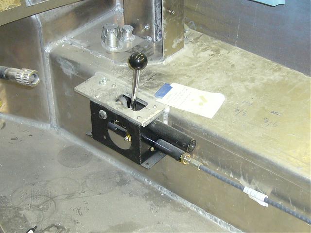

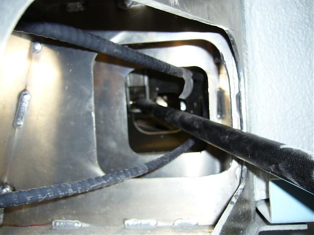

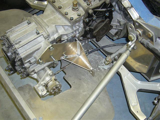

Here is the box mock assembled, with one of the cables in place. Also mounted up the bracket I fabricated just so you could see the intention. I may have gone a little overboard on the bracket....but I know the darn thing won't have any deflection...:D
The last pic is of the cable routing through the frame looking forward toward the bulkhead.
Let me know if I missed any views of interest boys....

Thank you Sir....
the shift box can also be mounted by the base if required....hence the two lower tabs....
