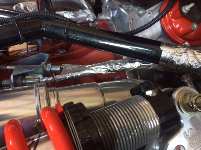

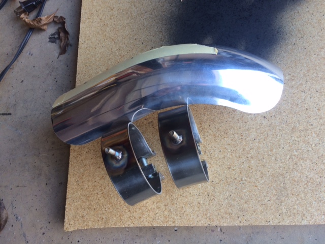

I’m still in shakedown and have a few clean ups. One item was to ensure the shift cables are not cooked by the exhaust system. You can see in the first picture I wrapped the cables in several layers of heat shielding, and ceramic coated the exhaust system. Now that combo may be enough, but not being totally convinced, it didn’t end there. In picture two, I took a 4-inch aluminum air induction tube and cut it to the size you see (lots of waste). I took stainless exhaust clamps and welded the studs on top as shown. I wrapped the exhaust bands around the exhaust and mounted the shielding on top, heat shield. Now it may not be the perfect solution, but I know its diverting exhaust heat away from my cables, so I believe they are protected as best as I can get them.
