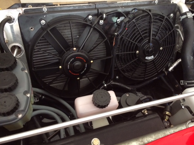

Here is a pic. The diameter was exactly the same so no mod to the hole. The mounting tabs were different so four new nutserts to hold the fan. Its taller but that wasn't critical for me. My wires are not tied down in the pic yet, but you can see the difference. Straight blades vs curved. That thing flat pushes some air. I can barely feel any air on the outside of the radiator on the stock side, but on the Mishi side I can feel the suction. Impressive so far.

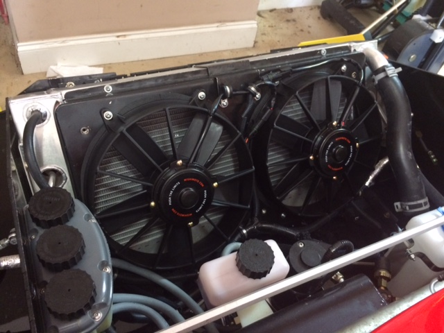

Well finally got fan #2 and installed it. Yes they are much noisier than the stock ones but the amount of air being pushed is significantly improved. Talked to the company who builds our radiators and they told me the stock fans were designed for up to 400HP. Most of us are much higher than that, so you can do the math. They encourage a shroud and see benefit to building a heat extractor along the lines of Cams. Anyway to get the heat out from under the front hood (another next project to do). I keep telling the wife, these things are never "done".
With the ambient at 88, AC on, slow neighborhood drive with engine at temp
, it held steady just under 200. Next test will be at higher speed.

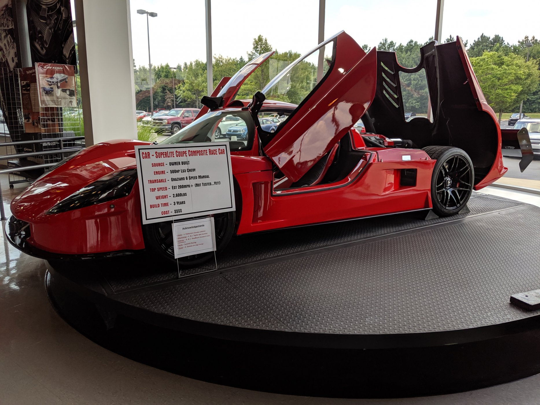

I believe this may be the first SLC featured at Summit Racing. Anyway after the Summit Motorama this past June, Summit asked if I was willing to feature the car at their McDonough Georgia retail store. So for all of you who have spent as much money as I have with the Summit. The car sits on a turnstile which has to be balanced. It will be on display thru 6 August and will be a part of the annual on site LS Fest hosted by Atlanta's Vengeance Racing.

Well after 30 some days on display I finally get to bring the car home from the Summit. Got a few things to redo and have been talking to GM about the 480 engine controller. We are all very confused by the P0606 code it thru and yet it operates. Got to experiment and figure this one out. A new shifter and nose hinges are on the bucket list of upgrades....perhaps Santa is listening...hint hint. Lol
Vengeance racing of Atlanta hosted the 6th annual LS Expo while my car was at the Summit. The car won people’s choice award, so not a bad showing.
