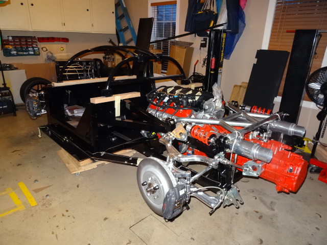

Day 43.
Engine: Engine installed into frame with Graz attached. We had RCR fabricate the exhaust (excellent fit BTW) and then took the exhaust manifold and exhaust system out for ceramic chrome treatment. Based on my experience with ceramic coatings, it not only preserves the system, but has a noticeable drop in heat dissipation (no scientific proof, just the good old laser temp check on our Corvette, before and after)
<?xml:namespace prefix = "o" ns = "urn:schemas-microsoft-com<img src=" /><o:p></o:p>

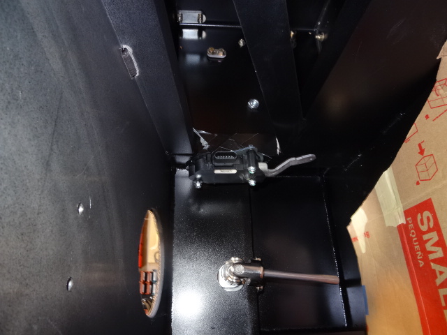

Throttle pedals: Based on reviews and recommendation from other builders, we plan to mount the GM throttle on the same mechanical plain as the Tilton foot pedals (simplifies the activation geometry). We will use the RCR supplied bracket and secure it to the square vertical in the center of the foot well. Since the brake lines are now external, this space is freed up to mount it there.The geometry of the Tilton throttle action and the GM throttle is more in direct alignment. (Only taped on in picture)<o:p></o:p>

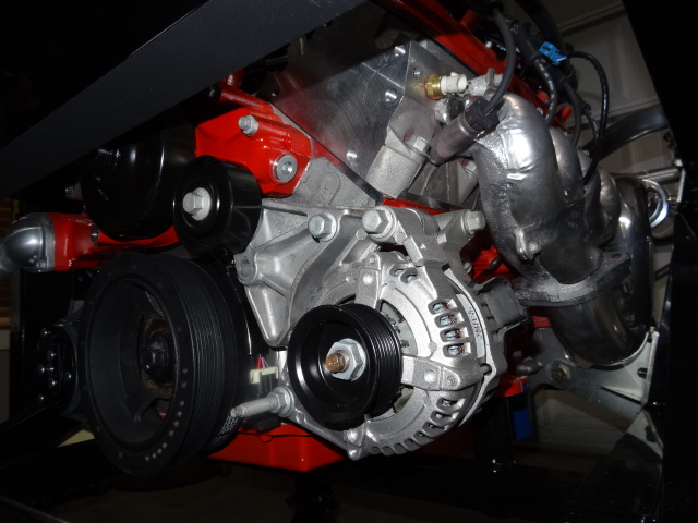

Alternator: There are several excellent options for the alternator install to include the RCR solution, Pontiac G8 and Cadi CTS-V, we chose the Cadi solution (25266345). The main driver (and maybe overkill for some), is the third mounting point for the alternator.That being said, we are using GM harness/controller 19258267 which is a single wire alternator control wire.In discussions with GM Performance, they advised the addition of a 50 OHM 5 Watt resistor be added to this wire in series to support the hookup. The alternator is a two pin receiver, a four wire plug and a single wire control.Lots of discussion about alternator solutions, so it boils down to preference I guess.As soon as the belt tensioner bracket arrives, we will complete the engine front end with a revised serpentine belt.<o:p></o:p>
Brakes: Final line routing on hold pending pictures from RCR.Hope to see those once everyone is back at work. It will validate the intended layout before drilling and mounting.

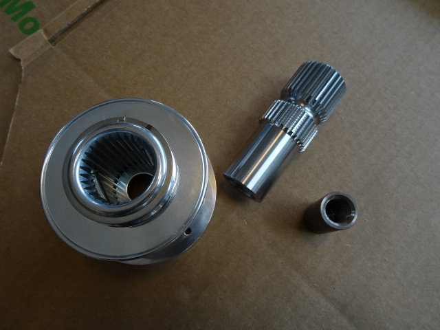

Gents
Trying to mount the steering wheel/adapter to the steering column and discovered the column I received (PN 26074674) is from a 1999 Oldsmobile Intrigue. The adapter is way to big for the shaft. How did you newer builds solve this?
Since this column is so old, where did you find parts, horn relays etc?
Does any one have a wiring schematic for this column?

Hopefully, you won't need parts for the column, but new ones are still available (around $325), and junkyard columns are even cheaper (around $75).
Horn relays aren't a part of the column, and are almost always just standard auto relays available anywhere.
There is a link to the wiring diagram on the wiki.
I assume the factory shipped an adapter for the earlier columns. Assuming the column has a standard GM spline (as it should, given the era), adapters are plentiful in the aftermarket.
Re: Steering Column - Oldsmobile 26074674
The column uses an adapter just like the xlr column we used to use
A thread on "slug" that then gets welded to the quick disconnect spline
All shown in the build manuals and wiki

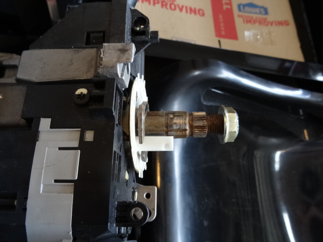

Will and Fran

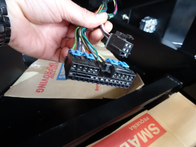

Ok fellas, I need to be lead by the hand please. I dug into build manual 2.4 "steering" and I must be missing it. Is it in another section?
Anyway, below are pictures of the parts I have and the steering column (Will, were did you find new for $325, this one is pretty rough, used stuff for a new SLC, hope not) The Wiki addresses the XLR steering column to include the XLR wiring diagram. Attached is a picture of the Pontiac plugs. I do not see a match. Will they mate with ISIS?
If I figured this out right the small gray "slug" threads onto the end of the steering shaft. The "slug" welds to the long silver geared adapter in the picture and of course the steering wheel is attached to the "tubular" piece.
Is that the intent? and I don't have a welder available today...darn.

You don't have to weld them- pinning is another alternative.
The wiki points to a resource that has all wiring diagrams. Look there for the Intrigue column.
Look up the part number on the web to find the new prices- that's what I did.
-Will

It's a standard technique for machining, and automotive purposes. Just pick the right size pin, and drill the holes carefully.

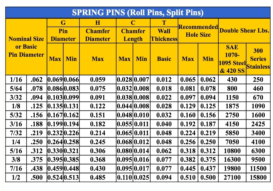

I'd double pin it, use a reputable spring pin (90 degrees from each other ) from a McMaster or equiv. seller (not lowes or box store) Use the attached picture/chart for sizing.

Its going to be hard to find a good place to drill based on the location of the splines. Also need to make sure not to interfere with the threads on the steering column itself so that takes up a lot of real-estate.

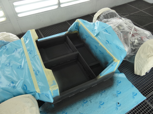

Day 44
Took frame to shop today for full SPA treatment. Doing any sound and heat treatment is certainly better than nothing, so we elected to spray both sound and ceramic heat treatment on critical areas.
