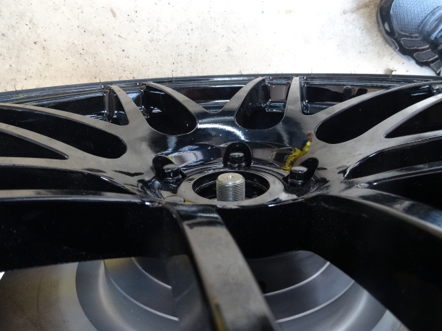

Here is an alternative solution to the now longer wheel hub:
1. 1st picture: The issue I found with the Forgestar Wheel is the axle sticks out past the wheel hub.

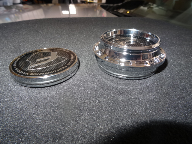

2. 2nd picture: Compare the flat Forgestar cap to the deep well Forgestar, it covers that extended hub $30.00

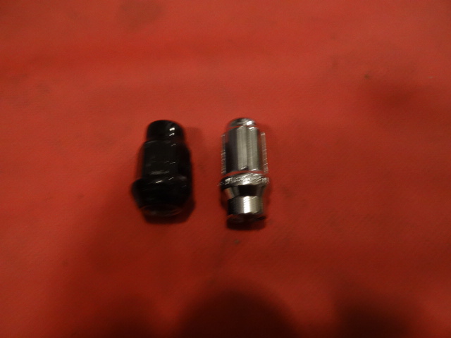

3. 3rd picture: Lug nut length: As mentioned the prevailing wisdom on how many threads is the MINIMUM to grab with a lug nut was as many as the diameter of the stud (about 5.5 for the 12 x 1.5 stud we have). Without replacing the studs, I discovered that extended lugs gave me an additional 4 threads beyond the lugs provided....that's nearly 63% more thread for only $24.00. These lugs are closed end and they work fine. Gorilla/Summit have both the acorn style and the slim fit you see in the picture.

Re: Long axle - Spindle Covers for Forgestar Wheels
Save yourself a lot of hassle, and simply trim off the excess axle spindle with an abrasive cutoff wheel.
It's 10 minute job.
I used to work for a tire shop many years ago, and they used a minimum of 4-5 threads. For a car like the SLC though, I would go atleast the width of the stud as your minimum thread engagement.
Scott
I failed to mention I went from the minimum 5 to 6 to over 9 threads. So I was ok, but wanted more grip. The extended lugs gave it to me....:thumbsup:

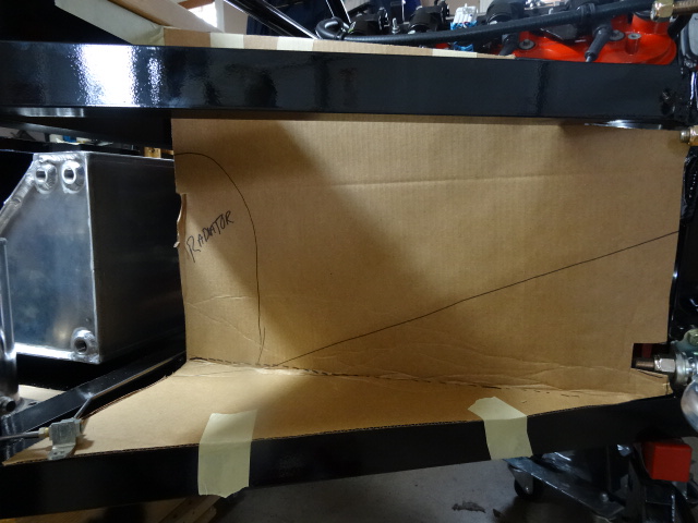

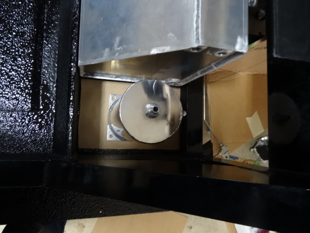

In following the many fuel system installs, I see many of you managed to fit your fuel system into the space next to the fuel tank. In looking at the pictures on some of the more mature builds, sure seems those tanks are smaller (seems like mine is 6 inches longer). Take a look at the picture of my swirl pot sitting in the available space next to the tank (I have 7 inches of space). With two pumps, two filters, shutoff valve, regulator and swirl pot or no swirl pot, Houdini would struggle to get it in there all nice and tidy.
So if (picture 2 cardboard), we added additional real-estate via some plate and allowed for the cooling tubing etc. Apparently ISIS prefers for the battery in that spot as well, but I see no way. What issue or trouble will we run into that we haven't thought of yet? :huh:

Re: Is there a larger fuel tank now?
Dan
Several of us have extended the "floor" to the end of the rear clip, making an "H" shape,
cutting out under the engine. Vertical panels can also be easily added. Large spaces to hang stuff.
For serviceability, I would recommend putting as much of that on vertical plates outside that area. I believe Fran now offers that as an option?
There are a couple of great surge tanks available that incorporate the second pump in the surge tank itself to save on fuel line plumbing and real estate use.
I recommend that you soap/pressure check the tank for leaks before use. A couple of us have found small leaks at the welds.

there's enough room I have my swirl pot, two pumps, two filters and about 20 Aero motive fittings and hose in there. just takes a lot of planning.
