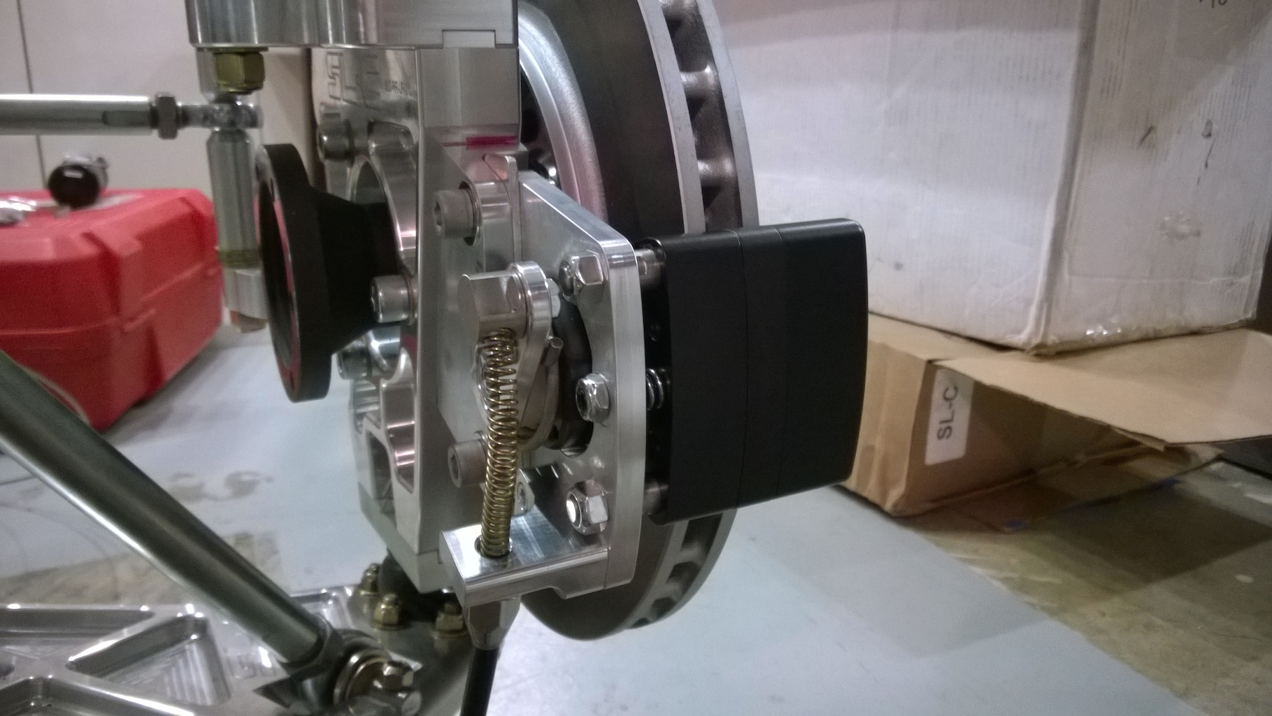

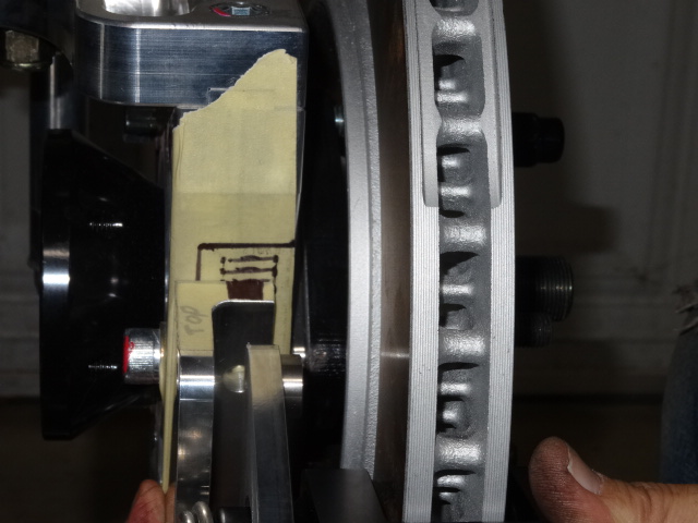

Hi Dan,
Mine is exactly the same as yours. I ended up making a 1/8 spacer to allow the bracket to move inboard a little, but the bracket bolts still came through the milled area slightly. There's also some adjustment to the parking brake caliper to move that helps it slide over a small amount.
Here's a pic of the spacer / placement I went with. I can't find a pic showing where the bolts came through because the rotors/calipers are all torqued down at the moment. Overall I wasn't worried about it since there's a lot of thread engagement on the bolts.

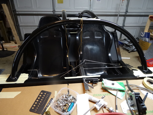

Gents
Went to mount the roll cage today and found it is not centered. The back and the two "roof" bars are OK. The front arch was welded 3/4 of an inch off center left to right. The bottoms of the two arch tubes measure 9 inches, and the other 9.75 inches to the edge of the frame rails.
To get a good install on the main body and subsequent interior parts, where is this going to create problems? Is this enough out of tolerance it needs to be fixed?
I used a plumb bob from the center of the two "roof" roll bars to the edge of the tee square as shown to validate the rear and over head is square. The only item left was the union of the arch to the roof roll bars.....it is not centered.
Re: Roll Cage not Centered - A Problem?
Dan
The cage is not actually off by 3/4 " only 3/8 off using your dimensions as its 50/50 split...and this is not unacceptable at all.
There is plenty of room to scoot the roll cage around, loosen all the bolts and position the front feet of the cage where you feel you like the fit...you will find it centers quite nicely and easily...
If you take the time to look at the scenario you will find it fits and the clearance is just fine...
I'm a pilot, we like symmetry.....:wings:
With a push, I can get it much closer.....life is good.

Fran
Did RCR have any success with the E-brake supplier? Is there an updated bracket to support the hub mounting with milled surfaces.

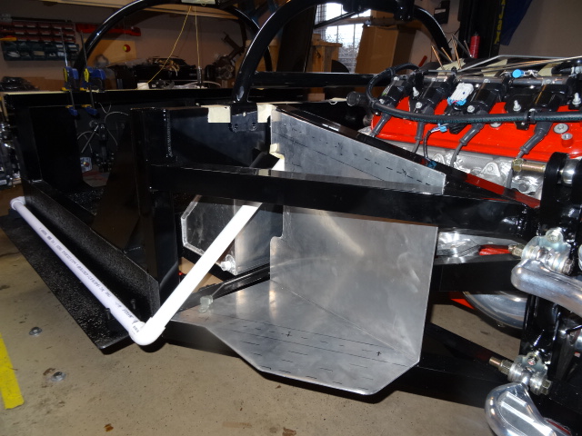

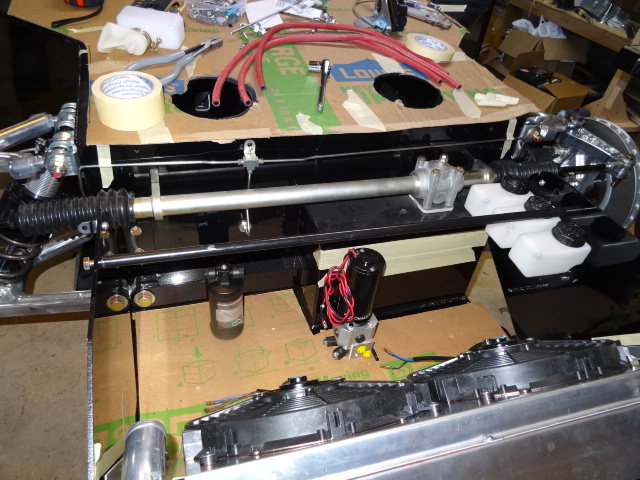

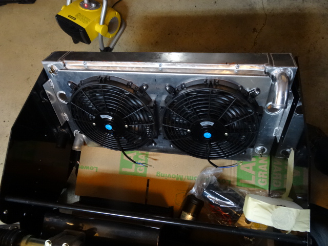

Day 73. Taking more time to get stuff than I expected, so progress slower than I want.
1. After two prototypes, a final fan shroud was completed.

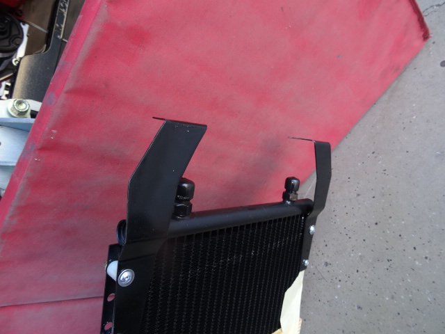

2. New brackets were made for the air-conditioning condenser as the OEM brackets did not engage the front to my satisfaction
3. Fabricated plates to accommodate the fuel system and the battery box
4. Radiator lines mocked up in PVC getting ready for welder
5. Seat rails and seat positioning finalized for wife and myself (yes she will drive it)
6. E brake brackets have generated a lot of discussion since the improved hub supports are now milled. RCR making inquiry with supplier to determine correct bracket to mount. Current bracket does not allow complete engagement of non milled areas. Drilling on hold.
7. Tried several brands of tools to flare stainless steel brake lines. Finally spent a few bucks and bought the Eastwood Pro flare tool. Made a perfect 45 flare on the first try...a great tool. Working to finish brake line layout.
8. Trying to ensure I do not violate the space requirements for the new front sway bar design. IAW RCR, it will run on the same horizontal plane as the brake line. So here's hoping I don't mount anything that gets in the way.
9. Talking to interior designer about interior options this week.
10. Wiring and fuel system completion next. Tank pressure checked good.
11. For those still debating fuel lines, take a look at a new corrugated PTFE stainless braided line by Goodrich. It accommodates all fuels, has antistatic carbon, and a bend radios of under 2 inches for -6 size line. Very expensive but since engine and fuel system are so close, you don't need that much.
