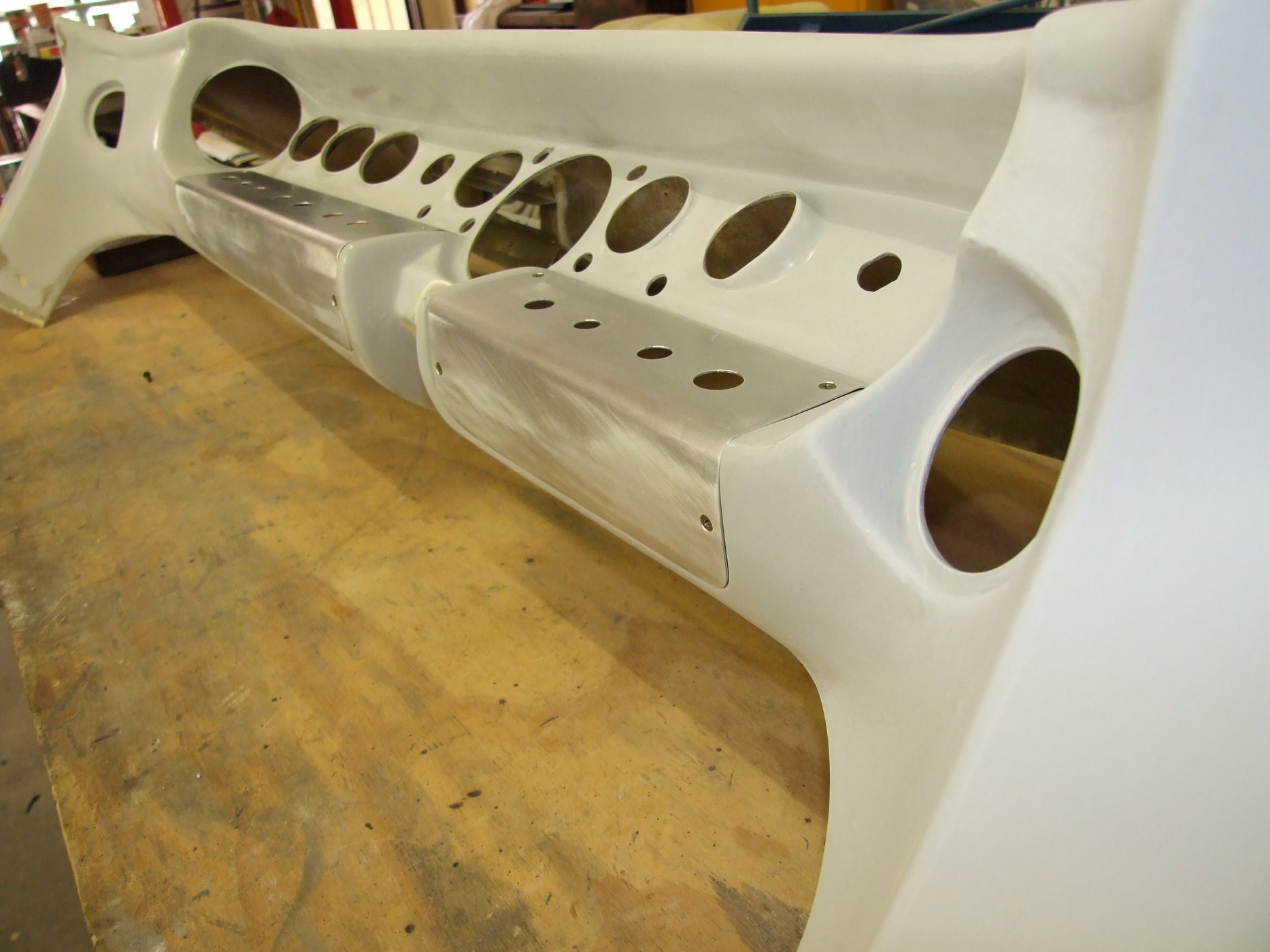

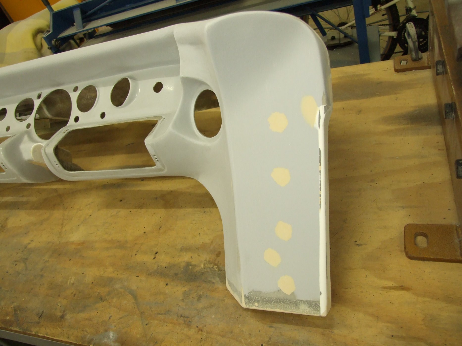

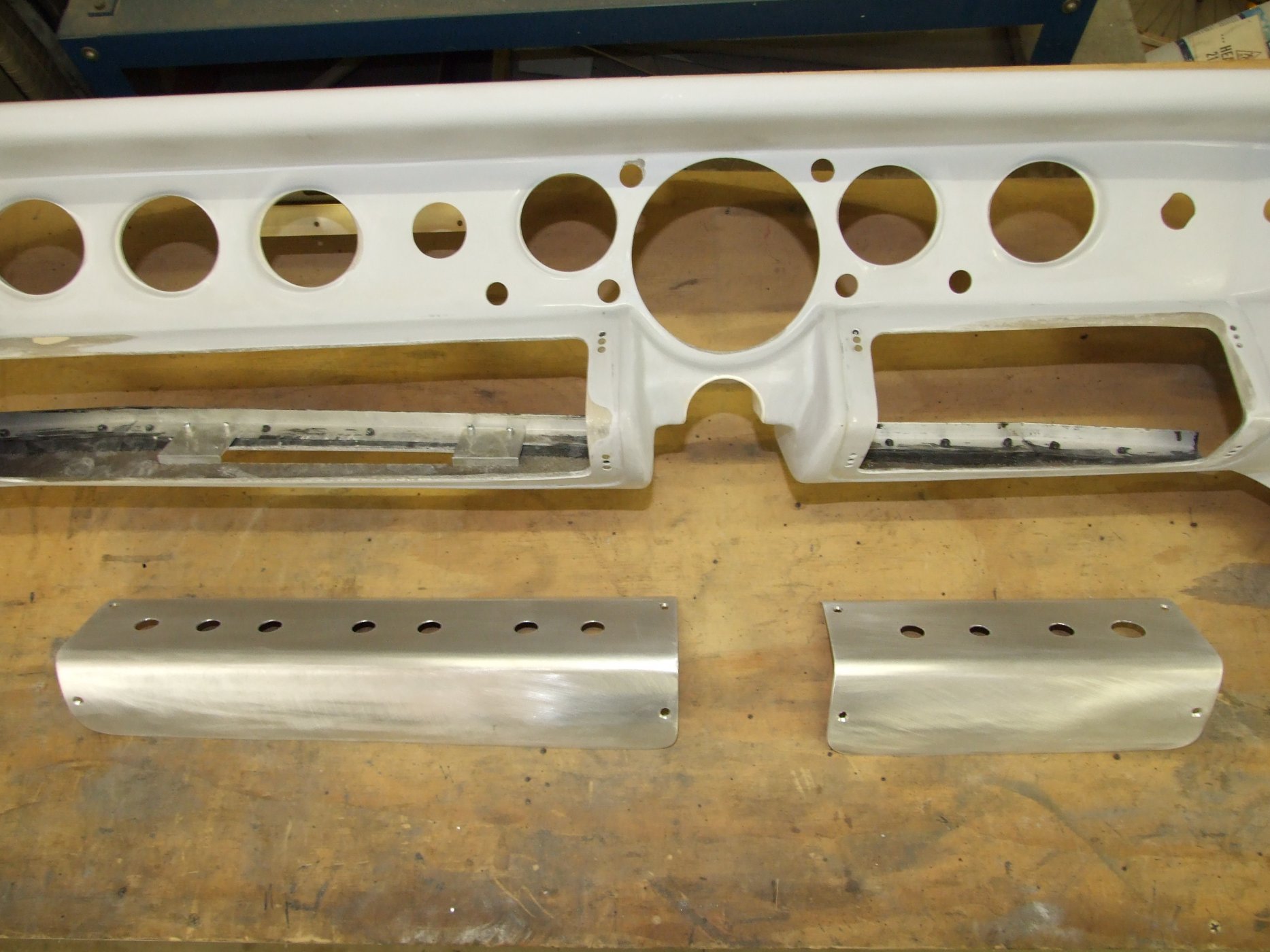

Hi Bernie
I cut the return off the bottom of the dash and added angle extrusion to the inside to keep the rigidity.
Also added 6mm to the bottom of the dash legs to raise it up. This allowed the steering column to be raised for better feel and more knee room.
Cut out the switch panels and folded up ally plates.
