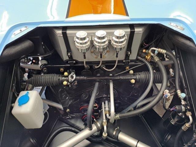

Ryan , Here's a picture I received yesterday of the reservoir's along with forty others of the final inspection. Should be headed this way soon. Looks like they made nice mounts to the evaporator box not sure how they used to be but seem to remember people changing how they were. Thanks..

Ryan , Here's a picture I received yesterday of the reservoir's along with forty others of the final inspection. Should be headed this way soon. Looks like they made nice mounts to the evaporator box not sure how they used to be but seem to remember people changing how they were. Thanks..View attachment 128806

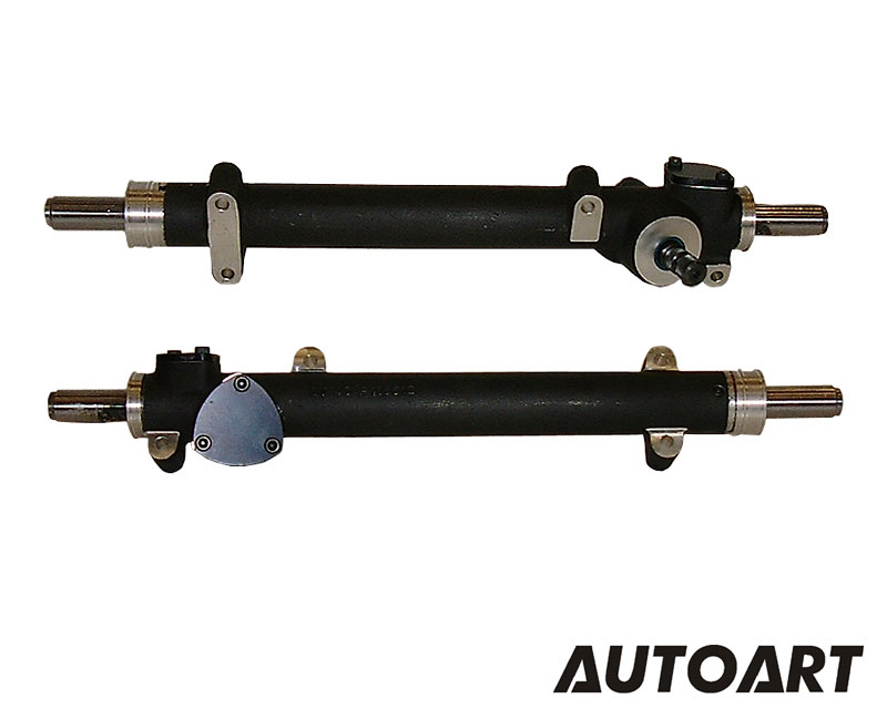

Hi, thats a very interesting photo. Any idea why there is an MGB steering rack fitted, and not an original style rack?

Not sure the difference? Right hand drive?? When searched I could only come up with left hand drive racks and the appear similar.
This is a Gelscoe, big difference in rack.

The MGB rack is used to reduce costs. The original type rack is used in the "Tool room" cars. The MG rack has brackets that mount to the original mounting points so the Cam Gears magnesium rack can be installed if desired. The brackets place the MG rack in position for proper bump steer. If desired, the Cam rack can be specified optionally. Remember, the 289 and 427 Cobras used the MGB rack as well!
Strange that a £100 reconditioned MGB rack is used as an argument to keep the cost down in a £300 000 pluss car.
Rick, Thank you for your input. They are not budging on the Gelscoe rack. Also battling the build sheet says Exhaust kit for 302 as P1075 and there base head port design and not Gurney Westlake head port as P1075. It's a Tribute which is the Toolroom car with AC.
Original racks were made by "Cam Gears LTD" according to this thread.
Original bits II | GT40s
Cam Gears limited was renamed to TRW CAM GEARS LIMITED in 1983
TRW STEERING SYSTEMS LIMITED overview - Find and update company information - GOV.UK (company-information.service.gov.uk)
lots of other UK made cars, including the MG portfolio of cars used racks from Cam Gears limited. A lot of the GT40 design features are similar or recognizable from the Cam Gears products.
Would need to check, but I think the original GT40 housings were cast from Magnesium for weight reduction. This could bring with it, certain maintenance requirements if it is to be made from Mg today.
