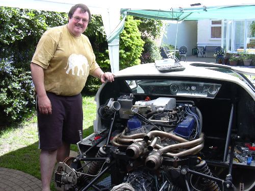

Got the car back from the Exhaust shop
9 meters of stainless steel in the headers!
The shop is so proud of them they are now shown on the home page of their web page
http://www.classicexhaust.co.uk/index.htm
They are willing to undertake more builds if so desired - will also remanufacture from templates / old system.
Now we need to get the oil pressure up and see how loud they are!

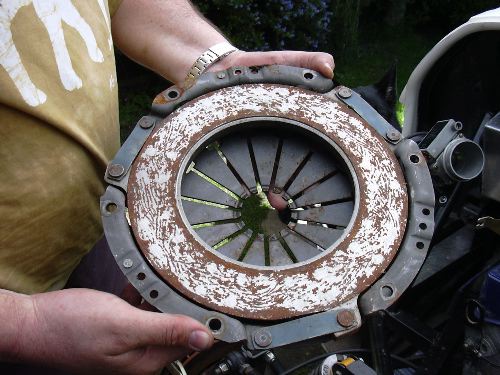

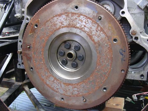

Tomorrow gearbox is coming out as clutch is not disengaging - perhaps stuck after doing nothing for so long
Ian Anderson
Jim
Thanks for the diagnosis - we discovered this today - got the box off and took the pressure plate bolts out - even pressure plate did not move.
Tapped with a hammer and it fell off - scraper under friction plate and it too was off
Took worst of the rust off with a light emery cloth and reassembled.

Ian Anderson
Pressure plate and flywheel - no wonder the clutch did not work
