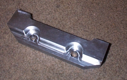

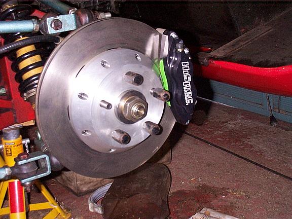

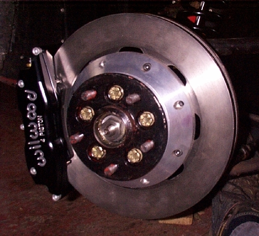

On to the brakes, the Granada front brakes were ok, but forget trying to get any decent balance from the rear Scorpio brakes, as the pads just tended to craze and crack with heat. Checking the piston and pad sizes gave me the impression that they are not capable of providing decent front/rear balance.
The other issue was the servos, which tended to stick on, although I checked and cleaned / polished the air valve, and bought refurbish kits for them, they still seemed to do it. After a spin at Knockhill where the back brakes stuck, and a stop on the motorway on the way to Goodwood when the fronts stuck on big time, enough was enough, and the servos came out.
After balance calculations, and checks on what would fit inside the 15" rims, I decided on Wiwood Narrow Superlite fronts, and Hispec Billet handbrake calipers rear, both with 310mm Wilwood discs, a package which seemed to give a good theoretical balance and leverage.
The rears were the most difficult to fit in since the hubs are designed for sliding calipers and so there is very little space available. but the combination of Wilwood discs and Hispec Billet calipers did the trick. Caliper brackets for the rear were Hispec with my requested offset, and my own design for the fronts. See threads

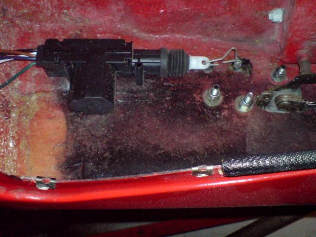

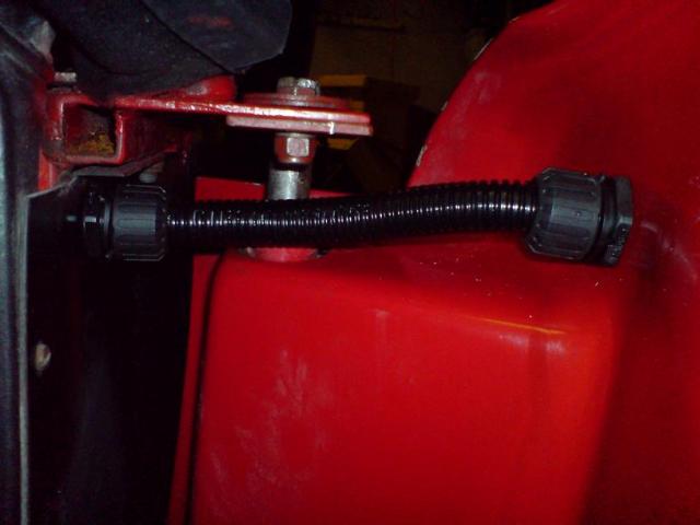

Since the car had no means of locking the doors, I fitted a remote locking system, I have not covered that in a technical thread, but did ask about flexible conduit for the wiring.
http://www.gt40s.com/forum/gt40-tech-fueling-electrics/23962-flexible-conduit-door-lock-wiring.html

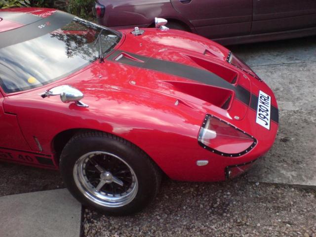

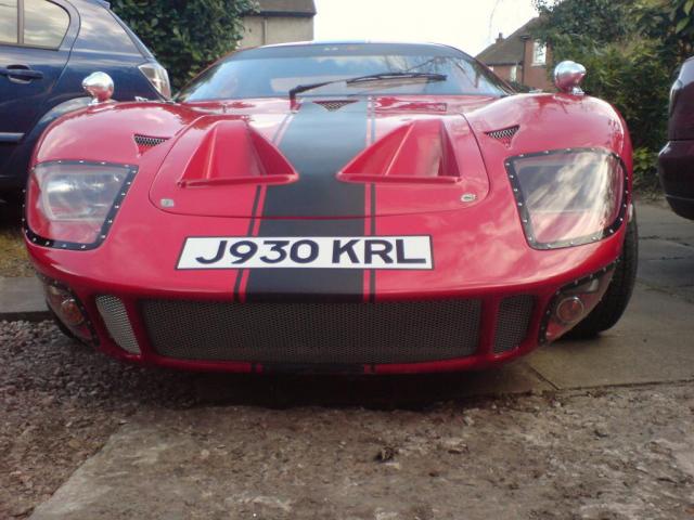

In the last few weeks, while I prepared the car for the road, I fitted traditional style wing mirrors over the wheel arches, and replaced the front body mesh with alloy mesh, the effect of this on cooling is very significant, since the old steel mesh was very tight, and the new alloy mesh is much more open, there is a lot maore airflow through the rad, she now runs at 75degC instead of 90degC and only heats up when stationary.
My 'number plate' was painted on the old grille, but in the interests of moving a little further towards legality, I have put a stick on plate on the top of the nose. While not legal, it is the only real option, and since it has the correct white reflective background and black letter size, and is easily visible I believe it to be legal in the spirit of the law anyway. Any comments?
A dose of Tcut and a good polish, and I am quite pleased with the result of the front end makeover.
p.s should I continue the black stripe down the grille by painting it on ? mmmm

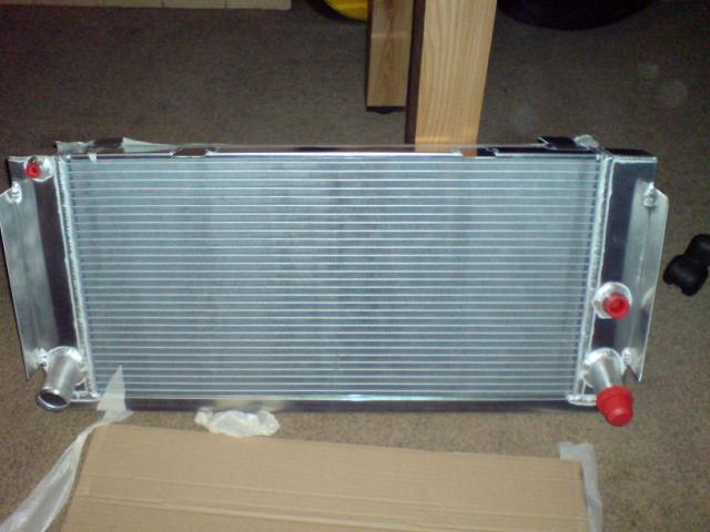

Thanks guys, here is one of my next jobs, already purchased alloy radiator from Dockings, I will fit it in the next few weeks. My current radiator was repaired, but the repairer was concerned about its poor condition. Sure enough it is running on Radweld at the moment, so I had to get a reliable solution for Classic LeMans. Using the advice from this forum I will mount it using rubber mounts to protect it from electrolitic corrosion and mechanical shock.

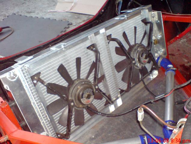

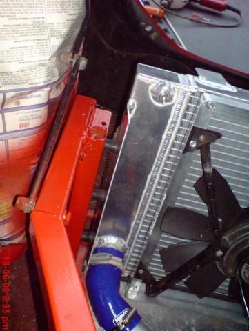

Finally installed my new alloy radiator. I cut away the existing brackets and welded in square tube supports to suit the new radiator, using rubber mounts so that the radiator is fully isolated mechanically and electrically.
The fans were mounted direct on the old radiator, so this time I made a frame from aluminium angle and hung it from the radiator lugs. Pretty pleased with the result although I weld so infrequently that it is pretty messy.
