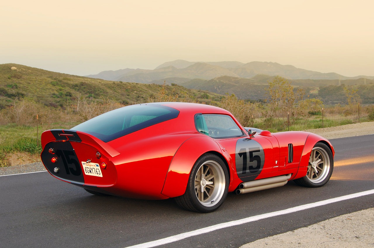

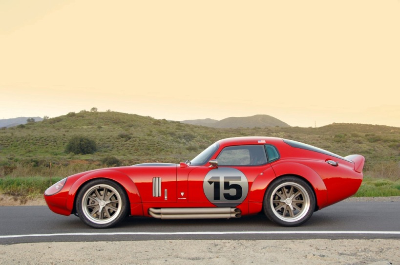

I agree Tom,
This is one of the nicest beasts around, what say you all ?

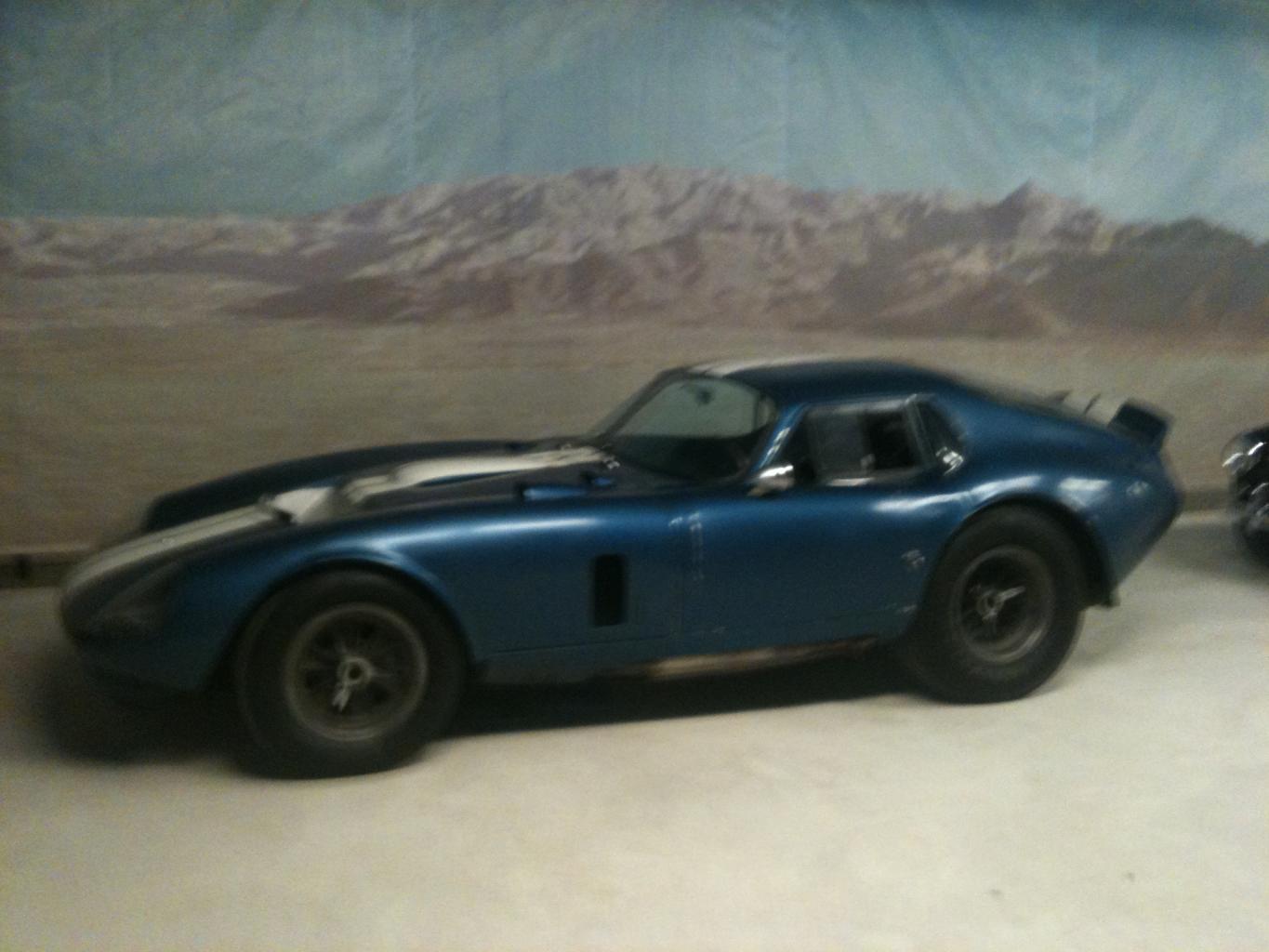

Sorry for the sh#tty photo but I has a chance to tour the Simone collection this week and see the real deal. IMHO I've yet to see a replica that has the raw look of a coupe. The idea that these were hand built experiments adds to the legend.
