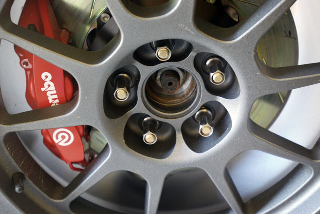

Dean,
Good move to replace those studs. I believe both Alex and I have done that. You can now replace the lug nuts with tall open ones and still have some threads showing.

Dean,
Oh wow those are tall, haha. Do you recall what the part number for them is? I didn't want to chop my studs down to size, but i'm using the 'normal' sized lug nuts at the moment.

Dean,
I replaced my lugs with 12 point M12x1.5 titanium lugs, they show 1 1/2 to 2 threads on the stock lugs. A little pricey at $299.00, but they are a light gray and go well with my black chrome powdercoat rims and the 12 points are tits.
