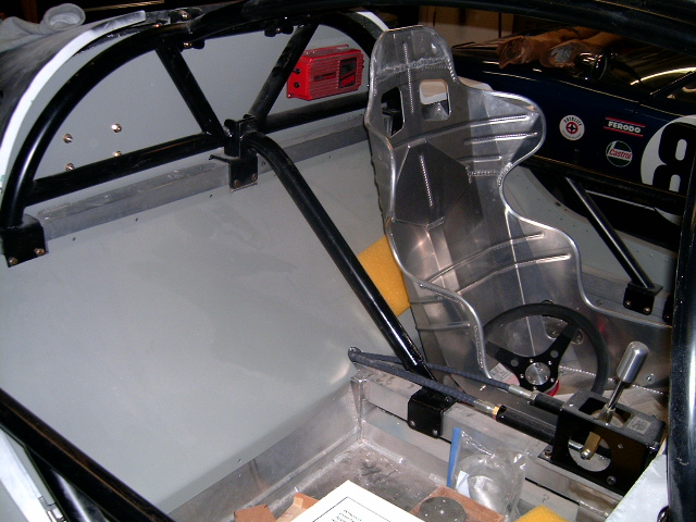

Dean, the 01 car did a nice job of surroundning the drivers helmet. Might make it a bit of a limbo gettin in tho...

I have sat in the 01 car and it is a little bit of a deal getting in and out. I didn't want the full cage for the track day car. I have been in the shop today working on the steering mount and looking at the cage and really trying to evaluate how much is enough. I think its good for a amateur race car. I say that because the GT40 looked like this.
The top side bars are removable. This car was in a massive accident. It rolled twice in the air before rolling 2 1/2 times on the ground before coming to rest upside down. My buddy walked away with bruises where the seat belts held him. The cage did such a great job of protecting him and the car that it is completely rebuilt and ready for the track in the spring. I think the SLC cage is already stronger than the one in the picture.
I really think that if I had a roll over, the cage would protect me. Those are some thick wall tubes. I was surprised at how heavy the cage is when I'm moving it around in the garage.

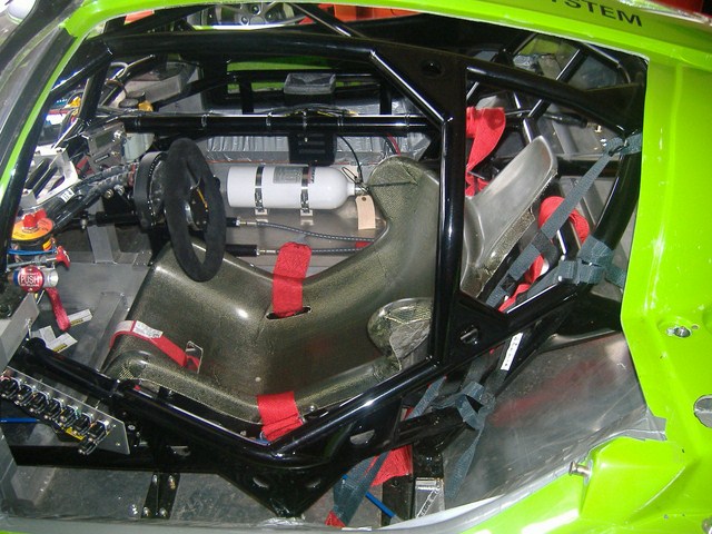

The only one that you don't have in your car that is mine is this one. I like your door bars better than mine but then mine was the first full cage car.

The rear hoop could nave another attachment point at the bottom center like mine and Howards.
I need some of those newer door bars you guys have. I have the older style. Not sure which would be more effective protection in a worst case scenario, but installation without hacking up the door sure is a bonus.
