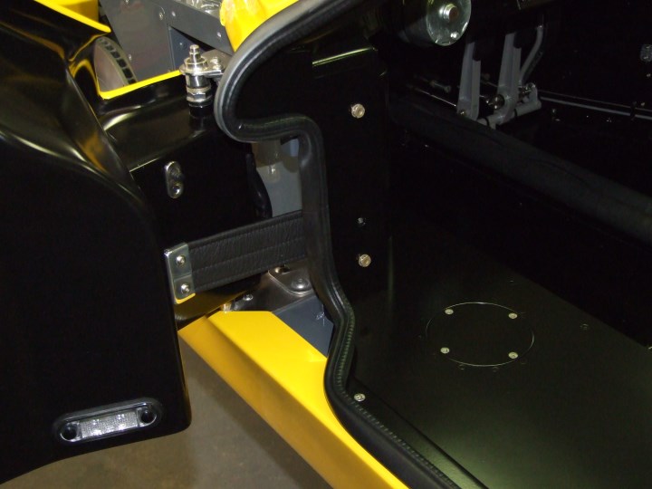

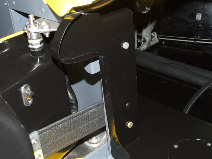

Here is how the DRBs seal the door. Maybe helpful to the GTDs. My tank cover has a lip built in that comes up to meet the door. I don't have any rubber seals on it mainly because I don't intend to drive in the rain, but one can be added easily.
The edge is notched so that it will fit around each part of the body.
The body itself has an edge that the seals fit onto. The tan on the edges is the leather ovwerlap from the interior. It builds up the edge for a tight seal.
The door seal itself come from McMaster Carr. They have two types of seals. One is adjustable
McMaster-Carr
One is not.
McMaster-Carr
Here is how mine is mounted.
These edges can be shaped so that they overlap. Add a little silicone calk to give a total seal. Hope this helps out.

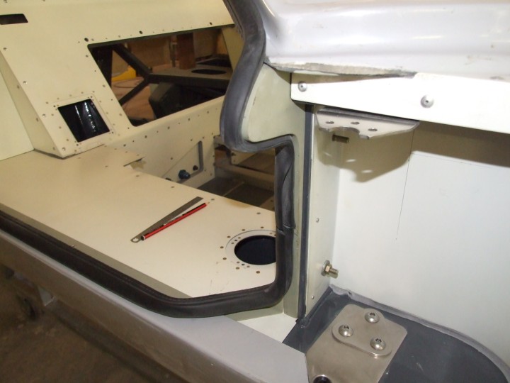

http://www.gt40s.com/forum/gt40-build-logs/16127-roaring-forties-105-a-14.html
Picture in post 270.
Its just a folded piece of alloy sheet the seal pushes down onto it.
The seal sits up against the inside of the door.
As the seal curves inward towards the front ,on the underside of the door is a curved angle panel that makes contact with the seal as the door closes.
Sealer is applied under the panel when fitted to stop water coming underneath it .
The other thing that helped was a rubber flap that lives in front of the door hinge area its only 2mm thick maybe, it stops a lot of water coming off the front tyre getting down in the hinge area.
post 253 in the link you can see the flap in front of the door.
It made a big difference as the water coming of the wheel overpowers the door seals.

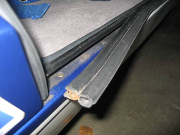

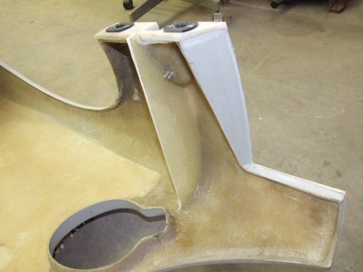

Not a GTD, but this is what I did on my RF.
Sill strip same as Jim's with a double angle to hide the edge of the fibreglass.
Under the A pillar, a plate that sandwiches between the dash mount and chassis and follows the contour of the inner door skin.
The front clip has a glassed in panel that not only helps with water been pumped into the hinge area, but it strengthens up the edges a lot.
You'll need to refit the doors to get a perfect seal edge.
cheers
Clayton

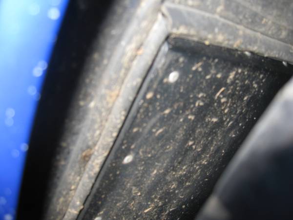

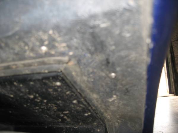

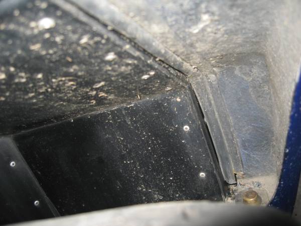

Here are some shots of what I did.
I found that fitting a panel to the inside of the clip with sealing against the tub keeps most of the water spray from the wheels reaching the door seals gives the door seals a chance
