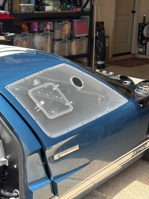

Have a SPF, when out in sun the door windows cloud and fog. Not from condensation but appears to be internal to the plastic, chemical breakdown I would think. Once in shade clears up. Any other SPF owners experience this? Besides replacing any remedies?

Personally, I think they got a bad run of plexiglass but Superformance doesn't seem very keen on that theory.....
I know it will never be as clear as actual glass, but the milky cloud in the sunshine really makes the car look......cheap.
Which is something that it most certainly was NOT.
The headlight and fog light covers are also subject to this, but to a lessor extent.
Out of the direct sunlight / heat it isn't an issue at all. Also notice the helicopter vent added to the window doesn't have any trouble staying clear in the sunlight / heat.
I see what you are referring too now, that definitely isn't from external crazing or superfine scratches I am used to seeing on poly panels.
That is definitely poor quality spec material.
Yea, yours is pretty bad, mine not far behind. Wonder if we would get any satisfaction out of SPF?
I'm planning to re-visit my complaint to Superformance, you might want to reach out to them as well.
