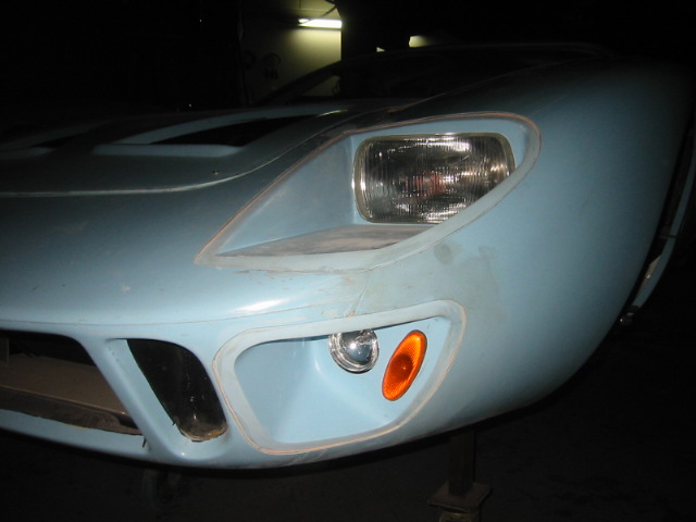

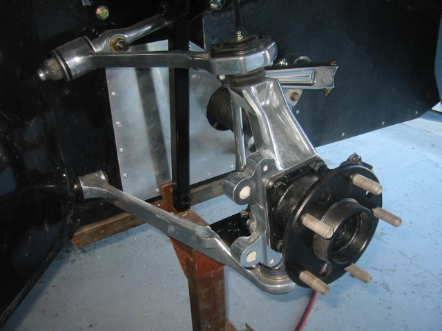

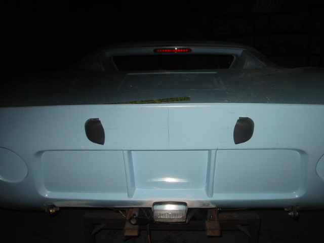

Well,after a brief hiatus,have now got to get No72 through the registration process before years end or will have to fit a 5.4l(no more windsors allowed in Qld next year).
This will mean it will get registered in gelcoat with minimum allowable interior and afterwards painted and upholstery finished off.
Peter and the guys have started installing the suspension etc and we are accumulating the last remaining parts so will be head down and arse up for the next four months.

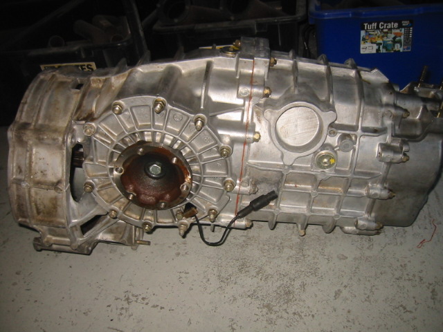

Hey Hoppy
We had to do the same and go over the pits in gelcoat as WA was changing engine laws and the race is on to get 2 cars licensed by the end of the year. So if we can do 2, DRB should do yours standing on it's head.
hoppy
The 5.0 engine,for registration purposes,and a G50(thanks Pete,will be bearing gifts in October when we meet-xxxx heavy or gold?).

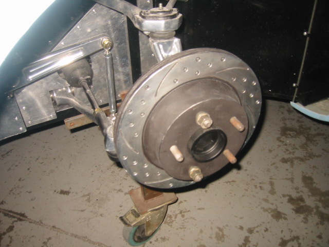

Can't believe the progress.Rotors,lights and electrics almost finished.Starting dash this week.Blitzin'

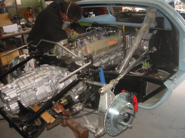

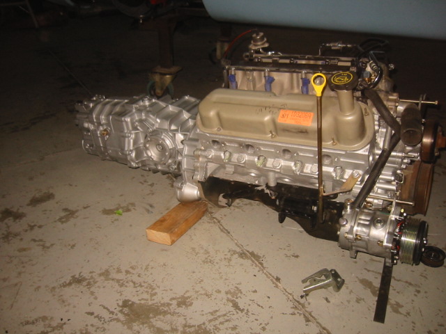

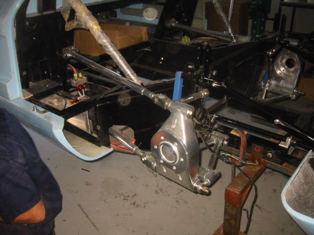

hoppy

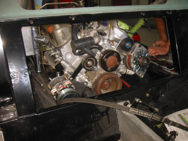

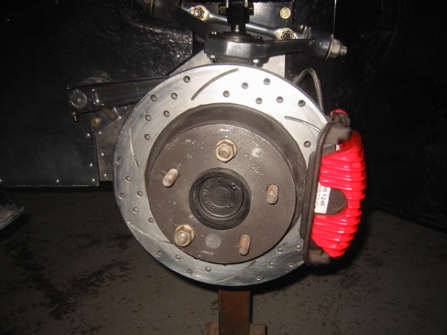

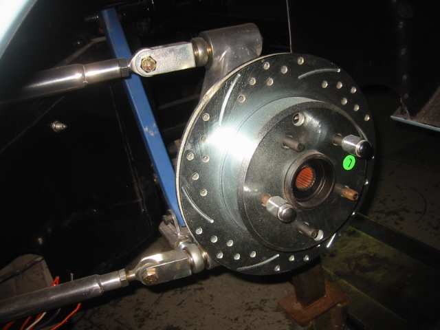

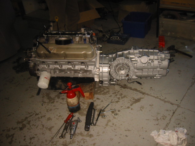

Well the "registration" engine and gearbox are almost ready to be installed,brakes are done and a cluster of guages,or is it a gaggle?

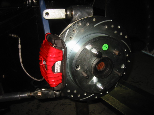

The discs are aftermarket standard size 'vette rotors(11 in) that I got on ebay out of the States,quite reasonably priced too.
Calipers are standard,just been sandblasted and painted.

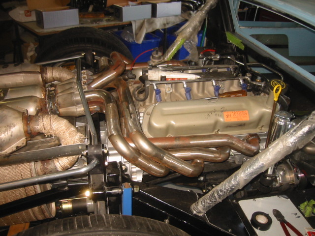

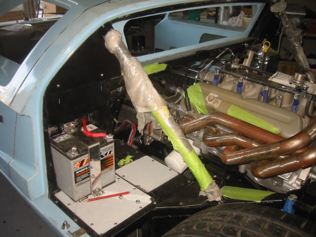

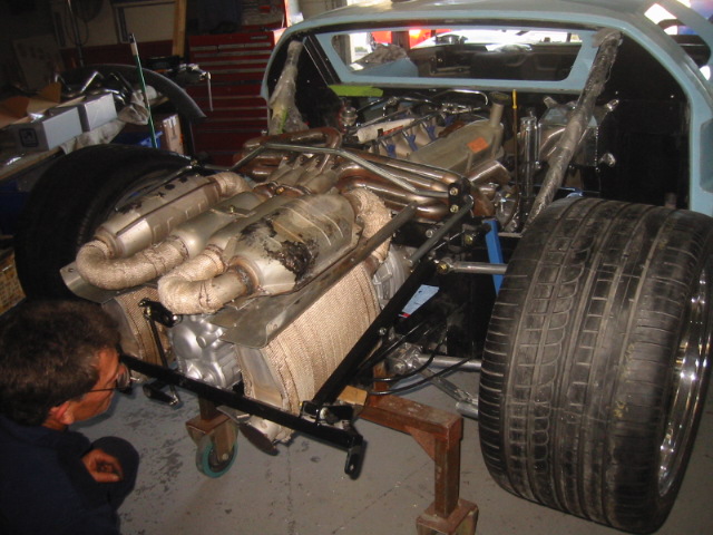

Almost ready to make some noise(somewhat subdued for now).
