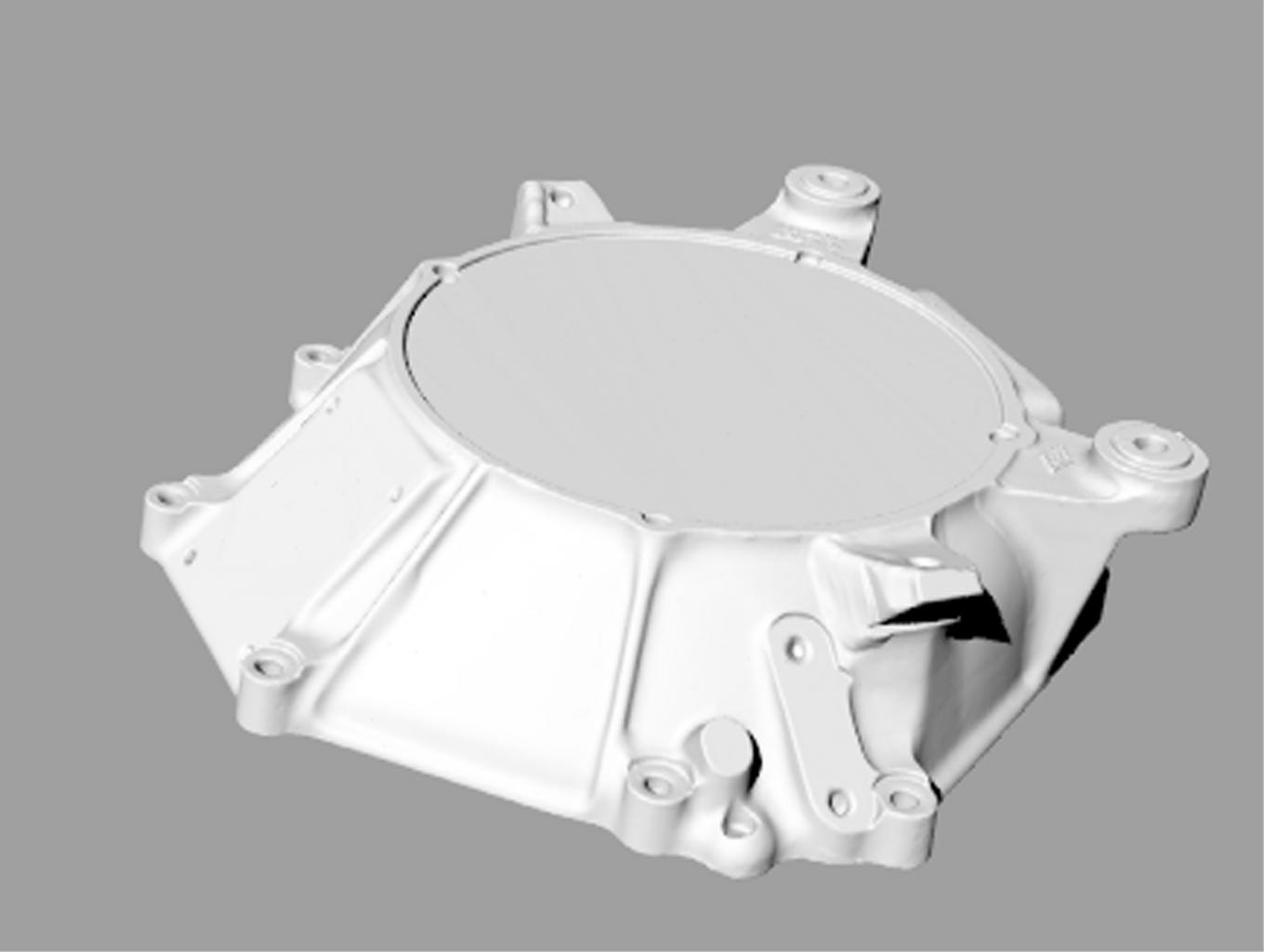

Dougs car is a Lotus 47 with an early 'O' ZF. Other pics of engine/trans assy's similar to his show a wet sump that suggests a 'nose up' engine installation angle ( Lotus 30 pics ), also IIRC the flywheel dia will be similar to early GT40 cars ( Smaller than 289 OE ), therefore I wonder if simply raising the front of the engine would alleviate his bell housing height concerns.
I've got an Aviaid dry sump pan 5-1/25" deep, and the flywheel is 160 teeth, about 11-3/4" dia. , so the bottom of the chassis tubes, the pan, and the flywheel are all essentially at the same level, with the bellhousing an inch or so lower. I'll post a sketch tomorrow that makes that a bit clearer. The scan of the bellhousing gives an idea of its configuration.
