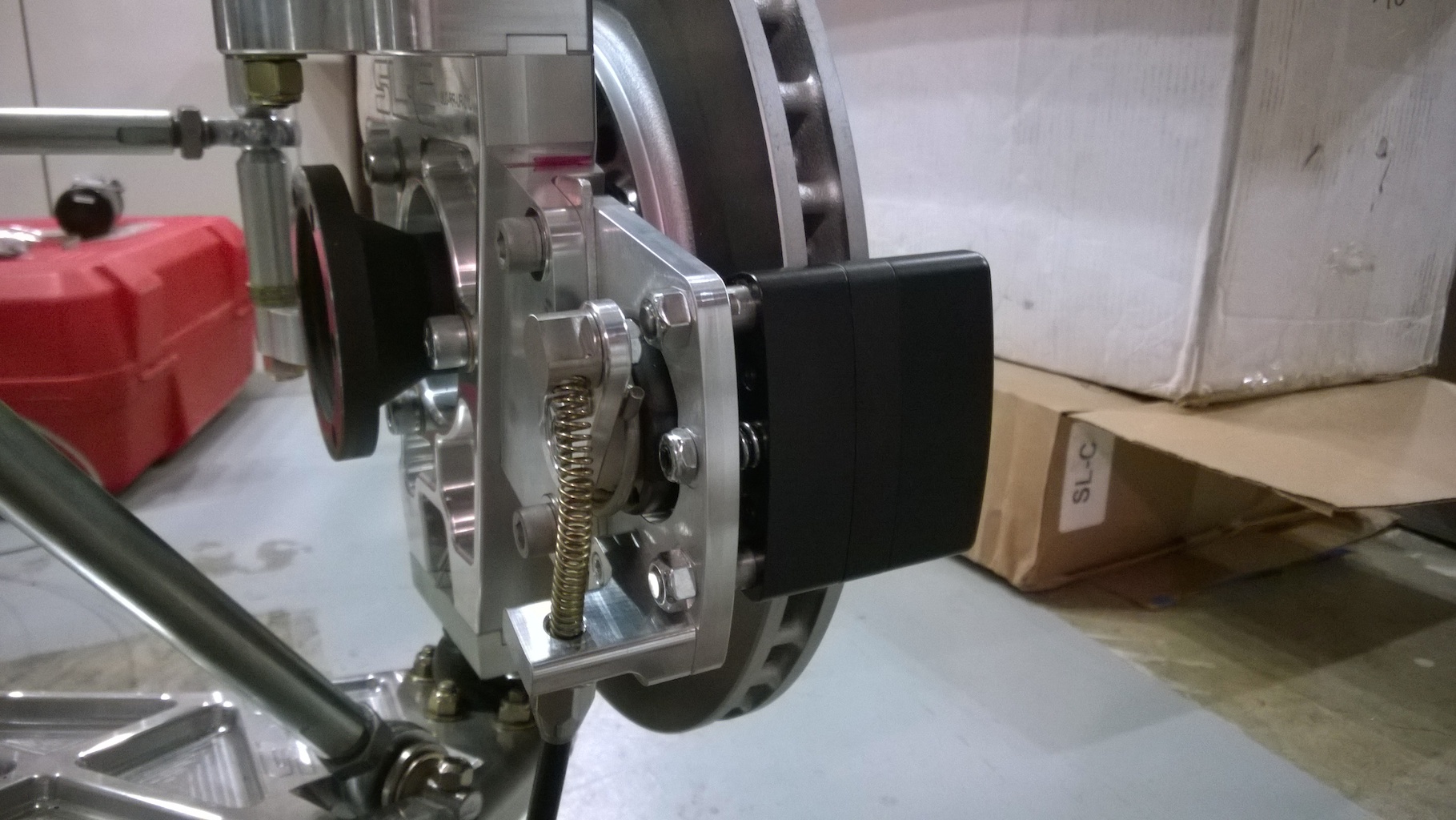

The calipers, caliper brackets, handle, handle mount brackets, are exactly what I have for the Brembo brakes (mine was delivered in April 2014, so it's possible there have been some updates since then).

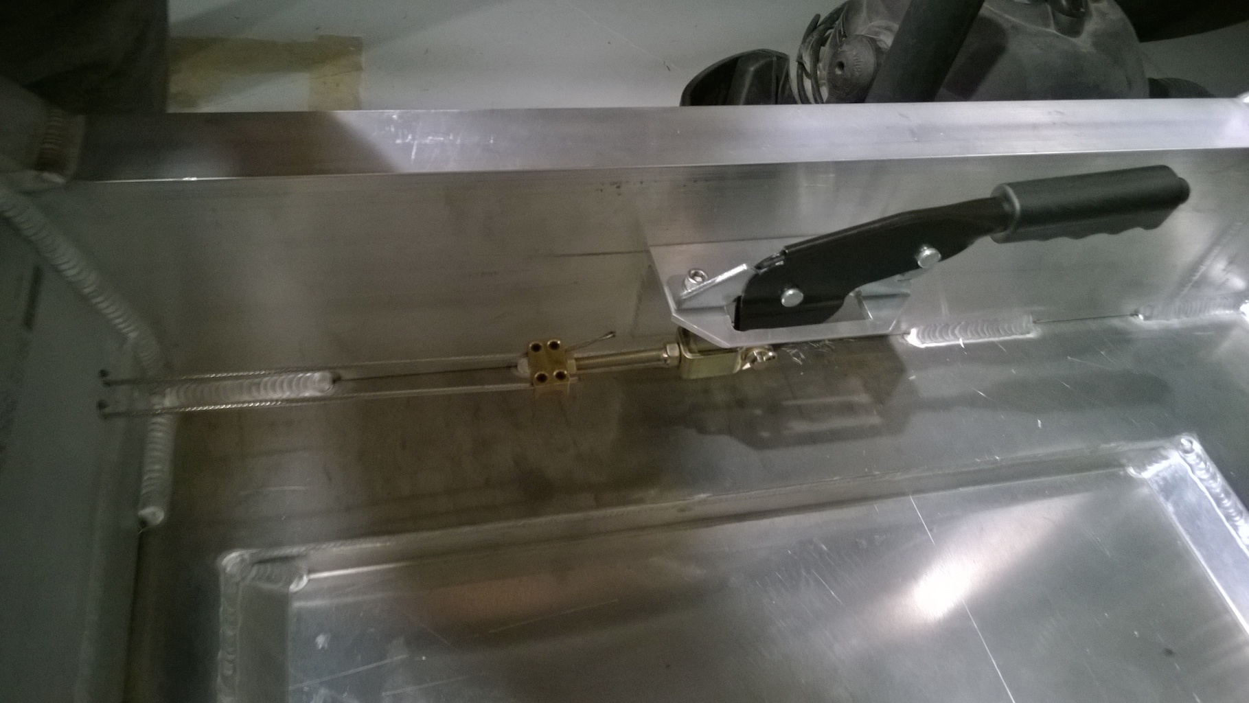

I can't tell from the pic, but there's also supposed to be a cable adaptor that connects the two cables to the handle. None of the other brackets in your pic look familiar, though.
Your cables are also different than the ones I have. Mine are straight with no 90-degree guide.
Here are a couple pics (I didn't use the factory handle bracket; I made one to mount on the left side of the seat instead)
