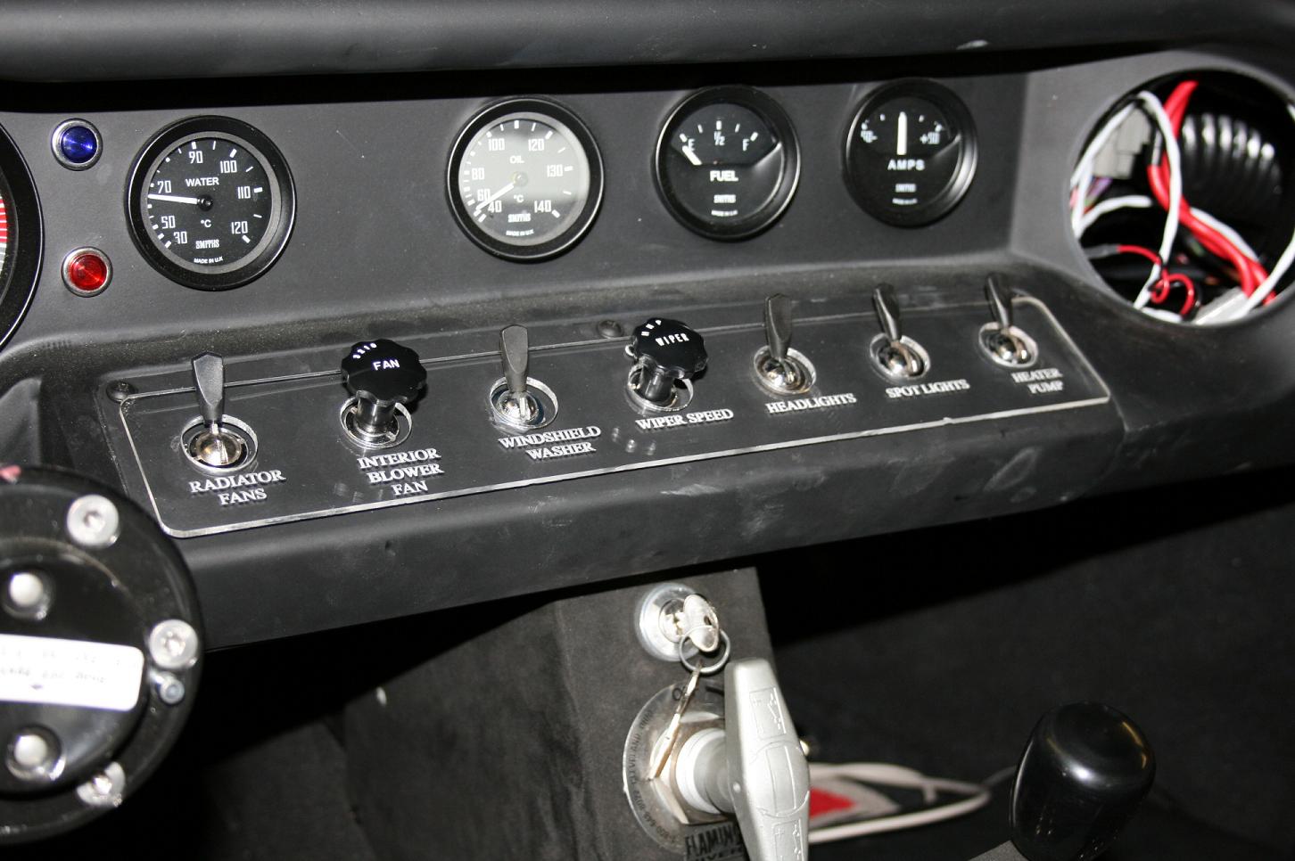

I have the main cut off also but still the roll over switch is a good idea.
