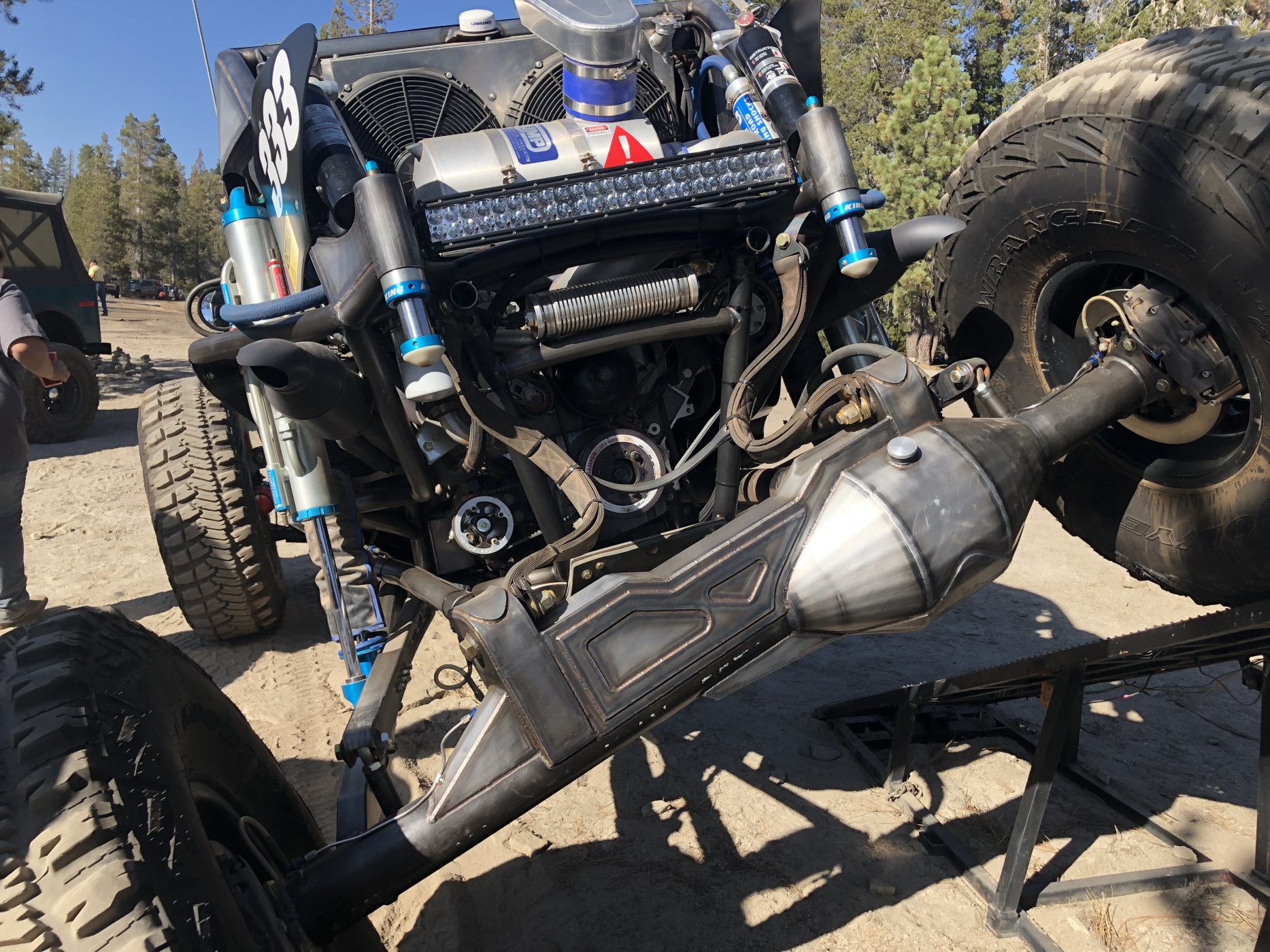

In the world of rockcrawlers/rock racing (only world i know) overheating is a constant thorn. Ultra 4 race cars (rock racers) have powerful v8s (mine is underpowered by current standards at 500hp) that find themselves working really hard in a car that is often moving really slow. Motors and trannies (torque converters) are making tons of heat and there is no wind to take it away. there is rarely much of a fan shroud as the engine bay is open. in my case the motor is in back and the radiator is behind my head-no shrouding at all.
The problem is solved by using big radiators with big fans. the radiator on my racer is twice the size of the ones in the superlight. right behind both of the seats is a tranny radiator with an electric fan. I have a 210 amp alternator. As long as the fans are running the heat is directed away from the seats. if the tranny fans die the seats will fry.
I really cant see how the little radiator in the superlight cools these cars
