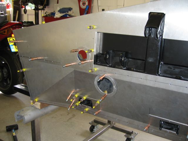

Looks to work ok in the video. It makes the whole tool long as against a normal hang rivet tool, I am just thinking you will need both to get into the tight spots. ps Dont forget to get some avdels or cleco's to hold things in place while fitting, cutting and measuring.
Will you be sealing the panels to the frame at all? On my build I sikoflexed most panels. I would still consider a compressor as they are so handy that way an air rivet gun and air mastic gun can be used.

Hi Martin
ohh, those Cleco's look very good. Do you know what size I would need to use?
The panels for my build will be sealed using Polyurethane sealant before riveting. Also I am planning on using the Tornado recommended rivets which are aluminium pop rivets. I've heard a few people saying they use stainless steel rivets. Do you know what the benefit of using stainless rivots? Is it to avoid corrosion?

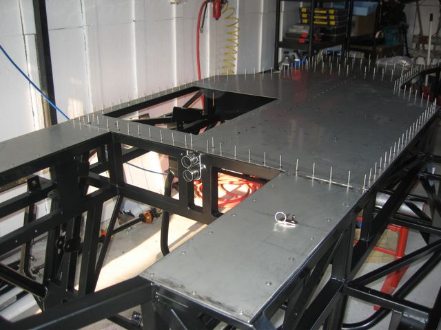

I used 3mm rivets on my build so 1/8th avdels/cleco's and 3.2mm drills. Some people use 4mm rivets. I am not sure what size Andy reccomends, personal choice as much as anything.
I used stainless rivets for the floor as its a stainless unit, these were self sealing. I am not sure of the water tightness though.
Regards Martin.
